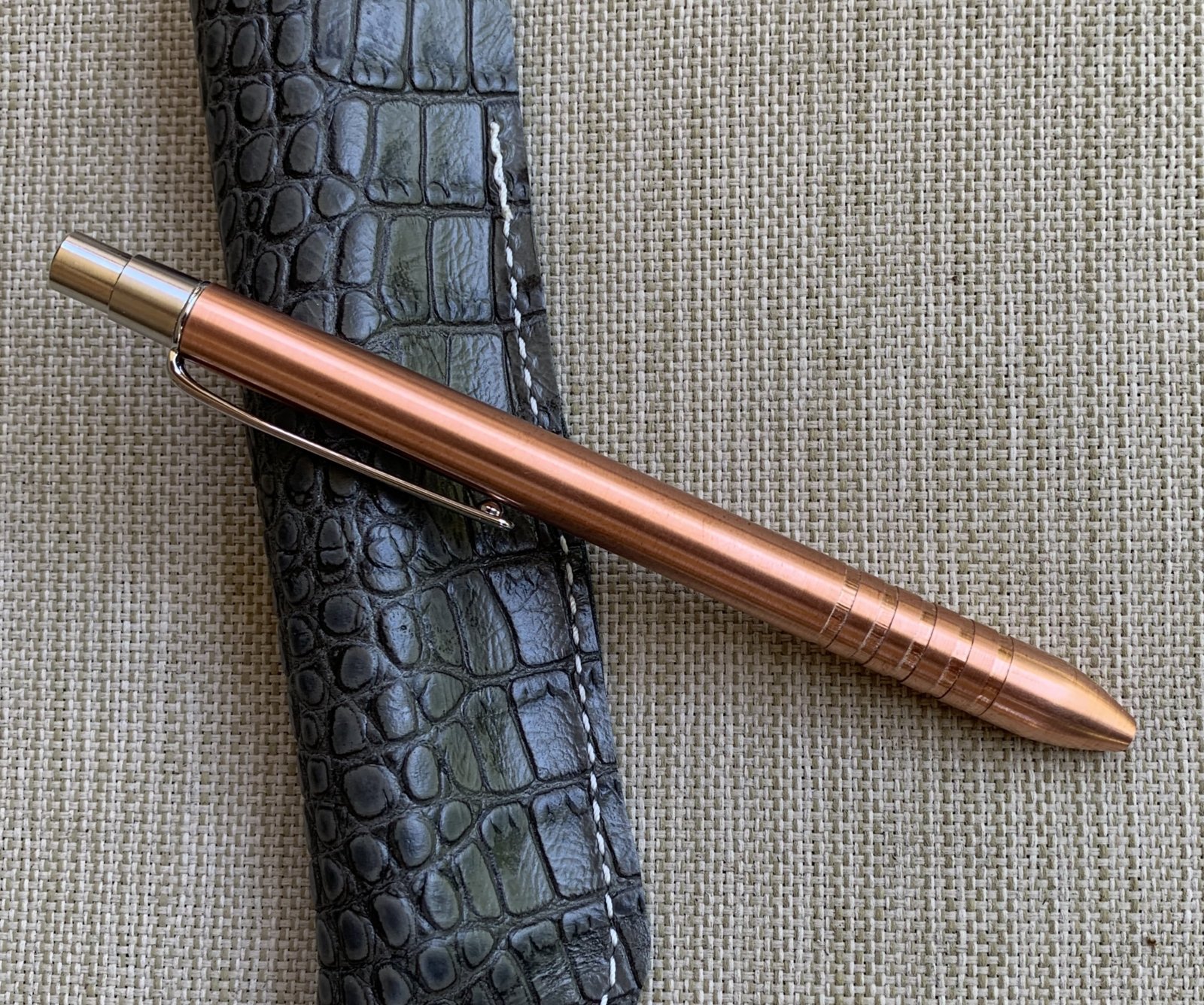

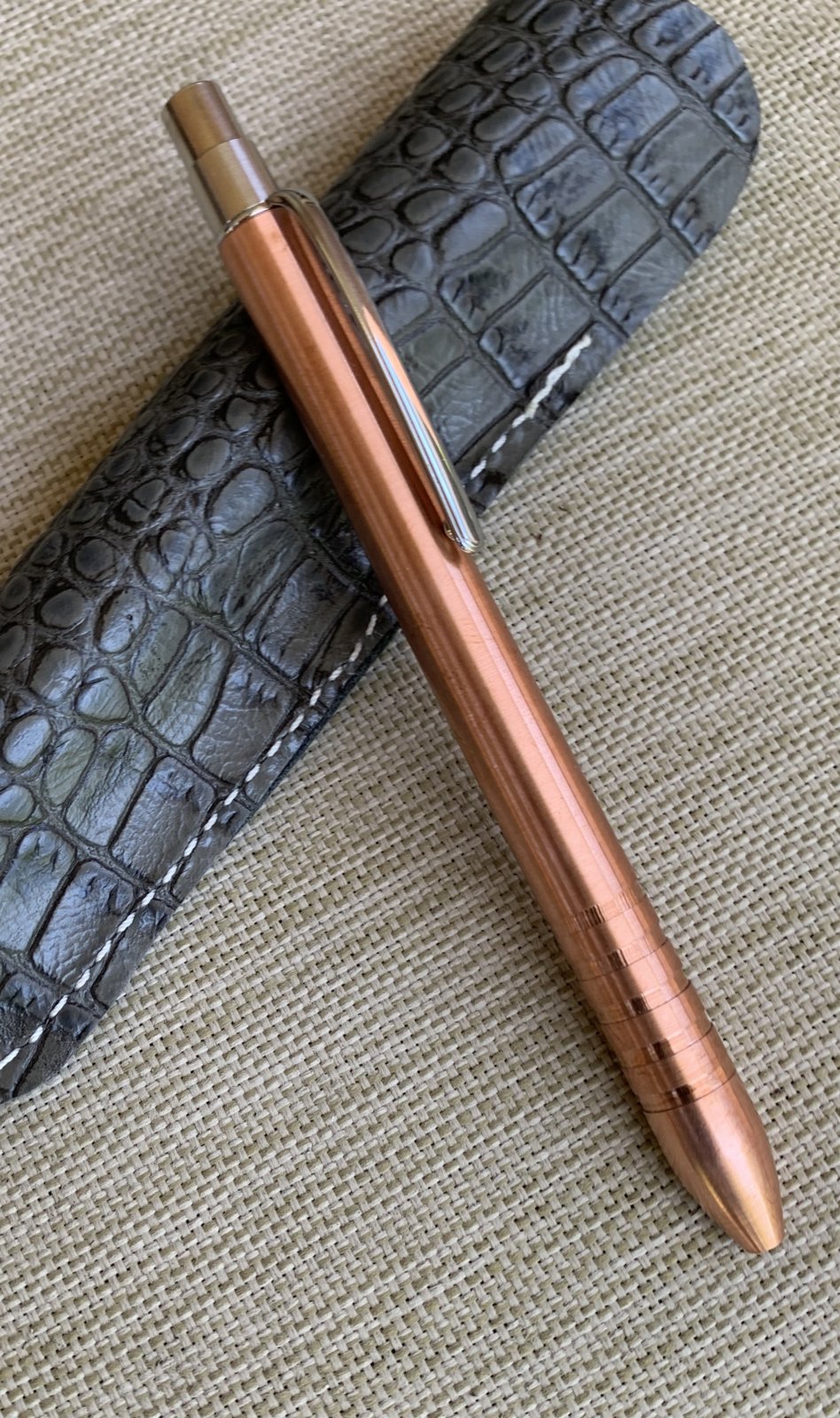

My first test of a new pen I'm working out in the shop this week. The body is C145 Tellurium Copper, a fancy way of saying free turning copper. It's not as "sticky" As normal C110 copper rod. In making a threaded cone designed to use a Pilot G2 ink cartridge, it ended up being Too large and front end heavy. The body tapers from the clicker to the nib, smaller on the clickerend. The next one will be more traditional in shape tapering to both ends. This will make it lighter and more symmetrical. It will require that the nose cone be fixed and soldered In place. The mechanism is a Schmidt SKM88. My plan is to do a detailed write up with the next design, assuming it works. I also plan to electroplate the clip and SKM88 with copper. Hope you like it.

You say it tapers ? .... "smaller on the clickerend" ... ? ... But it looks pretty well straight-sided to me, until you get to the nosecone.

How do you access the refill to change it ?

I like the contrast too but there is occasionally a method to my madness. I'm making a pen for a friends wife who is working as an ICU nurse. Copper is about the best material at reducing the life of germs, bacteria, and viruses. Every little bit helps I guess.

The clicker unthreads from the top and on this one the nose cone is also threaded.

what size threads did you use on the nib?

The threads for the nib are M9 x 0.75. I like the idea of going darker on the clip to give some contrast. Now to find my sulfur of liver to patina the copper, it's somewhere in the garage.
