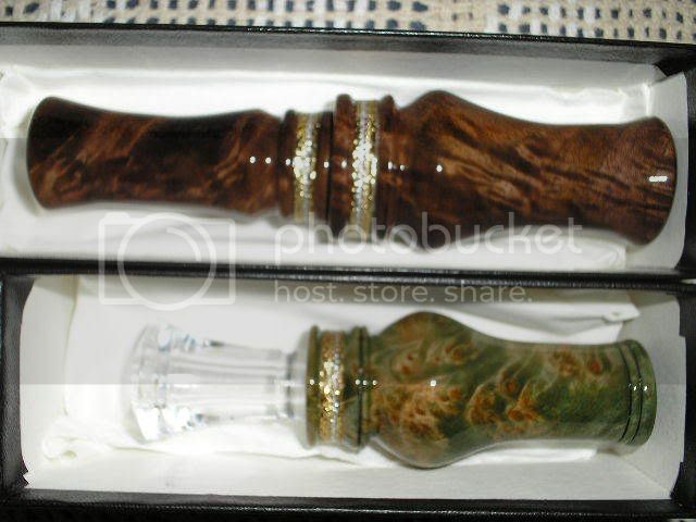

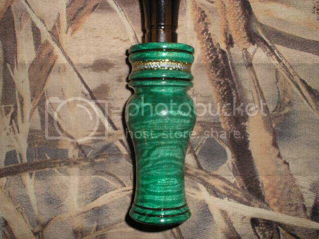

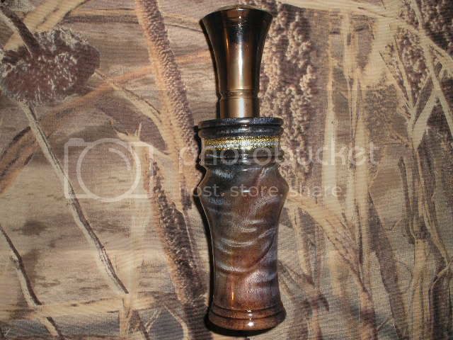

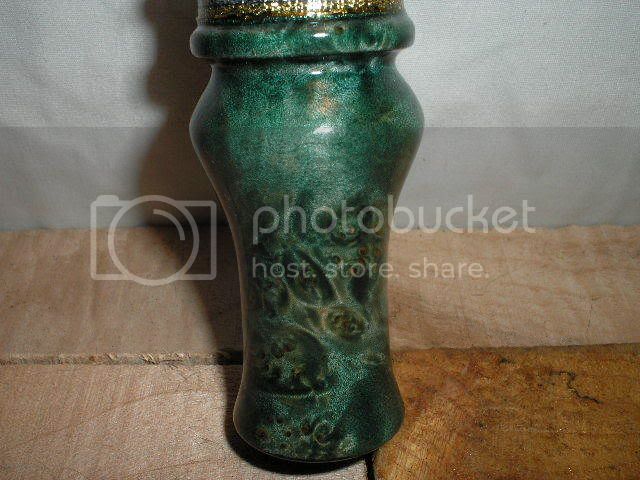

:)hello fella's i quess it was just a matter of time before i wanted to learn about the (material's) to cast swirl color's for call making. what's better than the other.brittle soft an so on an find creative guy's that cast.an would sell me call blank's.an no better place to start then asking the expert's..i got interested in stabilizing my own wood.so though trail an error an yrs of perfecting my process.
this is what i came up with
two toned.
alot of guy's were telling me it could'nt be done with reg mean's,
but i was never to be known as a quitter.
hope you enjoy the pic's,
an i'm looking forward to picing your brain's an talking with you.
see-ya
fella's
steve

it's min-wax woodhardner,acrylic dissoved in acetone,mixed equal part's an leather dye.
in a pressure tank at 85 psi than put it in my mason jar set-up's were i pump a vac at 25 from a hand held brake bleeder with dial attached.
i'm not looking for 100 percent acylic but something that will change the sound properties of the wood an weather proof,the call an make it moisture proof.
i can tell the sound resonace change's from wood to the middle like i do it to a fully a professionally done piece from a company..
it's just a different sound..to me anyhow...
