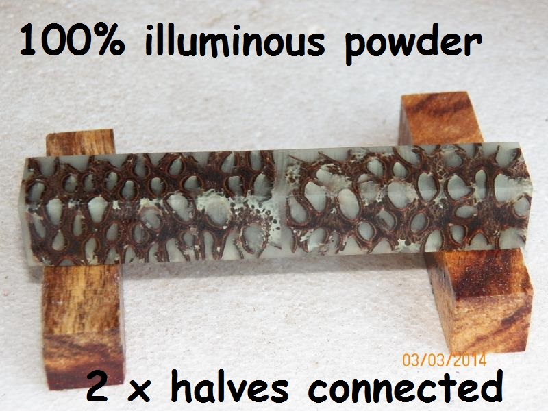

I have never used this fine powder, very heavy with a slight yellow(ish) colour.
Expensive as hell, it came with no instructions or suggestions so, I mixed some on a resin mix container, where I had some yellow Pearlex, I use about 1/3 of whatever the amount I use of the Pearlex yellow, mixed it all very well and pour on a double stack mold with these half pods, aligned up as if they were a single blank.

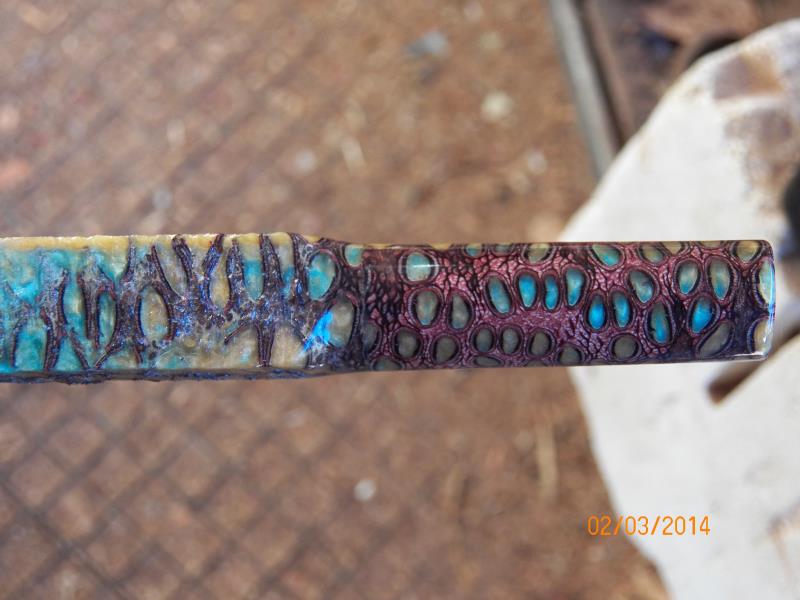

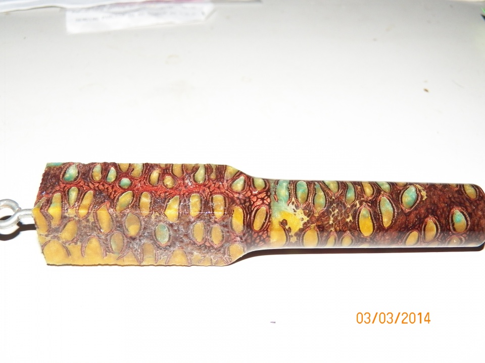

I had another 2 molds with some other colours and in the morning when I got the molds out of the pressure pot, I was excited to find out if the mold with the illuminous powder blanks would glow in the dark or not.
When I removed the blanks from the mold, I could see a "strange" green colours mixed with the yellow but, was patchy within the blanks so, after a few hours in the sun, I turned/sample one to have a look, with the CA finish on it. By then, was almost dark so I keep looking at it and I could see any glow but, when I went to turn the bandsaw light of, as soon as I did, I could see all these bits of resin glowing, all around the bandsaw table, those were the thin trimmings from cutting the blanks to size on the bandsaw however, looking at the blanks, everything was dark so I though that, the yellow Pearlex powder may have cut the illuminous powder capability to show.
At that point I though that, I may require to use the straight illuminous powder on the clear resin and figure out what natural colour this stuff comes up to, when is mixed as I believe the green(ish) I could see of the blanks, was the reaction of mixing it with the yellow powder.

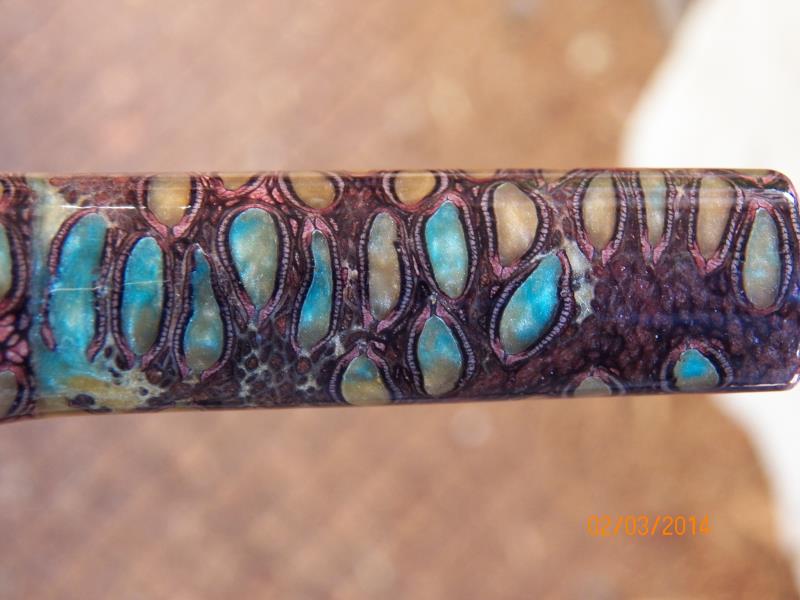

I need to find out so yesterday I prepared some more pods and made another 4 molds, 2 of which had only the straight illuminous powder with the clear resin, how much did I use of it..? well, the bottle is small and comes 2/3 empty so, there is not a lot of powder for $20.00 so, I used about 3/4 of what I had left, add the catalyst and proceed to stir and stir and stir, the glass jar I was using is clear glass and I could see most of the illuminous powder set at the jar bottom and it didn't seem that would dissolve any more so, I got my paint mixer head, put in an a drill and gave it a hell of a spin but, some of that stuff was stuck on the bottom and didn't want to dissolve so I cut my losses and poured the mix over the 2 molds.
I had also another 2 molds with 2 other colours as I'm attempting do make a large batch to finish with the resin drum I have, I will have then, lots of blanks made to last me a long time, well, that's the plan, anyway...!:smile:

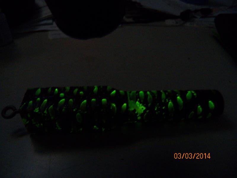

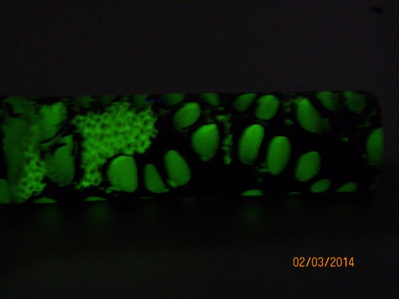

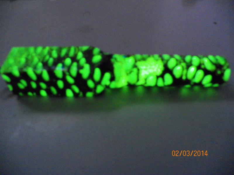

I turned/sample 1 blank of these 2 molds I poured last night to see it 100% illuminous powder, there is, a quantity that I don't know if sufficient or not for the 1 litre of resin used. The colour is a semi transparent pearlish white(ish) and I was quite disappointed after I finished as it didn't seem to was glowing at all, it was also dark when I finish it so I turn the light off and I couldn't see a thing, while holding the blanks in my hand.
I come to the house with it, to show to the wife and let her know my second attempt was also a failure in respect to the glowing in the dark issue when, all of a certain, she turned the table light to have a better/closer look, and after she confirmed that she couldn't see any glowing, the turned the light off, and the blank become alive, was then when I remembered that most illuminous materials require a source of light before the glow activate, to strongest the light, the more glow it produces...!

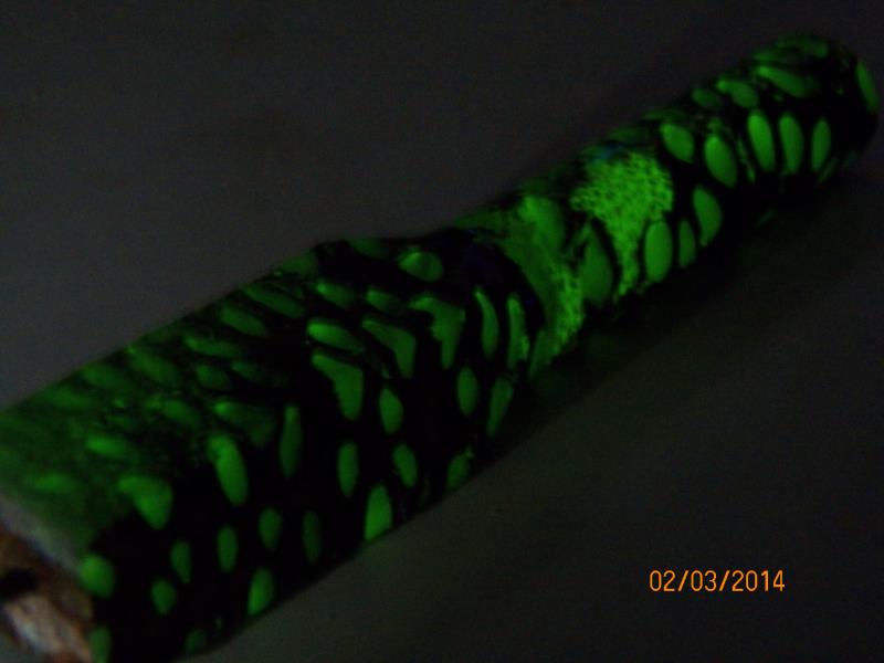

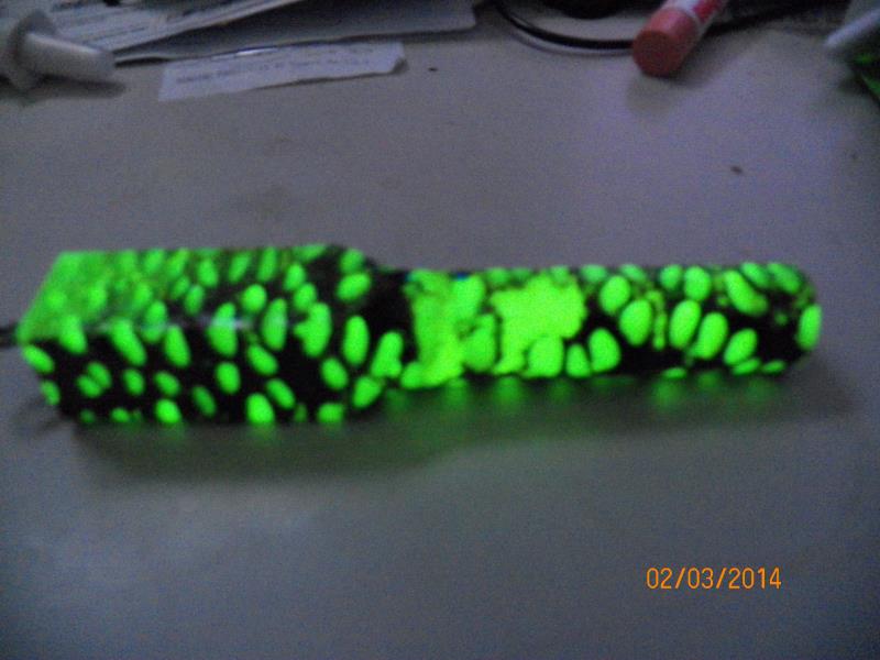

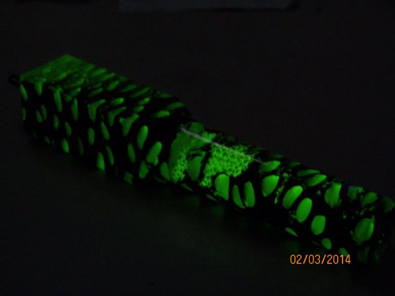

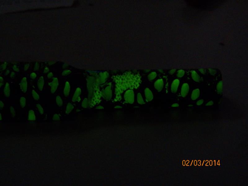

So, I proceed to attempt taking some pics of the glowing, using a strong flash-light and my camera that it took lots of tries before I could find a setting that would see the glow in the dark.
Below, are some examples of what I endup with however, I will need to do the same test with the light on the other blanks I made first, the one above, I reckon, I will be having some glow, I'm not expecting as much as I only used a small percentage of the illuminous powder but, it will be interesting to see if mixing it with another coloured powder, the glow is still present, to a certain degree, will see...!

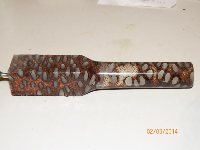

OK peoples, a little more info...!

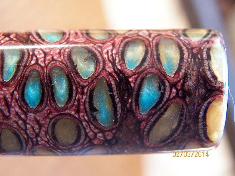

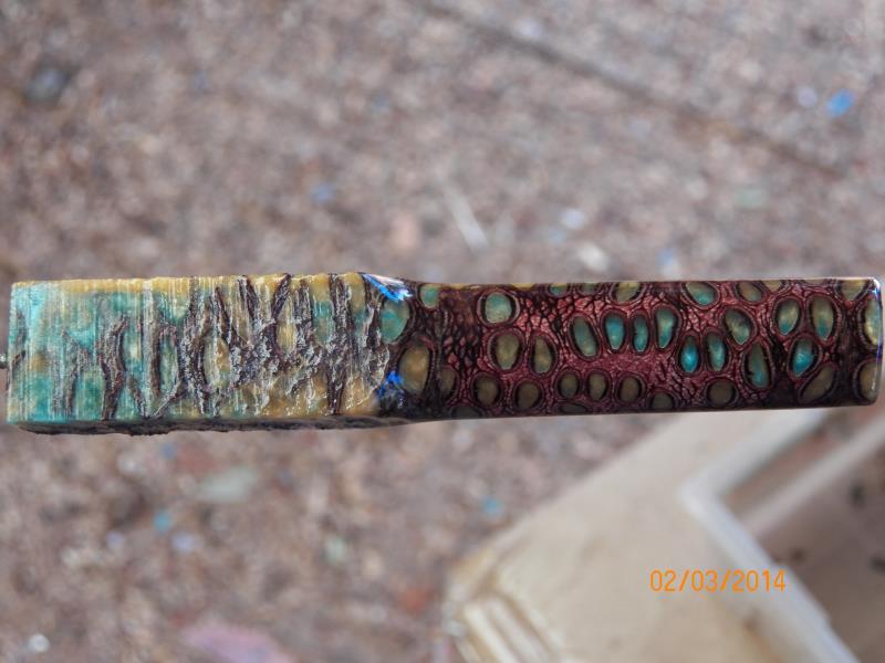

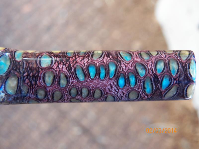

I took some pics of the first glow in the dark blanks I made, the first blanks shown on my opening post, sure they are not as powerful as I only used 25% or less of the illuminous powder but it works, as I though it would, I just needed to get a strong hand torch/light and then take the pic quit fast before the glow would disappear...!

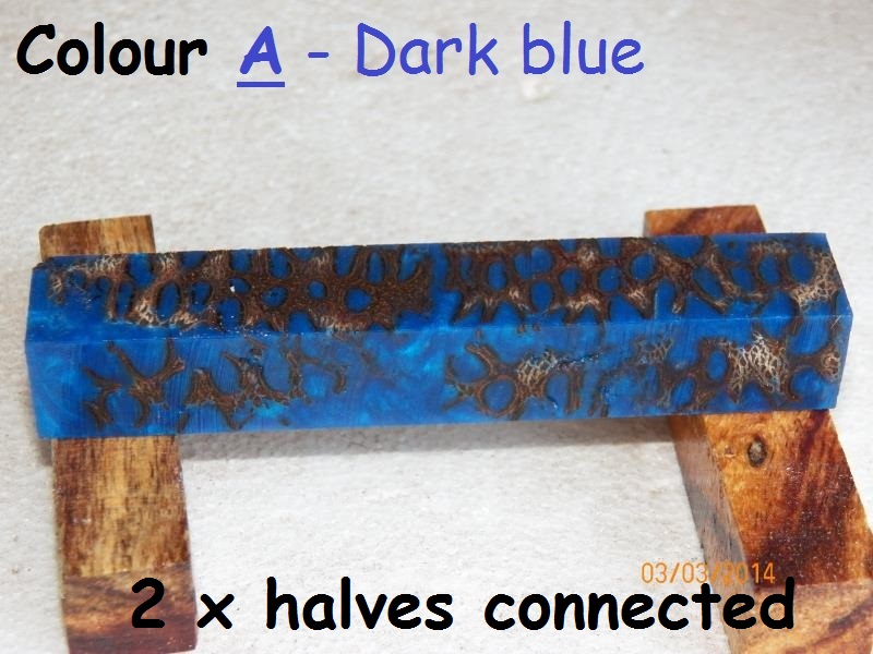

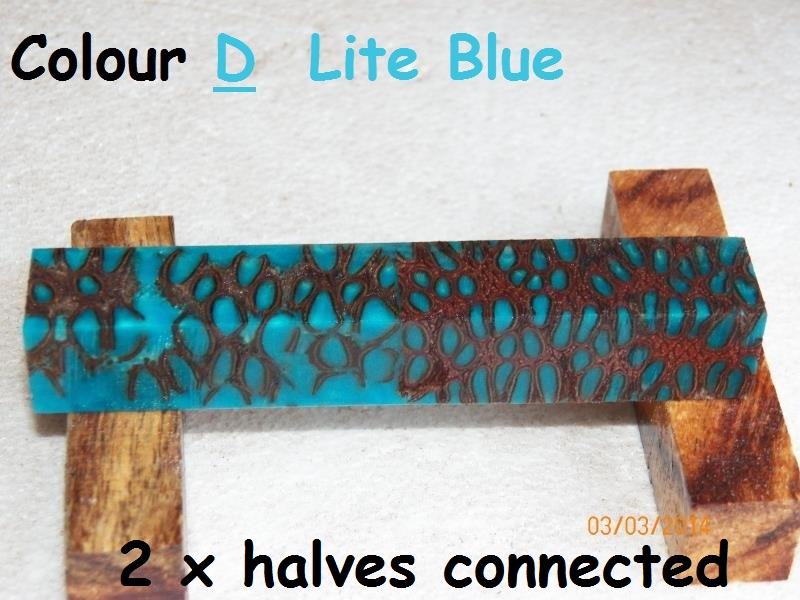

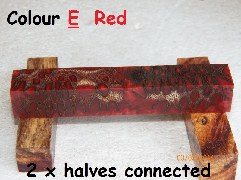

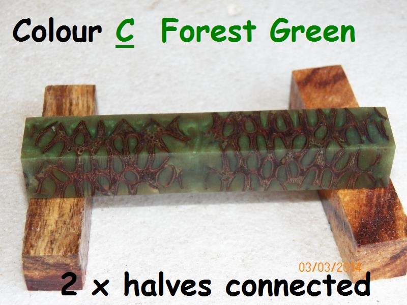

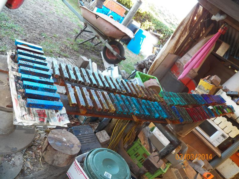

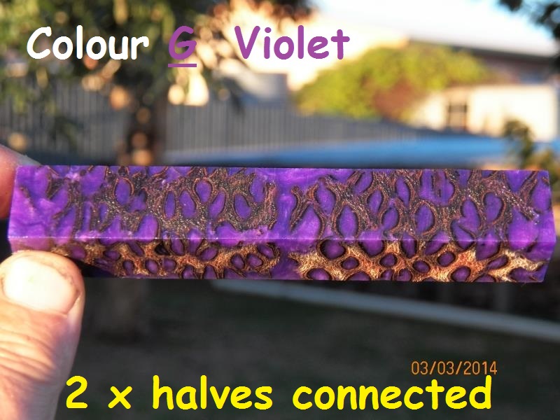

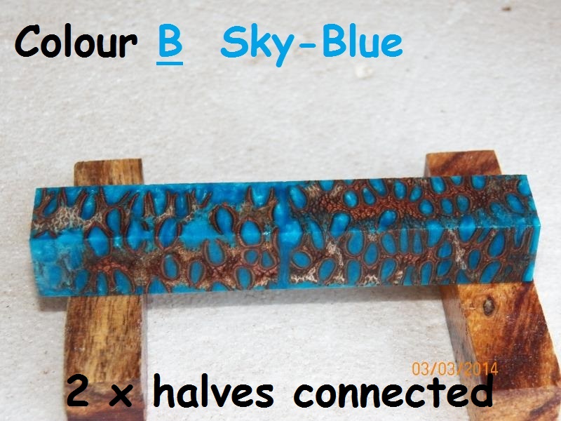

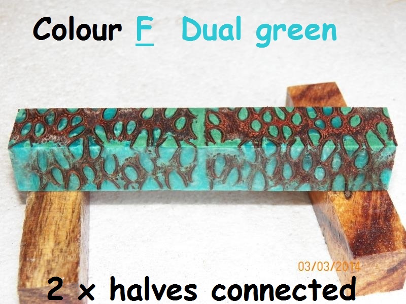

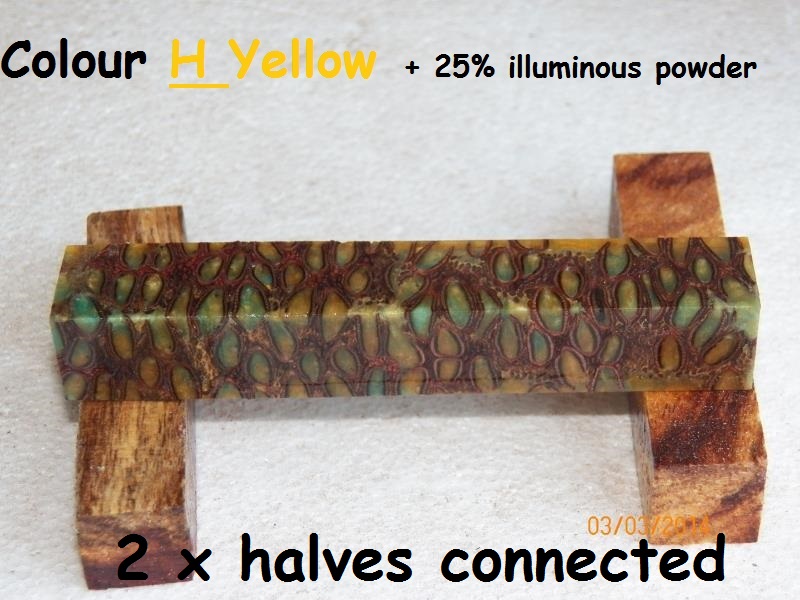

I have also cut the blanks from the molds removed from the pressure pot this morning and in the afternoon I got them all sanded and then sprayed with gloss varnish.
I took some pics of the group/batch after I got it varnished and then attempted to take an individual pic of each colour I made, some colours have only 7 blanks while other have 13.
Anyway, here they are for you to enjoy, I identified each pic/colour with a letter, that is what will identify each colour group...!
Regular colours are AU$8.00 each, 25% glow in the dark is AU$9.00 each and 100% glow in the dark is AU$10.00 each. Keep in mind that, all these blanks in this post are made with 2 small pods as before but, I left them as they were cast, and there is, attached/joined is pairs...! Any full size pods/blanks cast that I make, I will kep them separate from these and you will be clearly notified/informed of what they are, either joined shorts or a full size pod cast...!

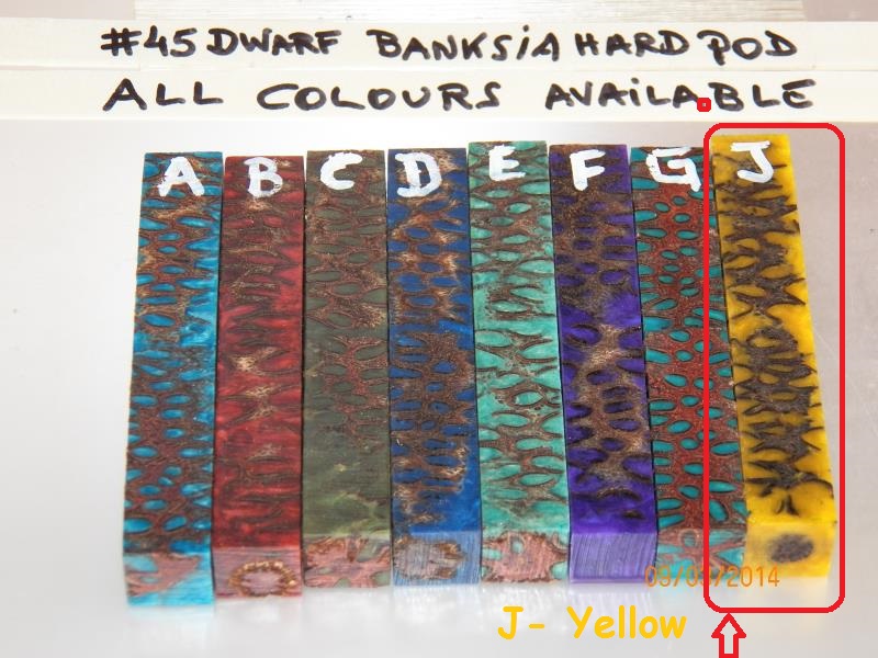

Now on sale, Dwarf Banksia pod pen blanks, various colours, joined 2 halves..!
OK peoples, sorry for the delay, I had a fall last week and I hurt my ribs, nothing broken my, these things hurt like hell and any slight movement it feels that someone in punching knifes on you...!:eek::redface:. I still have a bunch to sand and varnish but, I will get them done very soon, I hope...!
Half of the ones on the last pics, are still available and some more of the most sold colours, are ready to finish so, I'm not going to list them on my eBay store, there are not enough to cover both places and I'm a little down at the moment to work in the workshop so, all I have will be offered here.
So, I will list here, the number of blanks of each colour I have made,(including the ones I need to finish), I don't really want to put restrictions on anything, particularly on the number of blanks from the same colours each person is allowed to order but, I would appreciate if you guys and gals, accept that, everyone would like to have a colour variety and that, I will be making more in the near future, in fact, I'm open to requests/orders to have a specific number of blanks made of a particular colour, that would be a direct order and would be supplied off these general sales, as time permitting.
I still have lost of pods left and a newly found source for years to come so, there is not reason to panic, I will be doing more, and I will be also be collecting longer pods to allow me to make some with a full length single pod pen blank, for sure...!:wink:

- All colours except the 25% and 100% illuminous @ AU$8.00 each (same price as before of AU$4.00 per small/short) but joined this time, (colours A-B-C-D-E-F-G-J)
- The 25% illuminous blanks are AU$9.00 each
- The 100% illuminous blanks are AU$10.00 each
Please, select your colours and quantities and make your order through here (this post) or via PM, information will be sent to you, on how to proceed.
-List of blanks available to be updated as they sell...!
* Colour - A (sky blue) = 4
* Colour - B (Red Russet) = 6
* Colour - C (Forest Green) = 6
* Colour - D (Dark blue) = 6
* Colour - E (Duo green) = 6
* Colour - F (Purple/violet) = 6
* Colour - G (Lite blue) = 6
* Colour - J (Yellow) = 6
* 25% Illuminous blanks = 4
* 100% Illuminous blanks = 0
