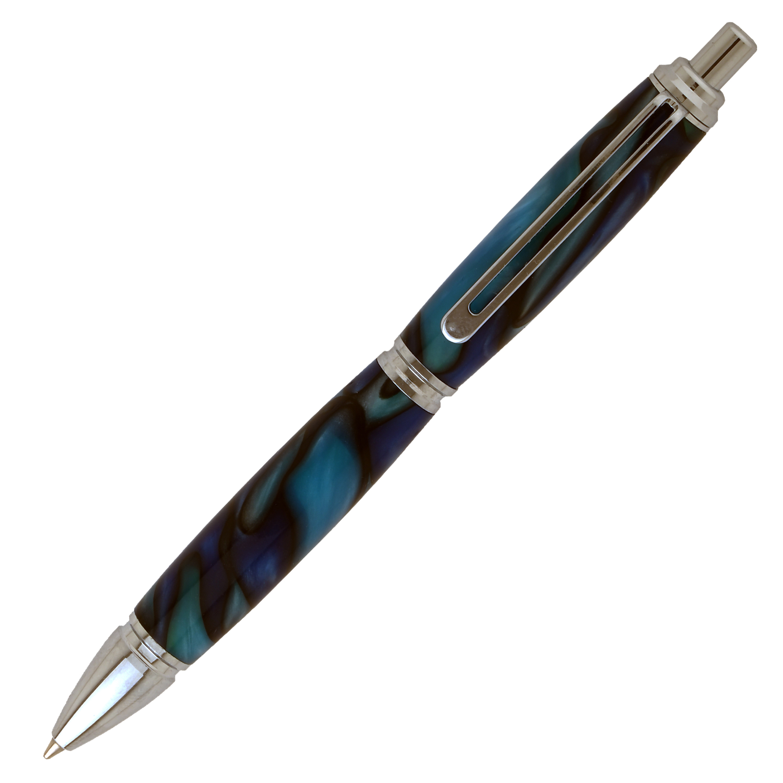

pen state industry now has EDC slimline pro now for sale in, gun metal, gold and chrome. i just order them, if you just get 1, you can use bolt action tec bushings and they have the skm 192 clicking mechanism

I saw these in the new catalog a couple days ago. It's nice to see a different clip on something. I'm guessing you could make a one piece out of them, too.

I seen them and I plan on ordering some. I looked at the instruction sand it appears there is plenty of "meat" to allow segmenting.
The "meat" is not a heckuva lot .... about 1.4 mm.
I get this from the OD of the bushing and the brass tube size .... 0.5 x ( 0.425" - 8 mm ) = 0.5 x ( 0.425 - 0.315 ) = 0.055" = 1.4 mm

I was hoping for a little more. I think it can still be segmented though.
