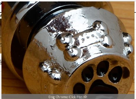

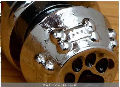

And why would they have picked this image to put on the website?:rolleyes:
I'm assuming that ugly casting divot is not supposed to be there!

I can only imagine that they chose the best for their advertising.
I used to carry items from Wendy's headquarters to their specialty photographer. They would send at least 4 trays of 48 buns, so the best could be chosen, along with similar multiples of the other items.
Surely PSI does something close to that for their photo shoots.

That only shows up on the chrome one. The photos of the brass and gold ones look to be oriented to the same location. We are probably just seeing some bad reflection of light.

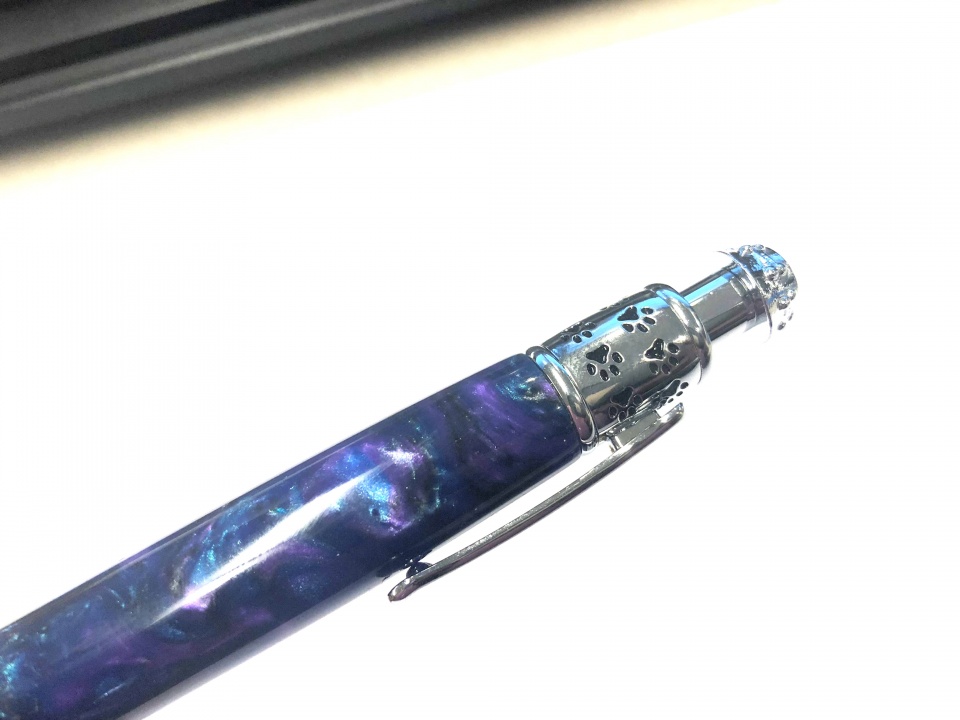

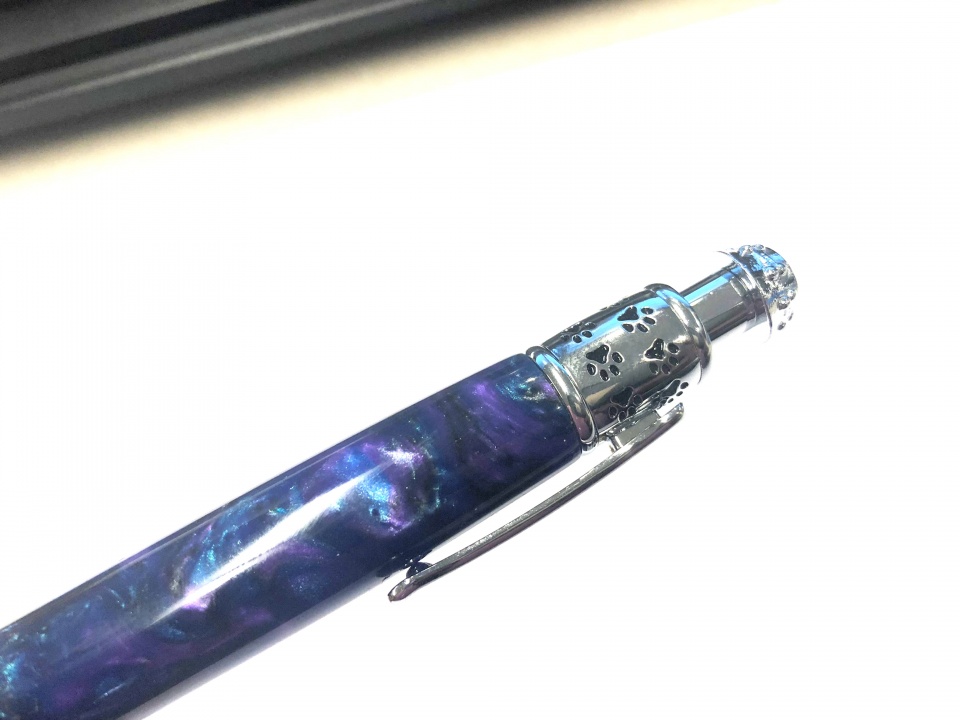

I have made at least 12 of these and have had no clip issues. The clip is tight on mine and doesn't move.
Hmmmm .... both of mine are faulty. . Neither makes contact with the body now unless forced to do so.
The faults occurred immediately the clip was used for the first time. Each clip noticeably "snapped" when it happened.
As I said above, this is not a big deal with me, but I would like to see the issue fixed in some way. . The clips wiggle a little bit up and down.

I just did two of these for my vets. In my photos, both show a "blob" of what looks like glue, in the same spot on each pen. It's a trick of the light and that may be what we're seeing in the photo that you posted.
