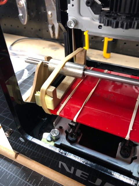

I had the same issue. Are you using the Pace jig? I found that the supplied rubber band was not applying enough tension to turn the mandrel properly. I bet if you apply a little more tension it might improve. I added a little paper under the band at the front and taped a large bushing to give the band more tension. This got the mandrel turning better for me. I'm sure there are better fixes, but this quick one worked to get me going.

I'm not sure what a Pace jig is so I'll have to find that out. Maybe I missed something but is the table supposed to move also because mine doesn't. If that's the case you might have solved the problem for me. I'll have to look into this. Thanks for the info.

Sorry. I think I assumed that you were using it with a rotary jig on a pen. It is called the Bob Pace rotary jig. It is the jig that came with my laser to engrave on pens.

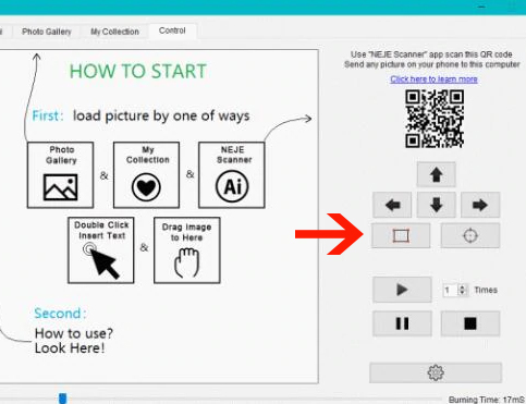

Yes, the red table moves. You want to make sure your piece is attached to the table while engraving. I use a rubber band to hold it in place as you can see in the picture. The table moves in very small increments so it may be tough to see. In the software, you can click the button that looks like a box (image below) and the laser and table will move to outline where your engraving would go. If you do that and nothing moves, something is defective.
