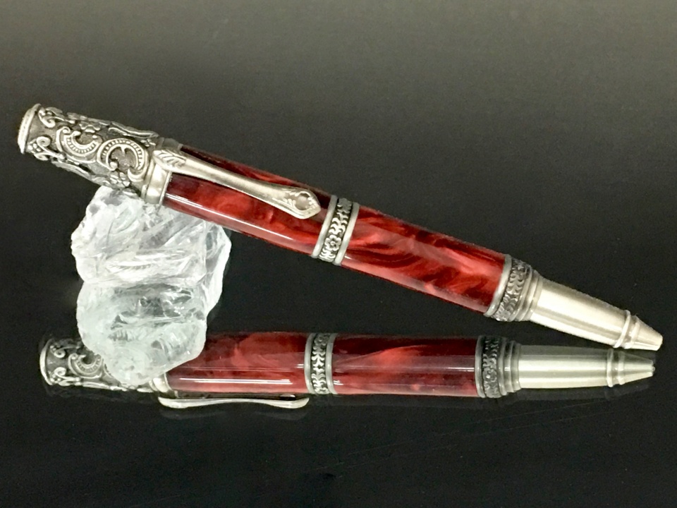

I ended up taking all of your suggestions, plus a call to Ed at Exotic Blanks, with respect to the coupler that the nib screwed onto. At Ed's suggestion, I took a chain saw file and gently twisted from the inside of the blank. A couple of tries and the refill went in and out smoothly and the pen now works! I really appreciate everyone taking the time to share their suggestions. It's members like all of you that make IAP a great forum. Thank you all again.
I'm attaching a photo of the completed pen that now works!! The blank is called Red Velvet.

John, thank you for passing on the chain saw file trick. I did not know about that. . Seems that the Victorian kit has a rather narrow passage for the refill. . I have to go to the store this afternoon so will pick up such a file and be ready for the next time !!
