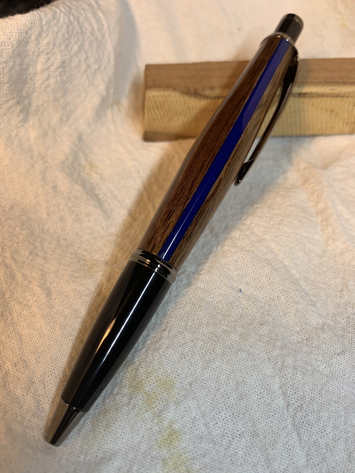

I tried the suggestions posted previously. I scored the acrylic, not too much clamping pressure and so on. Turned the blank entirely with a skew chisel instead of the carbide button. Not entirely happy with the colors but at least I was able to finish one. Still waiting for the T88.
Thanks everyone for the help!

PS - the finished pen turned out awesome.
