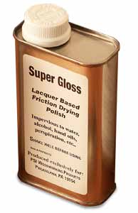

Originally posted by lkorn
<br /> Tom gave me some Mylands Lacquer based friction polish that seems to work very well as opposed to the shellac based stuff.
Larry the stuff I gave you is <b>not</b> Mylands it is the same as this sold by Penn State
http://www.pennstateind.com/Merchant2/merchant.mvc?Screen=PROD&Store_Code=PSI&Product_Code=PKFRICT2&Category_Code=FINISH
It can also be bought directly from Wood Wright Ltd in Hanover, PA
http://www.woodwriteltd.com/turnmagi.htm
