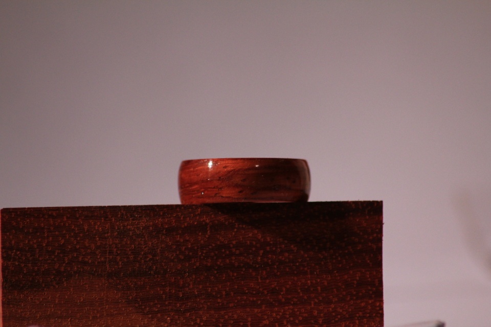

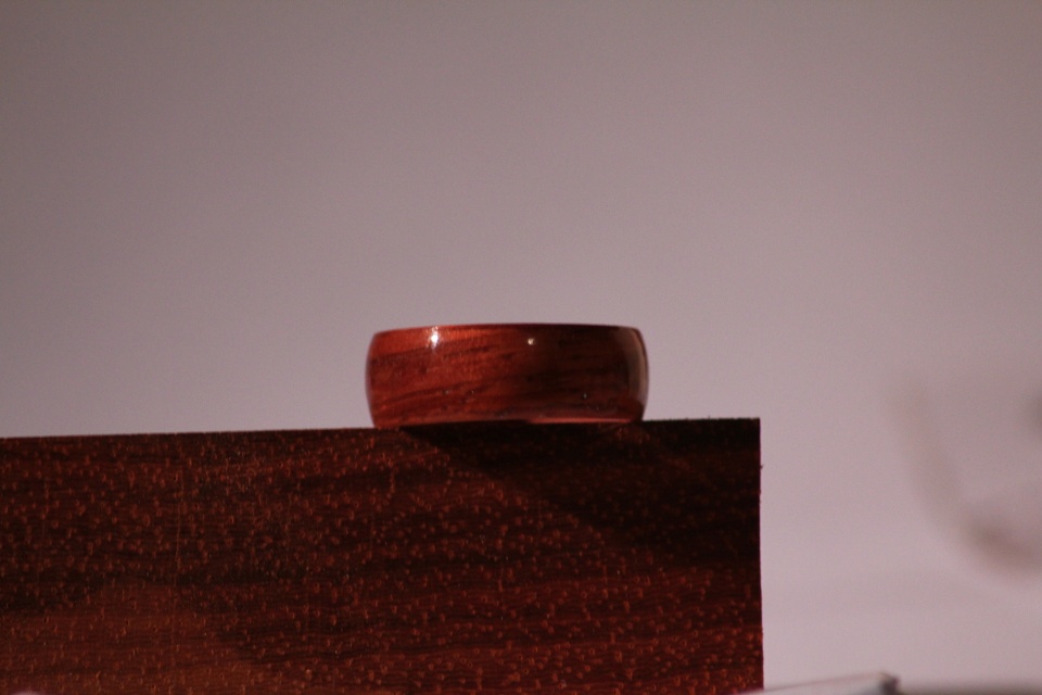

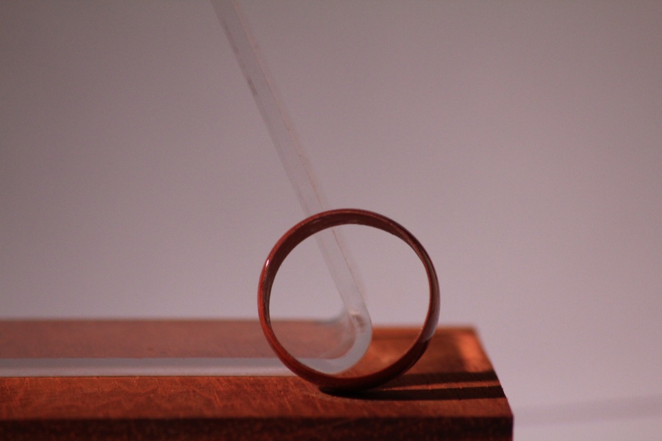

My stupid phone autocorrect I meant bentwood rings. I made this one out of paduk I did cut my own piece of veneer on the table saw but the thickness is not consistant enough and I cannot get it thin enough

Still not following. Is this a piece of flat stock that you thinned down and bent into a ring somehow?? Why not take a piece of wood and drill a hole the size you need and then turn down to whatever diameter you want??? I may not see the whole picture because i do not make rings.
John drilling a hole through solid wood and turning will give you a ring with short grain which for a ring is too week to survive daily wear. A ring made of veneer wrapped around is all long grain and therefore more likely to last. One other possible alternative would be to use a metal ring core like those sold by The Bangle Guy.
Look for Cabinet supply companies for common woods. They should carry edge banding in Maple, oak, Cherry, possibly other woods as well. You can get them with or without glue backing.
I need some very thin veneer that doesn't have a backing. I simply cut a strip that is 1/2" wide and 12" long. Then I boil it bend it around a 3/4" rod and let it dry. Then i wrap it around a dowell and glue it to itself. Then I sand it on the lathe and finish it.
