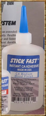

I understand the waiting part. Just still a novice on the whole CA thing. CA is like pen kits- different names for the same thing. When you say put CA the decal are you talking about this stuff (see picture) or is this just for "a CA finish" on barewood?

That's the stuff. Use the thin and apply softly, don't press too hard. If you don't seal the decal with spray lacquer (water based or solvent based) and let that dry for at least an hour or two, you will smear the ink. This is true if you're using an ink jet rather than a laser.
