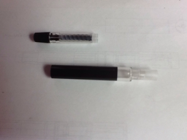

I purchased this piston fill assembly from Richard Greenwald and need some advice on how to make a pen. Do you have any ideas how to use the ink window tube as is? I was thinking about turning a body to fit over it with a set of ports that would go thru the body to the clear window. Or, I could turn down the 0.05" wall thickness a little and slip a body over that.
Also, the web site says that the threaded portion is for a JOWO 6.4x.6 nib. Does anyone know where to get one? Most of the sites I visit don't list that thread size.
I appreciate any comments, you guys are a very talented group.

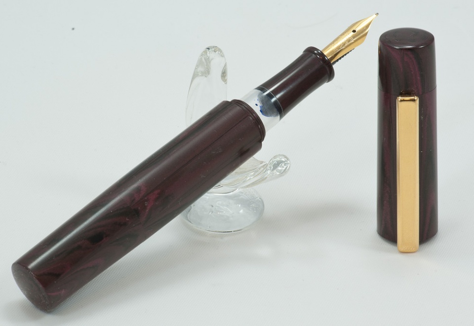

I started building a pen around these parts a while ago, but got distracted and haven't quite managed to find my way back there. "Look, a squirrel!" sort of thing.
Anyway ... I've glued the long tube into a piece of ebonite that comes down the outside to the window. I've glued the narrow part into another piece of ebonite, and will shape that into the nib grip section. I'm going to cut threads for the cap on that piece of ebonite.
The cap: I'm thinking of adding a ring of clear acrylic to the open end, bored out to clear the threads, so that it will still be possible to see the ink window when the cap is on. Not certain how that's going to work out.
The piston actuator: well, I'll work something out. Probably a simple blind cap glued to the twisty bit of the piston.

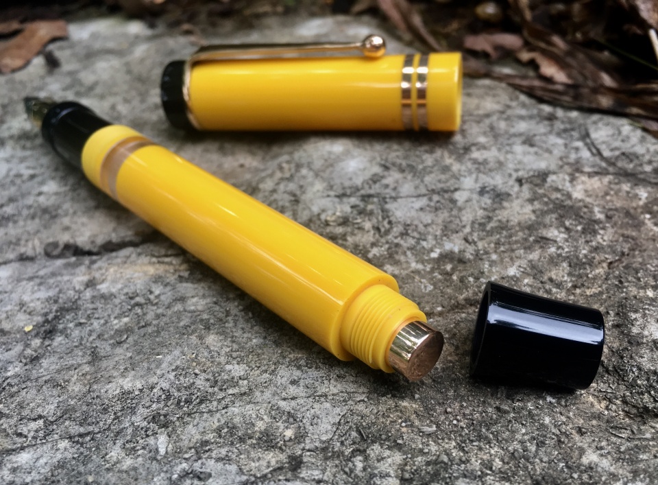

I think you would probably be best off by making a removable blind cap that screws on the back of the barrel to cover the piston knob rather than trying to glue a knob over top of the existing knob. It looks like you're basically going to be skinning an existing pen with another material, cutting cap threads on it, and then making a cap for it. I'm not sure how you're going to hold that on a mandrel though, as it looks like the section doesn't unscrew. I guess you could always make a little short mandrel that screws into the front of the section and use a live center to support the back end of the barrel.

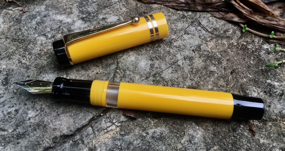

I figured I should probably elaborate on the blind cap idea, as a pic is worth 1000 words. This one is for a button filler pen, but the same concept would be applicable to that piston filler. As you can see, the back end of the pen has threads cut on a smaller diameter tenon, and there is a black cap that screws on it it that covers the button (or knob in your case).

Mike, you most certainly can use it -- in the end, I wimped out on that part of my plan (in the interests of getting the thing finished on New Year's Day instead of spending the next month polishing the inside of the clear acetate :rolleyes:)
I'd love to see if the idea actually works :biggrin:
Here's the one I made, incorporating John's idea of a blind cap that screws off instead of being glued to the piston actuator.
