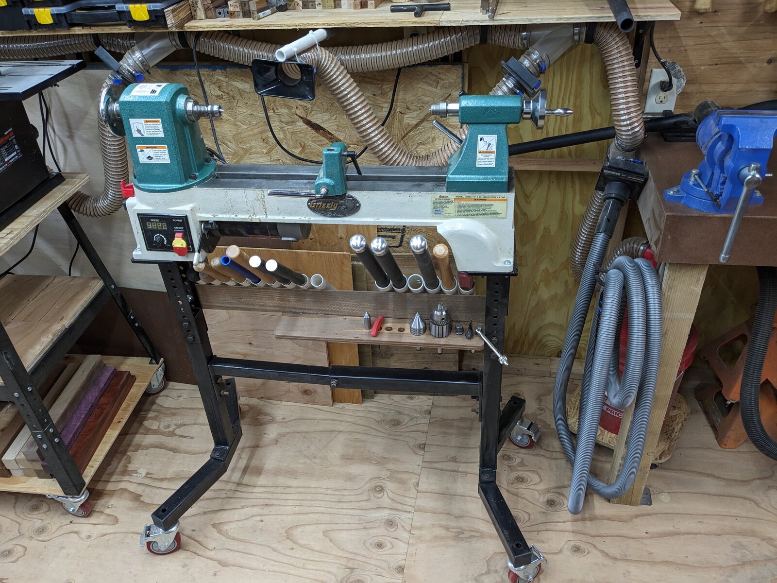

I got this, WEN LA8800 225-Pound Capacity Height Adjustable Steel Lathe Stand https://a.co/d/jdxSzVC. It does all right with my 12" x 20" Grizzly on it. I put locking casters under it to start out but once I started to turn bigger stuff the slop in the casters was an issue so I went back to the feet it came with. I've added a 2x4 under the lathe above the cross bar that's cut on an angle where I attached pvc pipe tool holders and a shelf for MT2 accessories.

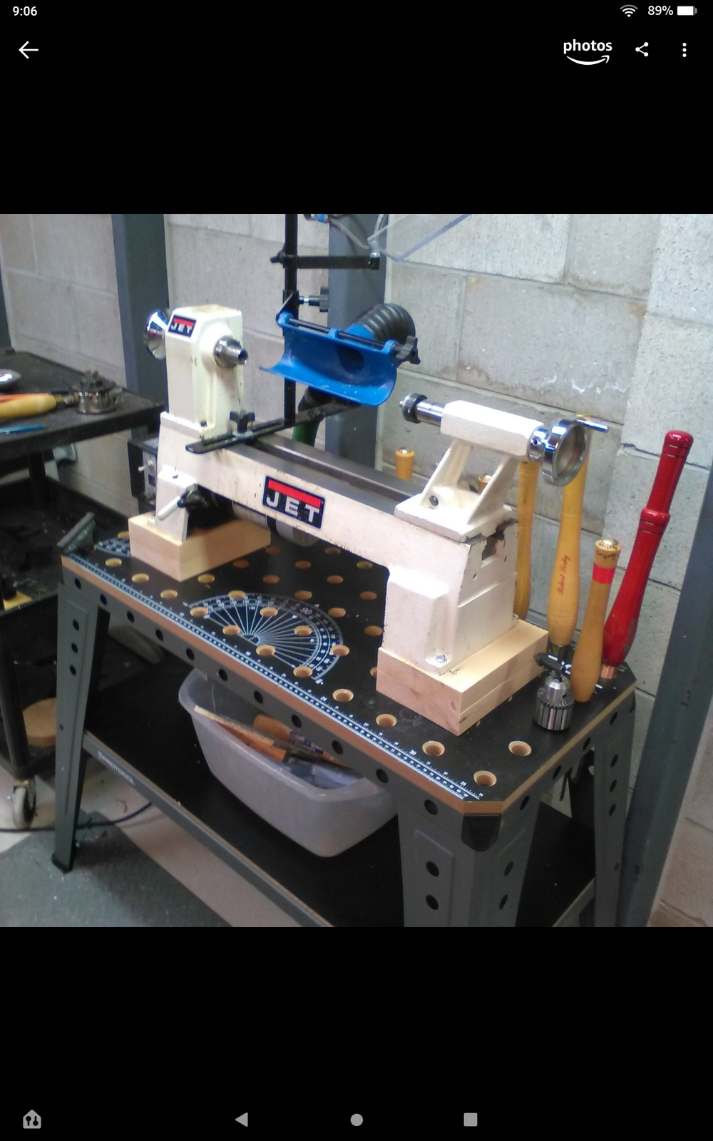

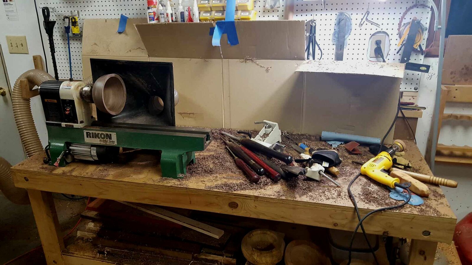

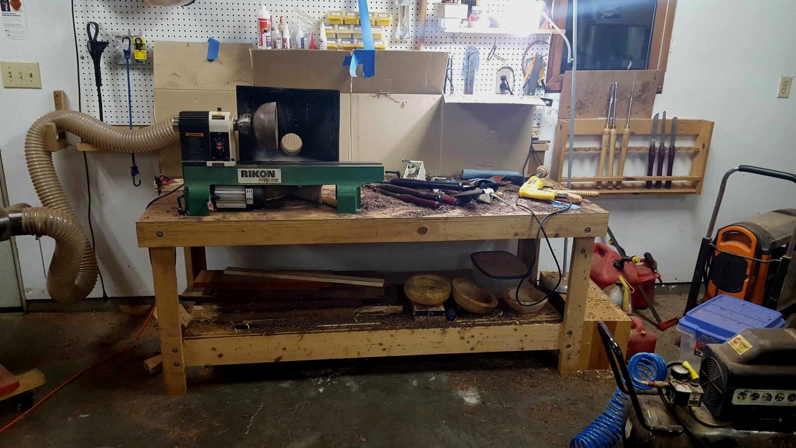

I highly suggest you build as big of a work table as possible to put it on. I've had this one for over 15 years... and because it is so heavy I can put a really big hunk of wood on it without worrying about the wobble. I've got all kinds of room to put the tools I'm using on a project there on the table. Also... plan the height out ahead of time. For me... the most comfortable turning position is where my elbow bends at 90 degrees between centers.

I have this same stand, but mine is from Grizzly. It's very sturdy, very heavy.
The Grizzly stand sure looks the same in the pics but Grizzly wants $130 more for it. $230 vs $100.
Agreed, Not sure why Grizzly's is so pricey (I wish I had known about the Wen when I was buying years ago. . This stand design (wen or grizzly) can accommodate any midi-lathe (Rikon, Nova, others). I also have the leg extension (my former lathe had a bed extension) - I have built a small workbench onto the extension. I also added casters, mostly because I have a very small shop and need to wheel things around to get to other things. I can lock the casters if I need to, but generally, the combined weight of my lathe and the solid steel stand is enough to provide stability.

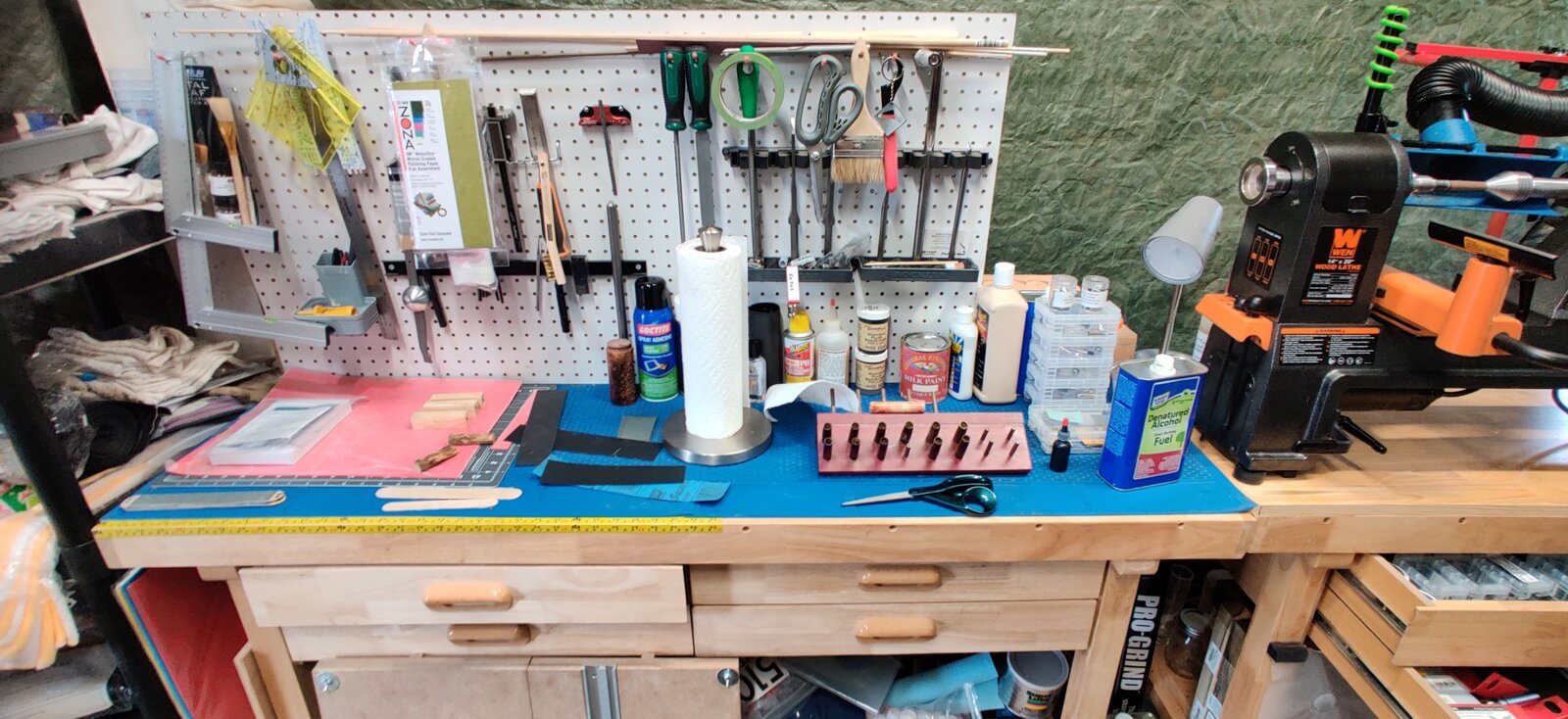

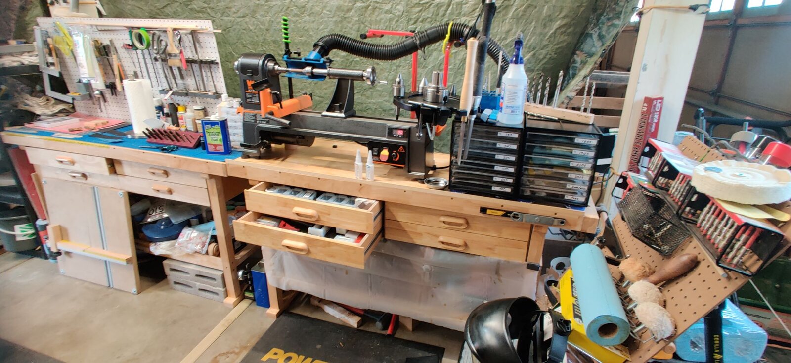

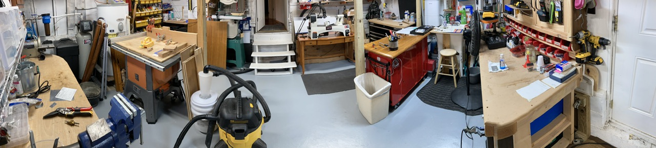

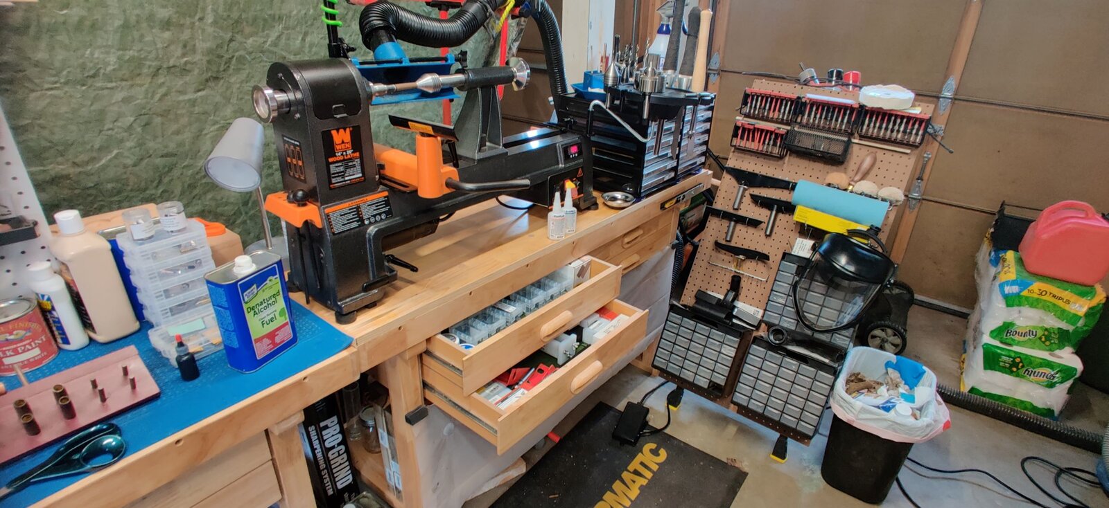

Sorry for not posting before... Had a couple of dry days and had to finish staining my deck (and good thing I did, as the rain has returned.)
So, here is my setup (one side of my third car slot in my garage, the pen production line:
I have two of those workbenches side-by-side here. One was a little cheaper than the other, just timing (the one I bought more recently was of course more expensive). At the end of these two workbenches, I have a piece of pegboard set up against (and tied to) as simple cheap stepladder. Pretty much everything I need for making pens is at my fingertips here. The two benches were maybe $300 total together with tax, and just bought locally at Harbor Freight. The rickety stand I bought for my original Nova was $165 plus the tax and shipping. I'll take these benches any day over the stand.
