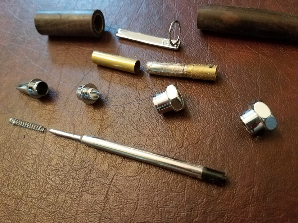

L LOIBLB Member Joined Jul 12, 2016 Messages 68 Location kennedale, Texas Sep 21, 2018 #1 I'm looking for the instructions for this pen kit. On how to assemble it. Sorry for the dust on it Thanks Attachments 20180921_105725_resized.jpg 309.6 KB · Views: 335 Last edited: Sep 21, 2018

EBorraga Passed Away July 17, 2022 In Memoriam Joined Oct 19, 2009 Messages 4,049 Location Louisville, KY Sep 21, 2018 #2 Looks like a version of a cigar kit
magpens Member Joined Feb 2, 2011 Messages 15,907 Location Canada Sep 21, 2018 #3 That kit is called a "Rinehart". . I believe it is a product from BereaHardwoods.com Other vendors sell it also. . It is a very good quality kit but the styling may not appeal to everyone. It may have been discontinued ... don't see it on the Berea website ... but you can still buy it from ExoticBlanks https://www.exoticblanks.com/Rinehart-Ballpoint-Chrome.html That link is for the ballpoint version, but the kit is available as a rollerball and a fountain pen too. Last edited: Sep 21, 2018

acmaclaren Angi the Maker Joined Oct 28, 2012 Messages 265 Location Seattle WA Sep 21, 2018 #4 Magpens is correct. The kit is named "Rinehart". It's sold through Woodcraft. It's currently on clearance. Here's a link. https://www.woodcraft.com/products/the-rinehart-ballpoint-pen-kit-gunmetal

TonyL Member Joined Mar 9, 2014 Messages 9,286 Location Georgia Sep 21, 2018 #7 When assembling, many prefer to align the top and bottom facets on the upper barrel.
magpens Member Joined Feb 2, 2011 Messages 15,907 Location Canada Sep 21, 2018 #8 Yes, Tony is right ... you should align the facets ... and align the clip to be in the center of the aligned facets. . Secure the clip with a teeny bit of glue also so that it does not become misaligned with use.
