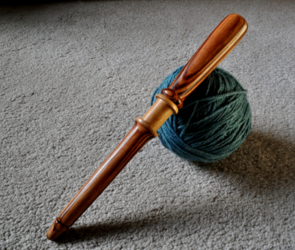

After I first made these last year, my wife sold several to friends in her knitting group. Recently, one of those friends asked her to have me make one that she could give as a give.
This time I chose to use concalvo alves for its pronounced grain, in combination with a cherry accent. I first turned the concalvo alves blank to a cylinder, and then thinned a section in the middle of the blank down to 1/2" diameter. After making marks on each side of the 1/2" section to help me line up the grain when I put everything back together, I cut the blank in half exactly through the middle of that section, leaving two blanks each with a 1/2" tenon on the end.
Then, I mounted a scrap of cherry in a chuck, turned it to form a cylinder, faced off the end, and then drilled a 1/2" hole most of the way through the blank. Then, I parted off a section 1 1/4" long. I made a jam chuck from another scrap of wood that had a 1/2" cylindrical tenon, and mounted the cherry cylinder on it to face off the freshly cut end.
Finally, I glued the concalvo alves blanks into the cherry section, making sure to line up the grain, and then turned the final piece between centers. I parted off the handle end (which was the headstock end of the turning) and sanded it smooth on a disc sander. The pointy end was the tailstock end of the turning, and I sanded it, leaving only a small divot in the end from the live center.
The piece was finished with a coat of shellac sanding sealer, sanded to 1000 grit and then burnished with a white Scotchbrite pad. A couple of coats of tung oil bumped up the color of the wood. After the oil had cured, I used Dr. Kirk's ScratchFreee to polish the surface, and the applied a protective coat of a DIY version of Shellawax.
