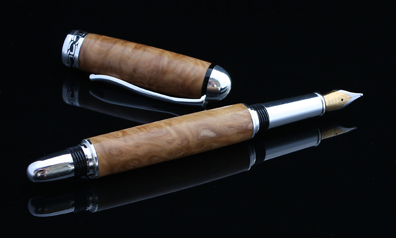

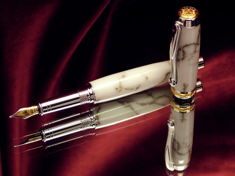

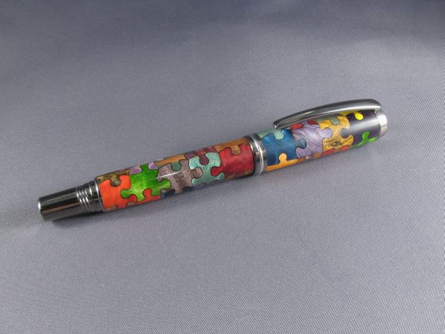

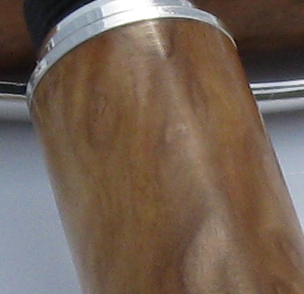

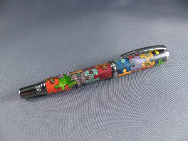

This is to help with some questions, but to make it so others can ask questions, I started my own thread.

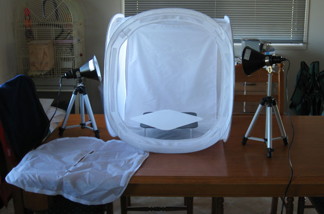

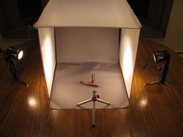

The 1st picture: My layout (a walmart tent).. I replaced the original bulbs with 50w floods. The originals aren't enough. You can see the rough positioning of everything.

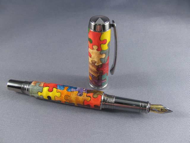

2nd picture: a shot showing the clarity including Lou custom nib :) Make sure to use macro focus
3rd shot: Manual Mode: F8 1/3 second
4th shot: Manual mode F2.8 1/20 second
Note - at this distance and angle DOF doesn't matter all that much.
Used irfanview to resize images.
Again, I'm no expert, but thought I'd show what I do for discussion.

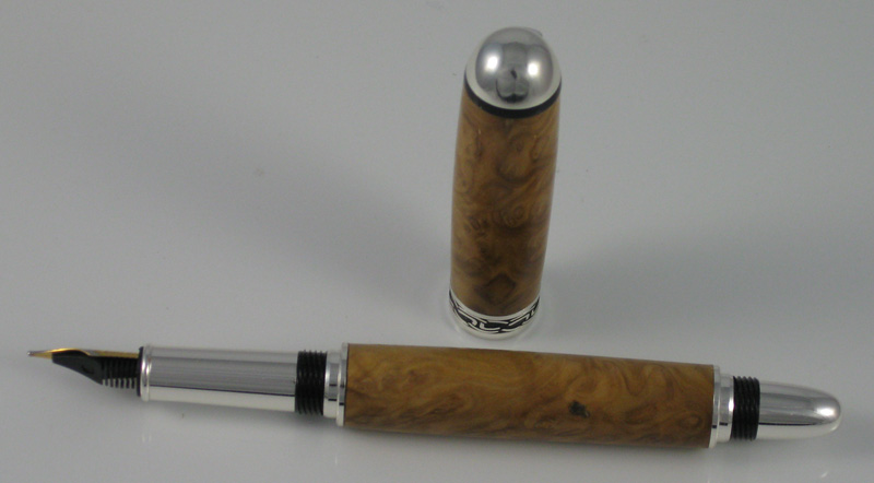

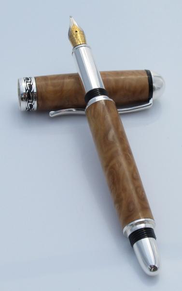

I have some studio lights (strobes, slaves, fills etc) but I've been using
a 500 watt work light (one of those yellow lights on a stand) and a
microphone stand as a boom. I put the light up over the tent facing down.
I find it has eliminated most of the shadows, but a couple of white cards
on either side of the pen helps fill in any darker areas on the sides.
The strong light coming from the top also reflects off of the inside sides of
the tent, which also helps fill in shadows.
I won't win any awards, but it has been working well so far.

So sorry Charlie, but here goes.
The nib of the pen looks slightly blurry. Is that from camera shake, or Depth of Field? Also, the top of the cap has lost some contrast as it blends into the background. Finally, why is there a second ghost reflection around the primary one? Is that due to the top & bottom layers of the reflective surface, or something else?
No problem, fire away. Ansel Adams, I ain't. :tongue:

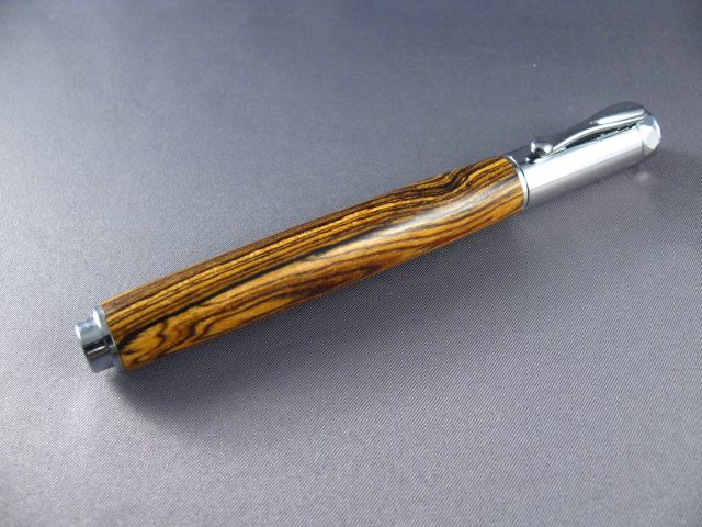

This was photographed on a mirror. (only photo I could find on short notice)
So there's waaay too much reflection. I've since changed to a black marble
tile, which still gives a reflection, but not nearly this much.
A different mirror would help, too. This one has too many layers.
As for the contrast, that might be because this file has been altered, and
I don't have my color profiles set up on this computer yet. I'm used to
working on a CRT monitor with color management software, but on this
computer I have LCD monitors that don't handle color management well,
if at all. Highlights and shadows are blocked up.
As for the focus, that's my eyes. I used to be able to focus well, but now
I find I can't see clearly in that little LCD panel on the back of the camera.
Resizing the image also plays havoc on images. The nice clean lines you
see at full resolution become stairs when the image is resized.
This one might be a little better.

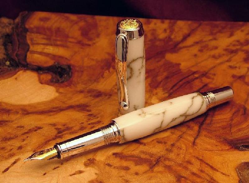

Ok well here's some preliminary pics of my stuff from the A580.
1. My setup. White backing fabric, the light table inside the tent can have either the white or black top on it. Normally I haven't used the table so far, but for these shots the pen is on the white table. On the left, you can see hanging over the chair some other colours for backing cloths - red, blue & black, but to date, the contrast seems to have blown the highlights when I use anything but white. Bulbs in the lamps are 26W energy efficient, 5500K lights.
2. 100% crop straight off the camera, chopped to fit forum required size & saved at .jpg quality 80 also to fit forum requirements. Image is taken from a tripod, exif data says ISO 80/Speed 1/200/F2.6/Focal Length 6mm. Full auto mode on the camera, evaluative metering and oops on having the nib the wrong way. Not sure how the focal length is measured on these things. Lens front says 5.8-23.2mm
3. Same setup, but camera zoomed in on pen, then resized to 800 pixels. ISO80/1/160/F5/19mm
4. I tried a few of the different scene modes, can't see much difference in the shots. This one has the exposure pushed +1EV in the camera. ISO 80/1/125/F2.6/6mm. This may have been hand held as well.
5. I then changed to spot metering, which is probably what I should have been using all along, and took shots focussed on various parts of the pen. Most of the others were focussed on the highlights, and were typically darker. This was the best looking shot to my eyes, focussed int he middle of the pen & bottom of the cap. Only just got all the cap in due to the zoom. ISO 80/1/25 (using 10 second timer)/F5/19mm.
5a. Will have to be displayed in the next post, at my limit.

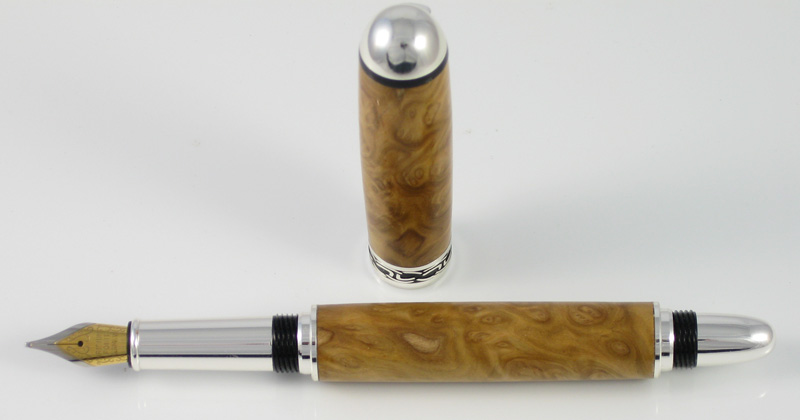

5a. This is the one I'm most concerned about. This is a 100% crop of image 5, saved at 100% jpeg quality. To me, the woodgrain lacks definition, and is noisy. It's not camera shake, so is it the exposure/aperture settings, or is this the limit of the lens/ccd quality?
So the crux of my whole previous thread and these posts. Will a better compact (e.g. Canon G10) produce a better quality image under the same conditions? Will a DSLR (e.g. EOS 1000D) produce better images under the same conditions? Or is the whole problem my setup?
So there ya go, let me know what you think, be blunt, be brutal. if you can save me $1,000 on buying on a DSLR that won't help me, it'll be worth it.
Thanks. Russell.

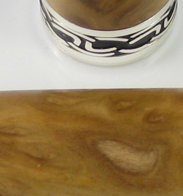

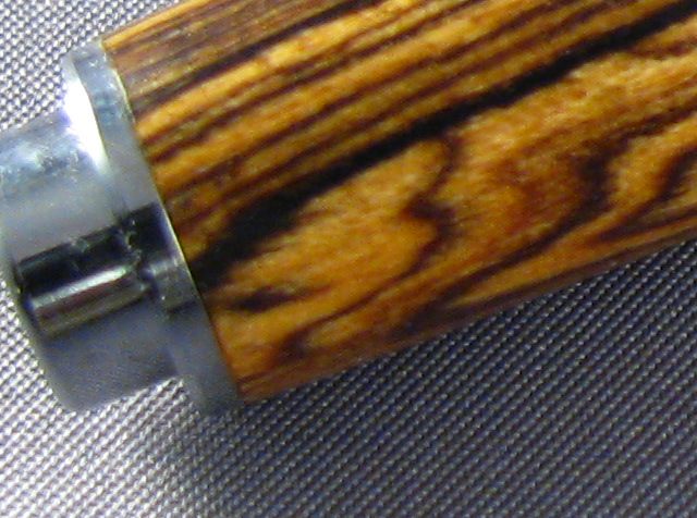

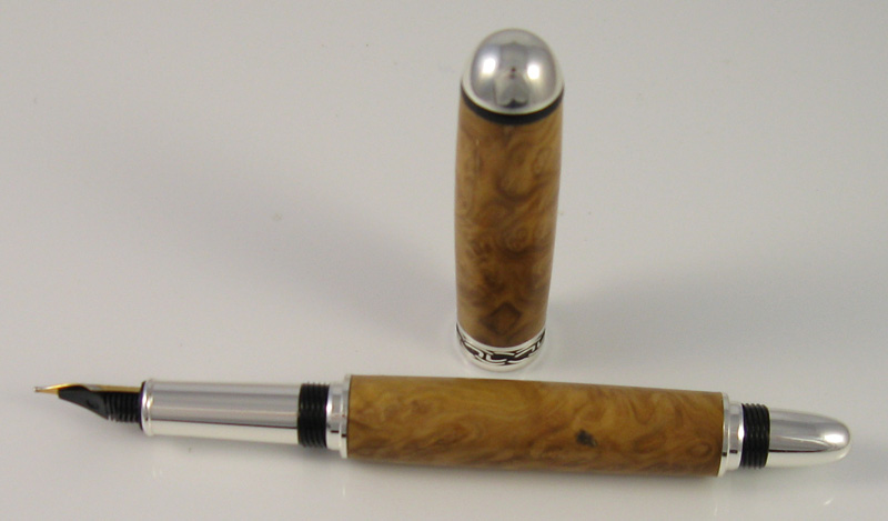

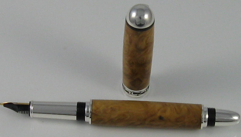

You asked for a lower contrast pic
Here is a more straight grained pen and a crop at 100% straight off the camera. Note - this isn't a new pic, just one I thought would fit what you asked for.
To answer your questions - a SLR would definately improve the things you are asking about. The sensors on any SLR are HUGE compared to our P&S cameras.
That being said, I don't think that an SLR is necessary. That last shot of yours is pretty darn good. If anything, I think the biggest problem is the stark shiny white is too much of a contrast for the camera.
Next round...

Before spending money on a camera, I'd try to get more light on the pen.
The word photography means writing with light, and 26W lamps aren't
giving you all that much of it.
The reason we use larger CCD's and want more pixels is because we can
start with too much and scale down from there. Same with light.. you can
start with too much and let the camera use a faster shutter speed or a
lower ISO, smaller apeture etc. to get down to the level you need.
But if you start out without enough, the software has to invent info to
fill in what's missing.
If you start with more light, your camera has more options available to it.
Also, a higher wattage will allow you to pull the light further away from
the tent, which allows for better diffusion and less harsh specular highlights.
The closer the light is to the tent, the more defined it is in the reflection.
(In the finial, you can clearly see the two lights you are using.)
alphageek
Former Moderator
Jul 19, 2007
5,120
Green Bay, WI, USA.
Agreed 100%... Even with my up-sized lights, I sometimes do more. If you have some halogen shop type lights... give that a shot before buying anything. You'll be shocked what more light will do.
The only thing that will be too much light would be direct sunlight. And even that might be ok in your diffusion tent.

Well, a couple of things. First of all, if you want a closeup of grain (or anything else) get close. JPEGs aren't intended to preserve extreme detail, but to produce reasonable sized files for a level of detail. Expecting one to be detailed all the way down is extremely optimistic. This i just as true for a DSLR as it is for your camera. I don't know much about the simpler cameras, but I know that several are capable of good macro performance,
Now that being said, a good DSLR with good lenses is always going to outperform the little guys. But all that flexibility and machinery comes at a big price. For an extreme example the 40 megapixel Leica S2 will sell at something like $15,000 and the lenses will come at $5,000 a crack. The top of the line Nikon is $8,000 for the body, lenses run about $1,000. But people don't buy them to take pictures of pens.
Whatever you do, don't spend money on a DSLR if all you want is pictures of your pens. They are for people who like photography, will put up with the complexity for the results, and/or like to show off their toys. >:p
OK well, I don't particularly want to show off the grain in close-up, but I do what the grain in the pen picture to look nice, not like some childs finger painting.
I hear what you're saying about price. You get what you pay for, and on the entry level DSLR's, virtually none of the lenses are good for macro. Even a single focal length basic macro lens would be about $400+ extra, which also puts things out of my price range. Whether the kit lens witha close-focus of 28cm is capable of a better picture than a top range compact at 10cm is another question I haven't broached yet.
Finally, to your last point - you've found me out. I don't want a camera just for taking pen photo's, but taking pen photos is my justification for wanting a camera I can't afford (as in, I have the money, but should probably be spending it on more "useful" things). I've always enjoyed photography, videography and playing with images. I most recently (several years ago) did the wedding video for my sister-in-law, along with a slideshow montage of photo's and put it all on a multimedia DVD presentation for them, and really enjoyed it, but that was a rare occurrence. I've done other things in the past involved with image design & manipulation, and the many web sites I've built over the years have all required images in one way or another.
So is it just for pens? No, but currently that & my boomerangs is the only way I'm making money back to pay for the luxury of being able to do it, and I believe standing out from the crowd by going the extra mile and presenting the best you can instead of good enough is what will keep that going. My old Powershot S1 allowed me the creativity to express what I wanted to. The A580, doesn't.
While producing images that may be "good enough" for the online shoppers, isn't good enough for me. What I need to find is something that is good enough for me, that I can afford, and not feel guilty about spending the money for the next however many years it takes that piece of equipment to die. What I don't know is, what is the cheapest price-point where that quality is achievable? Can a $100 compact produce it? Can a $600 compact produce it, or improve to a significant degree where the extra cost for another compact is worht the value? Can a $1000 DSLR produce it, and if so, is it worth the cost for the expanded capabilities to be more expressive not just with pens, but other areas I like such as low-light shooting and macro photography, while losing the portability? If nothing up to this price can give me what I'm looking for, then I might as well stick with what I have & I'll say, that's "good enough" for me, as long as I know my technique is the best it can be, with the equipment I can afford.
Well, sorry for the dissertation. Most of that is subjective. If you can help me make sure I am doing the best I can with what I've got, give me some hint sof the abilities of upmarket camera's in comparison, then the final decision on what it's all worth to me, is mine to make in an informed way which hopefully I won't regret later.
I really do appreciate everyone's time & effort in helping me.
Russell.

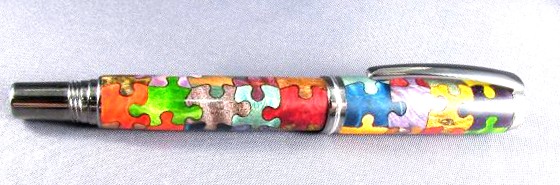

Hey Folks,
Well despite some very good advice here, I went and splurged and got an EOS450D. It's been great so far, the pens have only got a small part of the pictures I've taken, but here's an early pen shot with the new camera. So much easier to take, so much less post-processing needed. WSo far I think it's been a great investment.
Russell.

Hey Folks,
Russell.
Nice pen and picture.... Have fun with the new toy.
Sep 24, 2006
8,206
Tellico Plains, Tennessee, USA.
Dean,
I use a very similar set up as yours.. looks same, but I got off eBay.. I took one of your pictures into my photo program, I use the Microsoft digital image Pro 9... my personal preference is for a white back ground and I was trying to lighten yours some, but couldn't get really white because I was loosing the cap to a glare... I also cropped and straightened the layout of your...
Don't get me wrong, I am in now way criticizing your photography, just playing with it for my own practice... this is what I came up with... hope you don't mind my audacity...:biggrin:

Dean,
.....but couldn't get really white because I was loosing the cap to a glare... I also cropped and straightened the layout of your...
I don't mind you playing, Chuck... I like the angled look better, which is why I don't shoot straight. The only pens I shoot straight are for my sites category listing, where angled would take too much room.
That being say... you really couldn't get white BECAUSE the background is grey. :cool: I do shoot on white sometimes as well. However , alot of the time the camera seems to make the picture 'feel' better without the higher contrast. Stark white background can make it harder on some of the edges, etc. The problem with editing from grey to white, is you've lost most of the deep rich colors of the pen as you edited away the grey.
Dean
