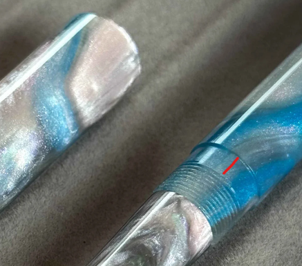

Nice video! Not sure if I missed it but didn't see you make the accent ring. Curious your approach to this. I have started doing this on some of my pens, and using a wood lathe, have had to get creative to get it square so there are no gaps when gluing it in. I've also done some threaded, but think it's a bit more work than necessary. My process has been to use the tenon cutter to square one side before parting it off, then using a parting tool to part it off as close to 90 degrees as I can by eye, then gluing or screwing it on the tenon, and then hitting it with the tenon cutter again to square the other side if needed (sometimes I don't need to but depends on how steady my hand is that day). I also just got a bench sander, so may try squaring up the first side on that next time. Planning to get a metal lathe soon which should simplify the process, but open to suggestions from anyone reading this!

Hello, thank you. The aim of the ring I used in this video is to leave the same empty space between threads and step up. I am using it while making, I have two rings, one for M13 and another for M14, I think they are 4mm long. My intention was not to add accent ring.

Hi Kevin,
Hinze Tenon Cutter's diameters are exact numbers like 12, 13, 14mm and according to my experience (I am not an expert), there should be at least %10 less measurement for smooth threads in order to prevent getting stuck between cap and body. For M13, my tenon should be 12.80-12.90mm, for M14 it should be 13.80-13.90. For this reason, I find it extremely hard to find that sweet point on Hinze Tenon cutter, and when I had the right set up, try not to touch it. That is the reason, I don't do section tenons with it. I have to cut these parts 0.15mm thinner on metal lathe to solve this problem.
On the other hand, I am not bulk pen maker I am making mostly 3 pens at the same time. During making, instead of changing the setting of Hinze cutter, hand cutting sections tenons come easier to me.
