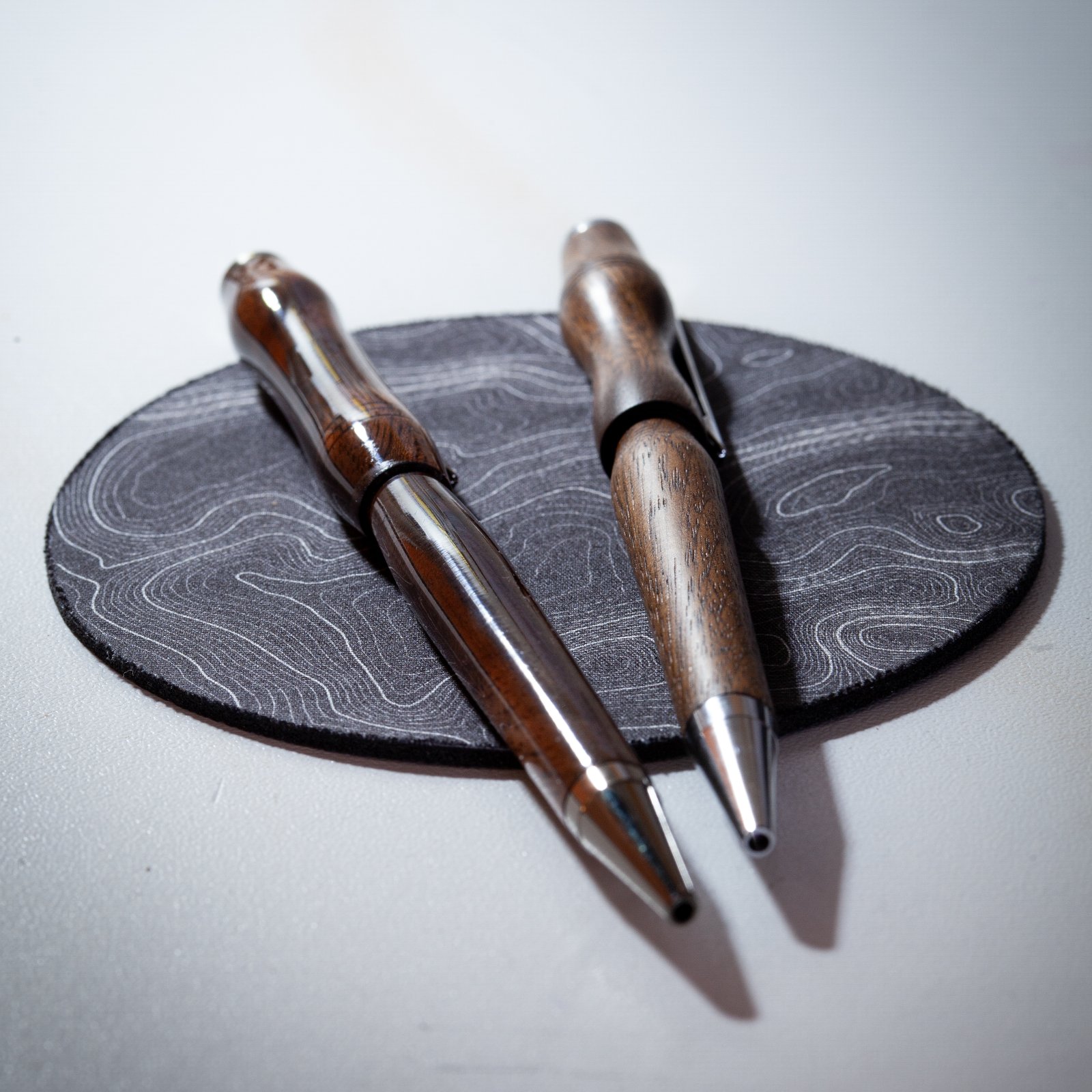

Here is a photo showing a walnut slimline I CA finished a couple of days ago on the left, and a walnut slimline I finished today with this lacquer-based friction polish on the right. The lacquer pen obviously looks more like wood, as it should. But it's a dreadful finish compared to the CA, for someone who wanted high gloss and durability. (Click thumbnail for expanded view) It's downright matte next to the CA finish.
So my questions, in no particular order, are:
1. Would this be significantly improved by using a cellulose sealer prior to the lacquer-based friction polish? Walnut is fairly porous.
2. Would this be significantly improved by building more than 6 coats?
3. Is there something wrong with my application technique that is hurting the gloss or durability of my finish?
4. Is this something that's really only going to work well with melamine lacquer as opposed to nitrocellulose?
5. What other suggestions do you have for a newbie looking to achieve a finish that checks all the boxes (easy to apply on the lathe, low-mess, no long cure times needed, high gloss, durable, less plastick-y feeling than CA)?

To me, this friction polish (despite being 33% BLO and also containing something that should have resulted in a glossier look) looks worse than a plain BLO polish. It has no more shine than straight BLO, but it also has less depth than BLO that has penetrated more deeply. It just kinda looks... accidental.

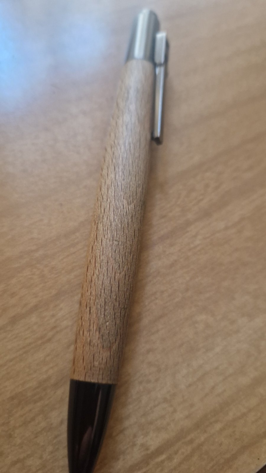

It all comes down to the kind of wood you are using as well as its intented use i.e.an everyday pen or a pen that never leaves your desk. You cannot expect a high gloss finish that isnt a film( the most durable film finish is ca); a decent and somehow shinny finish is a shellac containing mixture but dont expect it to last with everyday use.
In my experience if you use a hardwood that isnt particularly porous it can be sufficiently polished with wet sanding ( with some kind of drying oil, i like walnut oil) and then the everyday use will keep it nice and smooth because the fingers can act as a sandpaper ( provided someone is carefull enough not to touch it with wet or dirty hands). Here is an example of a pen a made a few years back with strawberry wood (arbutus unendo). Cheers
