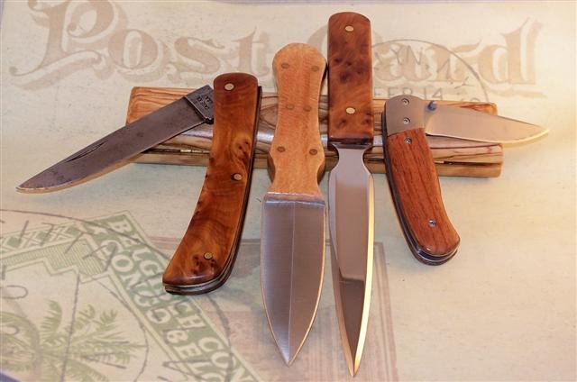

Nothing fancy, just something I like to do on occasion. Starting from the left, the first is my late father's Case Sod Buster. The plastic handle broke, and I replaced it with Amboyna Burl. Finish is BLO. Next is a boot dagger made from local sycamore. Then a letter opener with the same Amboyna Burl. The last is Bubinga, the first knife I ever made. It spent a year in Kuwait with my wife. I may well make better knives, but this one will always be special.

Knife making is a hugely popular hobby/avocation. There are many scores of web sites devoted to the craft. There are also vast resources for teaching how to make knives. The scales are fastened in a variety of ways. As said, allen heads are one, other screw types are used. Sometimes brass rivets are used. I have often used brass or brazing rod, then peen the ends. Whatever suits yer fancy is what makes the end result personal.

Awesome stuff. I want to refinish my kitchen knives with verawood, but the priority list is long. Maybe some day..... How did you secure them? It looks like you used brass rod.

All but the bubinga folder use brass rod. The bubinga one uses the allen set screws.

the folding knife on the far right appears to be the ddr-3 button release lock blade. if it is you can go to www.knifekit.com and get a coil spring for it. its under the replacement coil springs window.
you will need to read and measure a spot on your knife to figure out the right spring.
yes this spring will turn the knife into a spring operated knife:D[}:)].

Do you glue in the brass, or hammer it in some way, to expand it? I have been wanting to do knives other than kitchen, but I don't know what kind of market there would be and I intend to do craft shows and I'm not sure knives are appropriate for them. Man I'm green. Anyway, I was thinking of using contrasting wood pegs for my kitchen knives. Maybe I'll use redwood, or blackwood. I'm looking through those tutorials and they should help me a lot.

I cracked a really nice scale trying to peen the brass. Now I glue the rod in with 5 min epoxy. After plenty of time for it to set, I grind/sand away the excess brass.

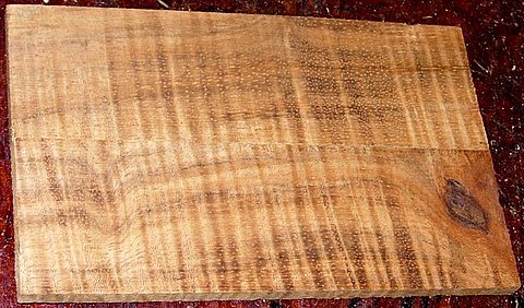

7/32" X 1-5/8" X 5-3/8" Curly Koa, on the house. They're a bit thin, but they should work for some knives.

You need to warn a guy before you give him heart failure like that!! Woohooo, I am already figuring out my next order. BTW, I will get my poor excuse for a thank you package in the mail Tuesday.
