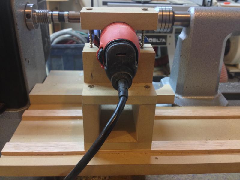

I mounted my Dremel to the lathe last week and will post pictures later today. What I did could easily be done with the tools you have.

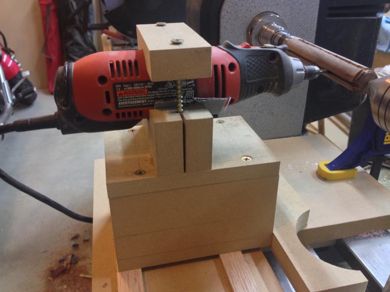

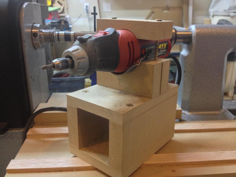

Here is some pictures I took of the jig that holds my Dremel. Please be aware that this jig was not intended for this use it was the very first of several steps in developing a different jig.

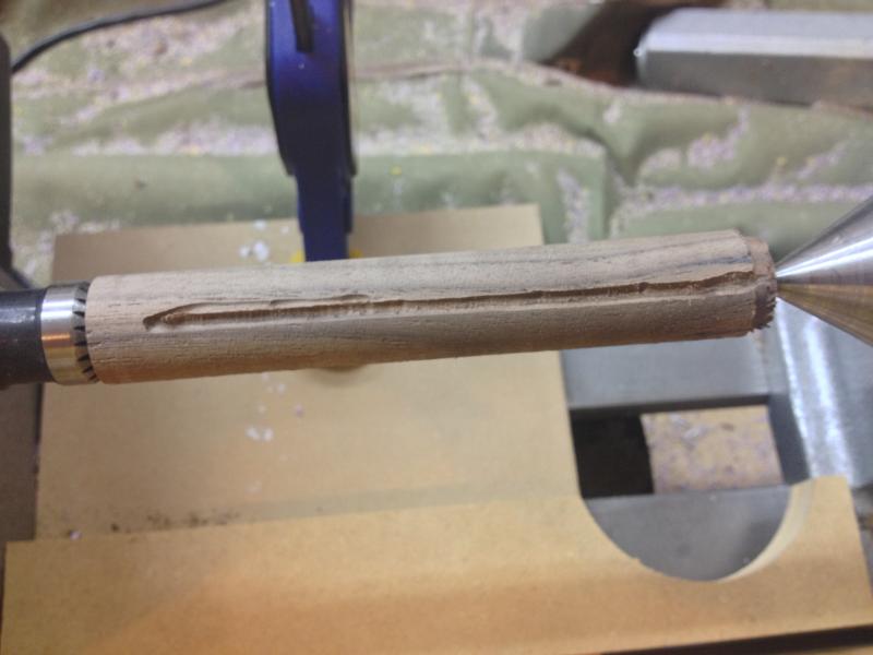

I attempted a couple cuts in a piece of walnut to see how it would work. The first cut I had the bit set too deep and couldn't control it.
I tried it again taking passes of about 1/32". This worked pretty good but on the third pass it rode up and widened the hole. The only bit I have that would work is the ball end one which you see in the pictures. A square end one may have worked better.
If you really want to do this type of segmenting I would buy a router. The Dremel will probably work but with the limited experience I had with it today it would take along time to make the cuts and you would probably ruin more blanks than not. You can get decent routers for $100 and you can probably get a used one cheaper if you watch ebay and craigslist. If you do want to attempt it let me know and I will tell you how I would redesign the jig to make it more successful.

MPEX, By the looks of the cut it appears to mean that you have some movement in your indexing system. This has to be rock solid with no play. The torque from the router and bit wants to turn the blank, even the slightest play in your index can cause the line not to be straight. Just my two cents.

First I wanted to show 1 of 2 mods I made to the setup. This doesn't have anything to do with the problem, just showing it for ideas if anyone else is building one. This is the sliding foot under the lathe rail.
So my problem is that my cuts are pretty horrible as you can see from the photos below. They are sometimes jagged, sometimes they are 'stepped.' Don't know how else to phrase it. What I mean is on a second depth cut, they cut into a different spot. I'm trying my best to stay online,
I'm wondering if the problem has anything to do with what appears to me to be a lot of 'play' in the Colt Router riser. When I am using the thumb wheel to wind it back down to Zero, it has a lot of trouble, most of the time it seems like it skips the thread all together. I have to switch it to unlock and push it down. But even in the lock position, there seems to be too much movement.
Let me know what you guys think! Thanks as always!

My first guess is you were using the router left to right.
Going right to left the bit will pull 'down' on the blank and so long as your router is firm on a solid bed as you slide it along and the indexing is firmly locked. Doing it that way you should get a straight line.
While a router may a better option I still think the Dremel should work. In this case as you mention I think it is simply the jig. Support at the ends rather than centre will provide a better cut. That and my preceding post.

This problem was solved a few weeks ago. It was actually that I was attempting to change the depth of my cuts using the depth gauge (not sure what it is actually called) on my router, rather than doing it by hand. No problems now. Perfect cut every time!

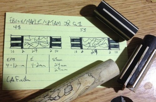

Just finished 2 more. Took the whole week to complete, which is about 20 hours here and there. I'm doing 2-3 at a time for 2 reasons. One, it's more efficient. Don't have to reset things as many times. Two, in case one blows up, I am not completely heart broken and have another to work on. But what is a guy to do when they both blow up?!?!!?!?!?!?!?!?!?

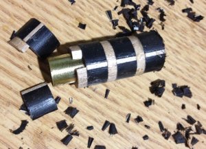

One blank of each pen blew up on the pen mill. Just about cried. Then I picked up the pieces, glued them back together, taped them up and then tried again. This time I used a belt sander (disc would have been better) to get this almost to the brass and then used the carbide pen mill for the last little bit. Going forward, I don't think a pen mill is the way to go on these thin wall segments. Esp. when it's ebony. Any suggestions would be much appreciated!!!

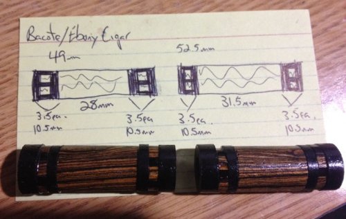

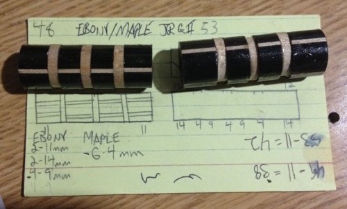

So, I finished both. Won't have final photos until next week. But here are a few after the blank was built with my plans. I'm thinking about incorporating the sketches into the final photo. I just think there is a certain beauty to the planning process itself.
Ebony/Maple Skyscraper Jr. Gent II. After I got to this point, I realized that I didn't need this jig to make this one happen. Going forward, I probably still use the jig as I think it saves a day of gluing over splitting a square blank.
Bacote/Ebony Cigar. My first cigar pen. My wife pointed out it looks like a 35mm film reel with sprokets once it was done. Not crazy about the cigar kit. The Jr.Gents are so far the only kit I've found that I like and even that one I have some major problems with (separate post.) One of the end segments cracked when I assembled it. Freaking sucks when something like that happens at the last minute. Not sure how or if I can repair. Will post photos of that later as well. Need my macro lens.
Last photo is the one I am currently working on. You can probably see it just by looking at the segments and the sketch. Won't be able to work on this any more until next week.
Ebony/Maple/Spalted Tamarind Jr. Gent II
Carbide cutters are not as sharp as HSS. I have had a few particularly fragile timbers that when turned thin have just exploded. After wrecking about 4 blanks I decided to try with a scraper. It worked. Obviously want as sharp as possible.
The problem I've had with the non-carbide is that after using for 20-30 pens I think they get dull. It takes a lot more pressure to make the cut and it ends up burning the ends in the process. I tried using the diamond card to sharpen but it didn't do anything.
