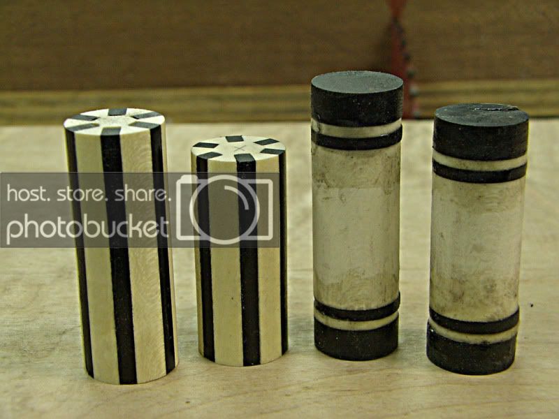

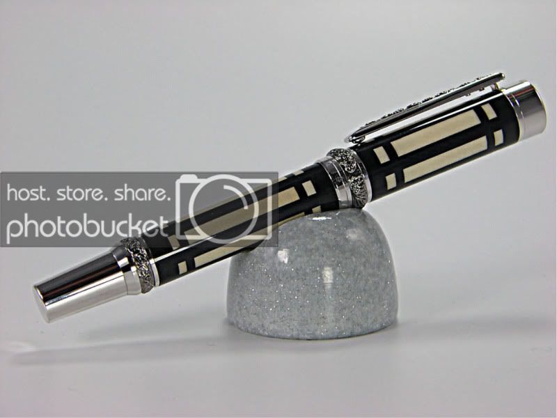

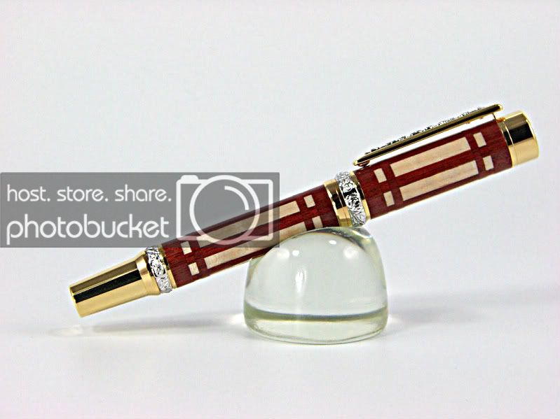

Remember these pens???
Well people have asked how I make them. Unfortunately I did not take alot of photos but will post some and you can get the basic idea and the tools I used to do these and the others that I used the dots on. When I do more like these I will take more photos. I will try to take more photos of any new design I come up with. Any questions I will be happy to address here.

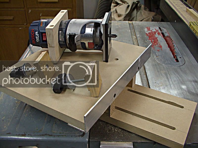

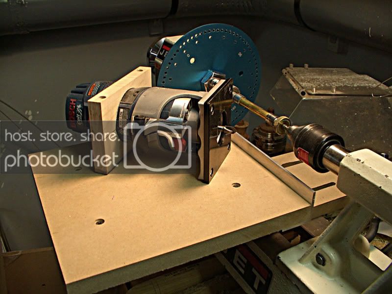

I made a platform for my trim router that allows me to cut slots, drill holes, and other functions which I intend to show at a later date. My shop time is still nonexistant for a couple more weeks. Along with this jig I used my indexing wheel which is an add-on. I will show this in a photo also.

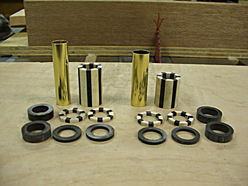

I will show the parts to make the black and white one and the red one was done the same way. As I said I do not have a metal lathe so I use whatever woodworking tools I have and you will be surprised at what you can do.
There are other ways of doing what I do as well as other jigs that can be made and hopefully others will show some of theirs too. But for now lets get things started as requested by Skiprat and others. Here is some photos.
Don't mind the blanks on the right. They were for another pen. The ones of interest are the strpe ones.

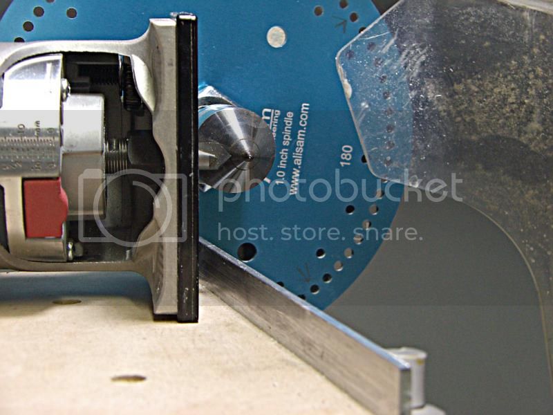

Is that some kind of a V bit? Did you use that just for setup?
Very nice John! The Colt is a nice little router isn't it.
Yes these routers are very good. I have a couple of them. I will leave this one dedicated to the lathe. Yes again on the vee bit being used to get me center line on my lathe so that I can get the correct height of the jig. The point on the bit makes it easy to see.

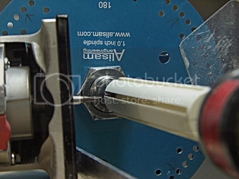

The Vee bit was used once to get center. I needed to find center to get the height of the platform. This is now set to that router which I now will designate for the lathe and doing work like I have shown. It does not matter what pen kit is used.

I have been asked by a few members here for more details on my router jig so I will post some more photos here with some dimentions. I warn you this will be long winded and with lots more photos. The pictures are the best I can without too much effort. This jig is not hard to make at all. The measurements given are mine but you will have to adjust with each lathe type and size. Also the router in use will be a factor. So these are just guides and what I used. This jig can be used in various ways to perform various designs and again as I always say the mind is your limit. Have at it and if there are still questions after this feel free to ask. Good luck.

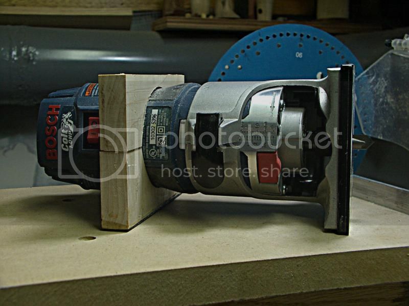

Lets start with the router. My router that I dedicated for this jig and this application is a Colt palm router. Any size router or dremel can be used. A jig to hold the router level and steady as you glide across the platform will be need to be constructed and I can not tell you how to do that. You will have to figure this part out for yourself. You will get an idea with mine. I chose this router because the base is square and it is a good starting point to level it. I should not have to mention this also about a router but i will. I dedicated a router to this jig because mainly I will not have to make any further adjustments if i keep taking the jig apart for other uses. A router does not always fit dead center on a base plate so when aligning center lines up you should mark the side of the router base that will ride on the platform and always set the router up this way to route your design. This is a given whenever you use a router in any position doing any task.
Now I should not have to mention this but I will before we start.again. Know your tools. Watch your safety. You will be using a dangerous tool in the router. You will be using it on a lathe that is NOT turning because you will be using an indexing wheel. Be very mindful of this part.
This photo shows my router with a Vee bit used to line up the center points with the router. This is very important.

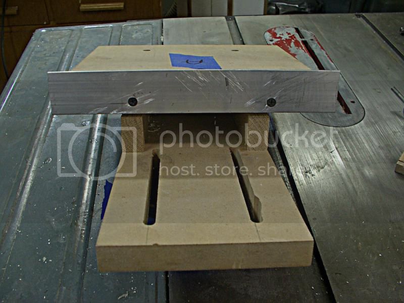

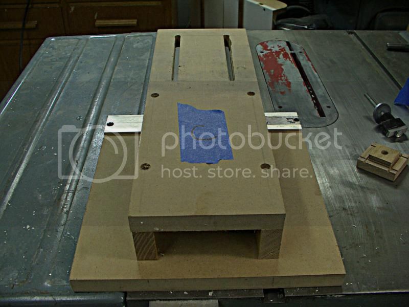

Now for the jig. I labeled the parts with letters. I used 1/8" aluminum angle for the edge guide which I got from Home Depot. I used 3/4" MDF for the base, and platform. I used 3/4" oak for the sides and hold down brackets, so that I could easily screw into and these are all stable materials so as to not warp.

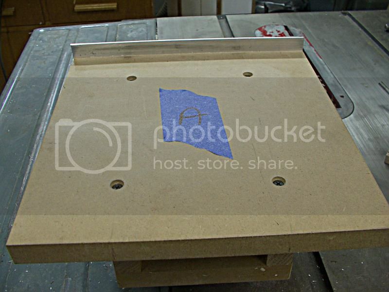

( A ) Platform is 3/4" thick 10" X10" square.
( C ) Base or bottom is 3/4" thick, 15" long, 5-1/4" wide. The slots are 3/8" X 5" long. This photo also gives you a view of the underside. As I mentioned in a previous posting here, I should have made the slots closer to the center of the base more because my Tee handles for the hold down clamps hit the side and I had to cut the handles down to make them work. Just something to be mindful of.
( B ) The side rails are 3/4" thick oak 1-5/8" wide, 9" long, with a notch at the front for the angle bracket.
This photo show the jig from the front. You will notice there is not much depth because this jig was made for a Jet 1014VS lathe which is a midi lathe.

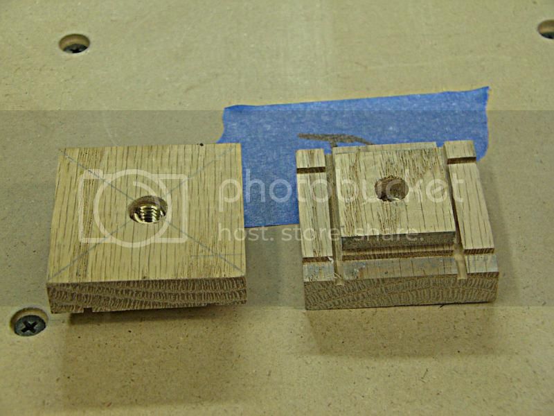

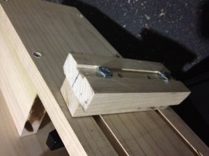

The hold down clamps are 1-14" X 1-1/4" square with a depth of 3/8". The width of the top of the square will be determined by the slot on the lathe bed. You need to measure your own.

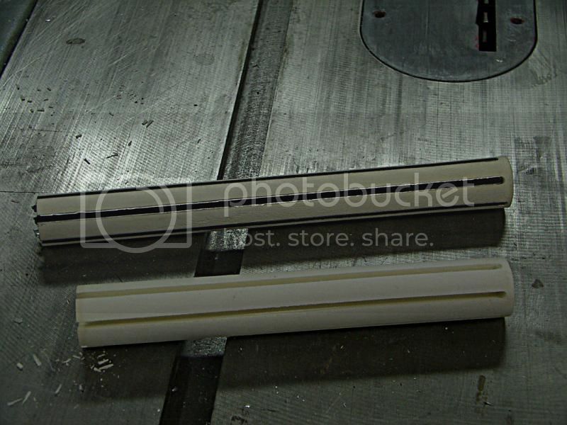

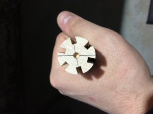

In this photo I show the jig making some 1/8" slots in a blank I will use in the future. It shows the Indexing wheel which I gave the info for in a prior post here.
Finally here is a quick shot of a blank cut with 8 slots and one with an infill of black ebony and aluminum in a Holly blank. Again for a future pen project that I need time to complete.

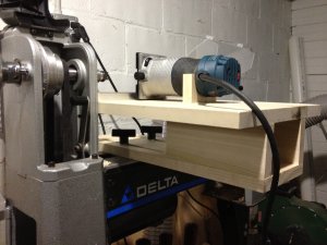

Finished the jig last night. Made 2 modifications which you can't see in this photo. I will take some photos in the next couple days to show it. So far so good. I cut the risers just a hair short and used veneer between the risers and the platform to get the router to center.

First I wanted to show 1 of 2 mods I made to the setup. This doesn't have anything to do with the problem, just showing it for ideas if anyone else is building one. This is the sliding foot under the lathe rail.
So my problem is that my cuts are pretty horrible as you can see from the photos below. They are sometimes jagged, sometimes they are 'stepped.' Don't know how else to phrase it. What I mean is on a second depth cut, they cut into a different spot. I'm trying my best to stay online,
I'm wondering if the problem has anything to do with what appears to me to be a lot of 'play' in the Colt Router riser. When I am using the thumb wheel to wind it back down to Zero, it has a lot of trouble, most of the time it seems like it skips the thread all together. I have to switch it to unlock and push it down. But even in the lock position, there seems to be too much movement.

I will respond to you and explain what is happening and try to tell you how I do this. You did a nice job with the jig and I see your mod. My comment to the mod is it is OK for what you are doing now. But you will find there is a ton of other things you can do with this jig and that mod will prohibit it. Will get into that at a later time when you master this setup.
From the last we spoke you had an issue of routing off center. Did you fix that???
Next to this problem. Having to adjust the bit in and out will cause misalignment. I mentioned sometime back that each and every router may not have the exact center to the base. So whenever you are routing anything weather it is freehand or table mounted or jig such as this, the presentation of the bit to the wood must stay constant. If you turn the router or the base the presentation can be off because the bit does not sit dead center of the base. There could be a multiple reasons for this which I will not bore you with.
To fix your problem is very simple. Don't move the router in the base. Set it and forget it. Here is what I do. I have the bit sticking out about 3/4" or less. Not critical. I determine my depth that I want to make my grooves. This is usually just shy of about 3/16" off center. This way I know I am deeper than the tube and there is max amount of material on the blank. I make a mark on the end of the blank and now measure from that mark to the outside face of the blank. This varies because of the OD you made the blank. I now either take a drill bit that matches the measurement I just got or I actually have been using and here is another use for the transfer punches. I find one that is closest to my measurement.
I set this bit against the fence. I now take the router and push it against the bit. So now you have the base of the router up against the bit which is against the fence. To set the correct depth you need to adjust the jig in or out. I do this in 2 places. On both ends of the blank. I push the jig in so that the bit in the router just touches the face of the blank. I carefull tighten the thumb screws but not too tight because I now slide the setup down the other end of the blank and do the same thing. I keep doing this untill I get equal spacing on both ends of the blank with the bit just kissing the face of your blank. It may take a few trys but it gets simple after a few of these. Then make sure the jig is tighten down.
Now you have your depth set. As I told you you need to take small cuts or else the router will climb on you. You advance the router making sure you hold it down square and that it slides evenly over the platform. You back off when you get to the end and again advance the router into the blank untill you finally now have the base riding against the rail on the jig. Your depth of cut is the same on all precedeing slots. See I told you it was easy. So now lets see something.
Hope this is pretty clear. If you still have questions feel free to ask.
