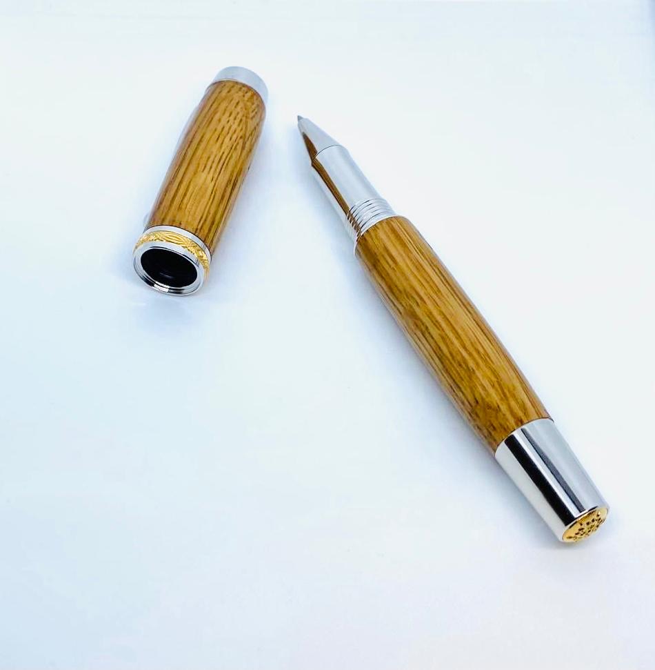

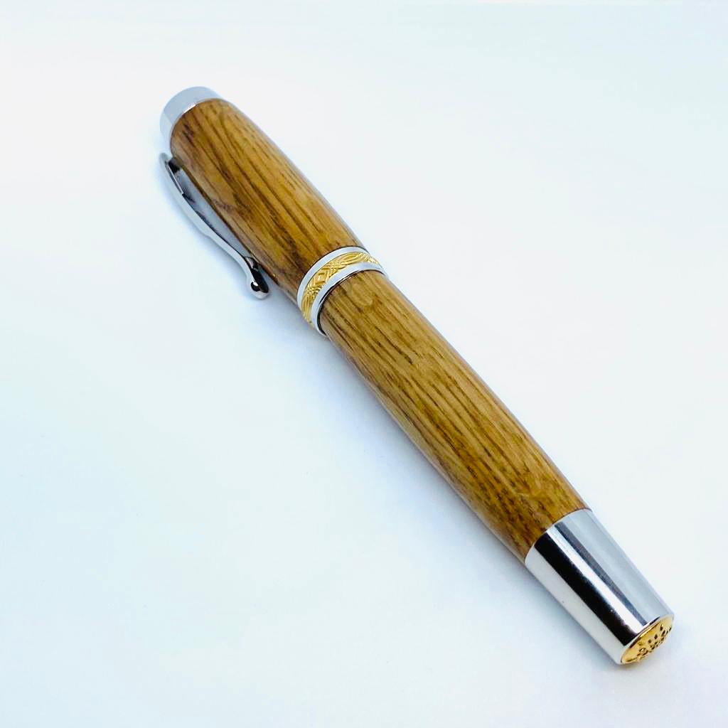

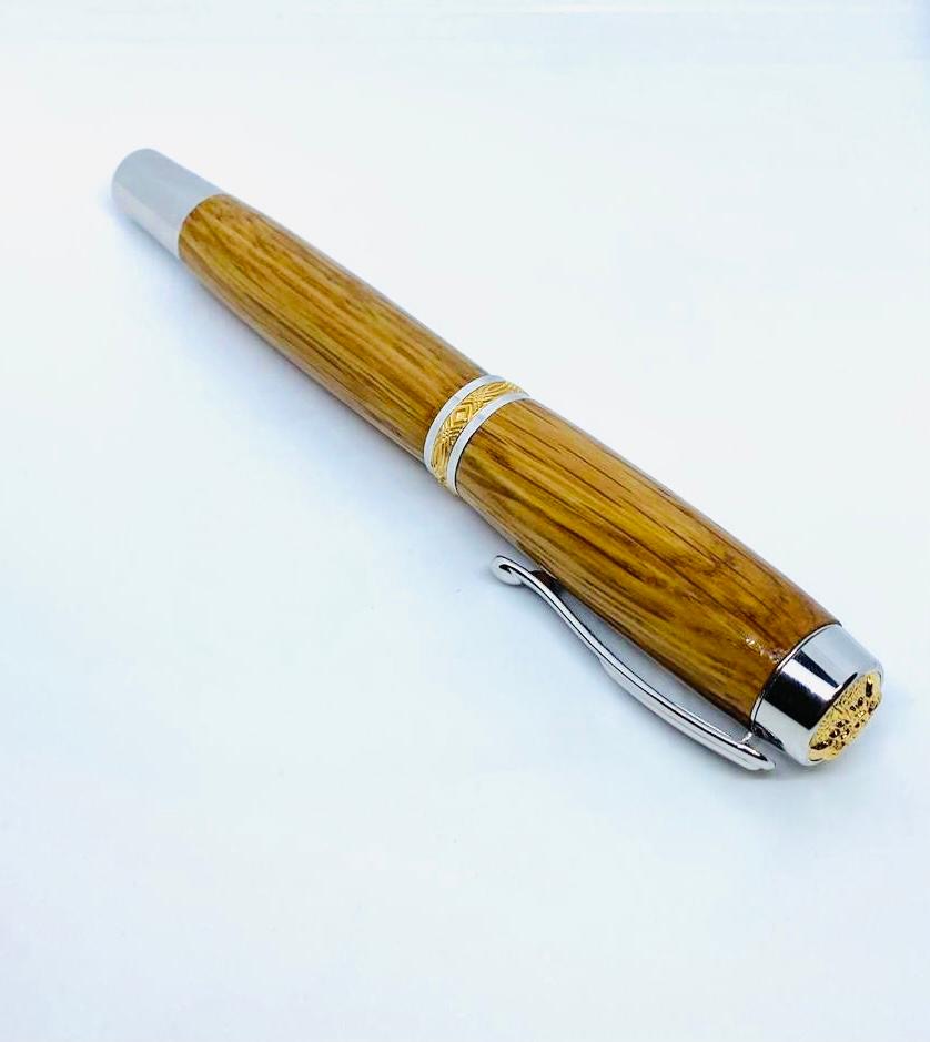

My first pens of the new year. A Bethlehem Olivewood Full-size stateman and the other is a Jim Beam Bourbon Barrel pen for one of the execs.
