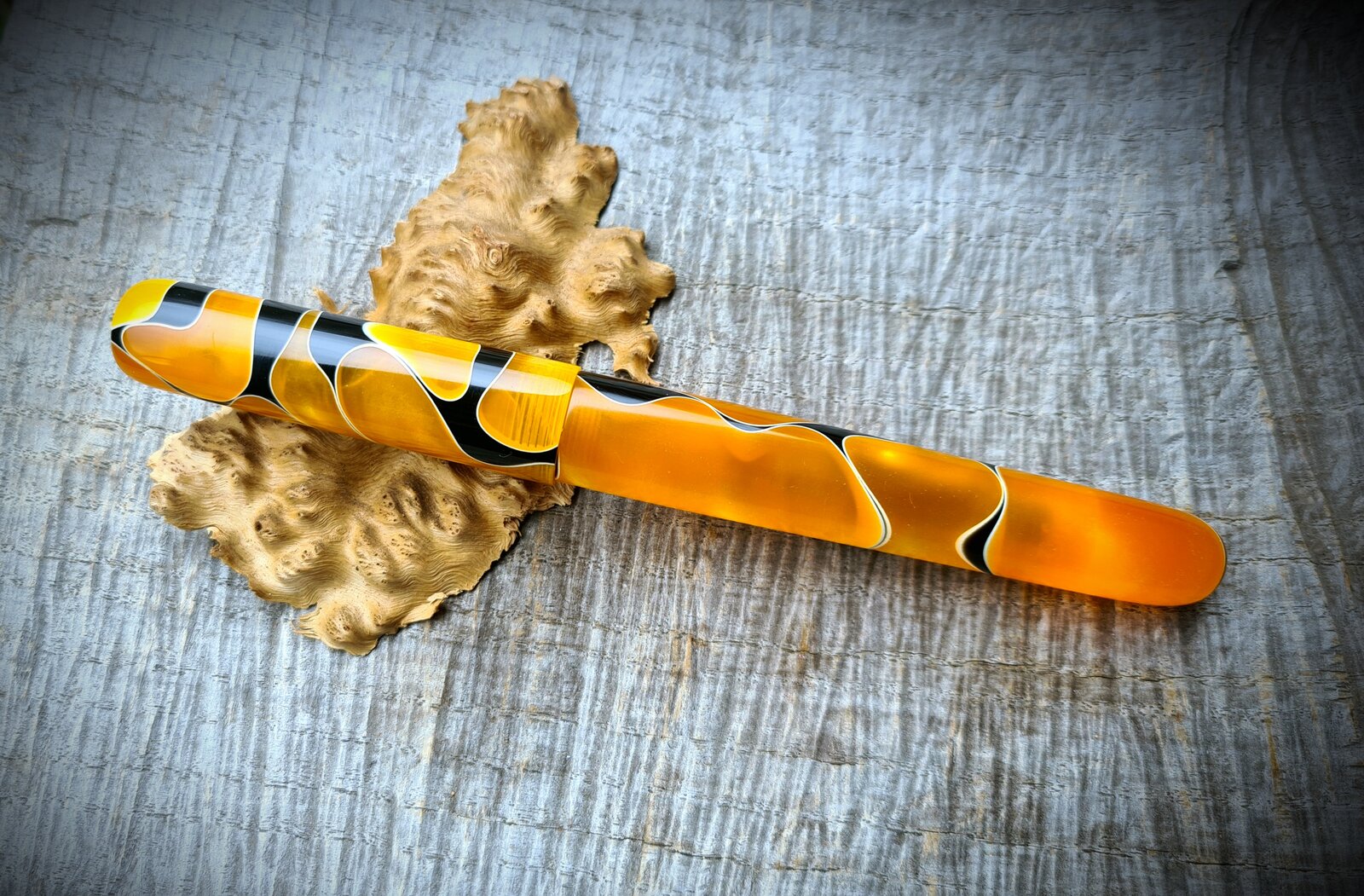

G'day!
Thought I'd venture into the kitless rabbit hole and have a go!
My great mate and mentor Stephen Just has made many of them, teaching me step by step.
Jowo #6, acrylic
The shape is a little meh, but that'll improve over time (hopefully!) AND the pattern doesn't line up due to a few mistakes
Thanks for looking!

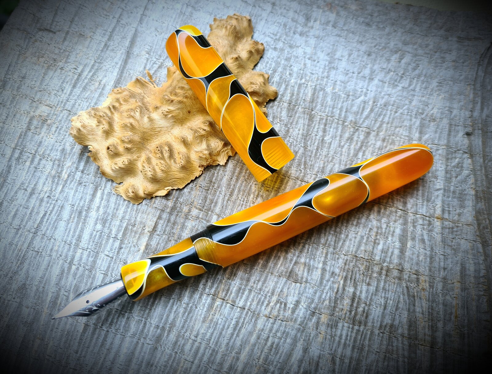

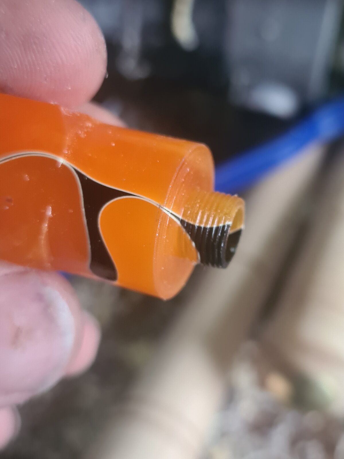

Not sure what to make of pics #3 and #4.
Does #3 show the section-to-body thread ? . Or does it show the body-to-cap thread ?
What is the white showing in pic #4 ?
Great work, Casey !!! . Congratulations on your FIRST !!! ( of many !! )

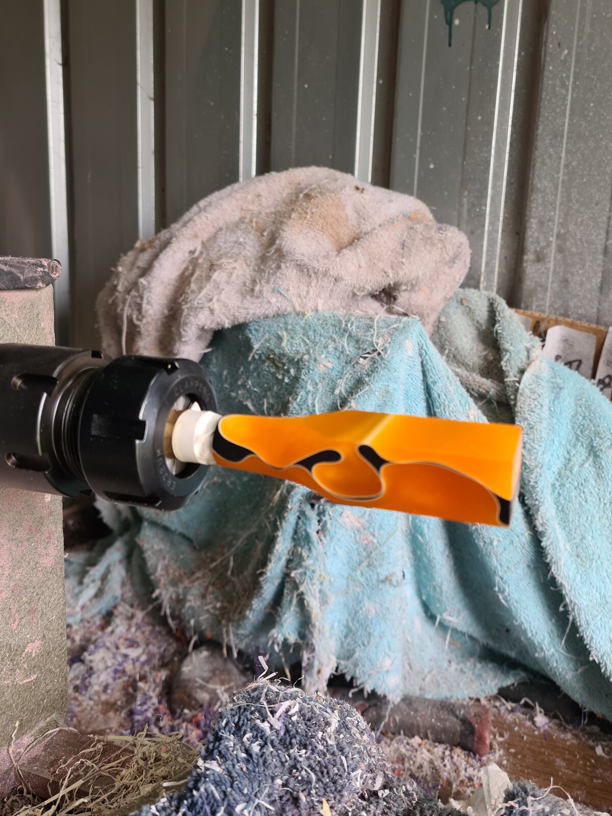

Thanks Mal, hopefully many more to come!
Yes, pic 3 is section to body, and pic 4 is some tape covering the threads and mounted to a mandrel, just to protect them a tad
