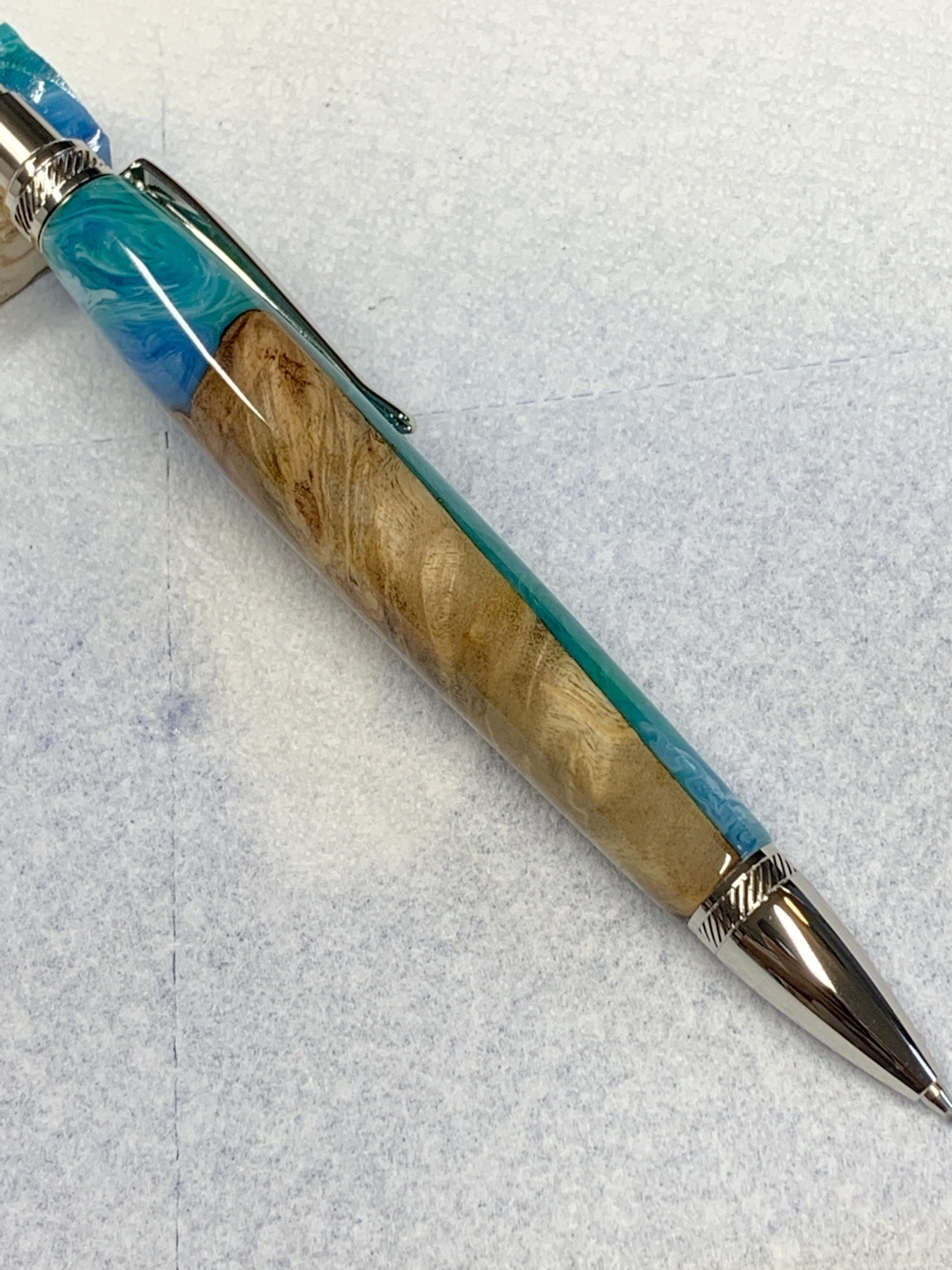

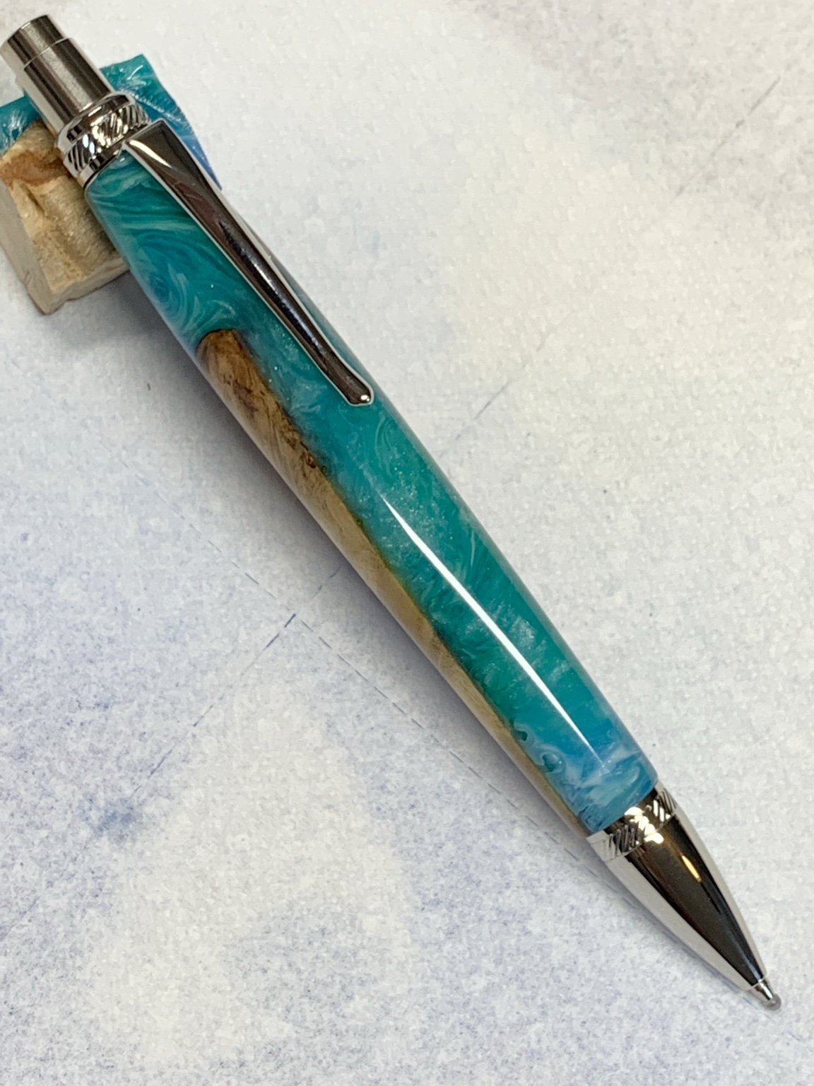

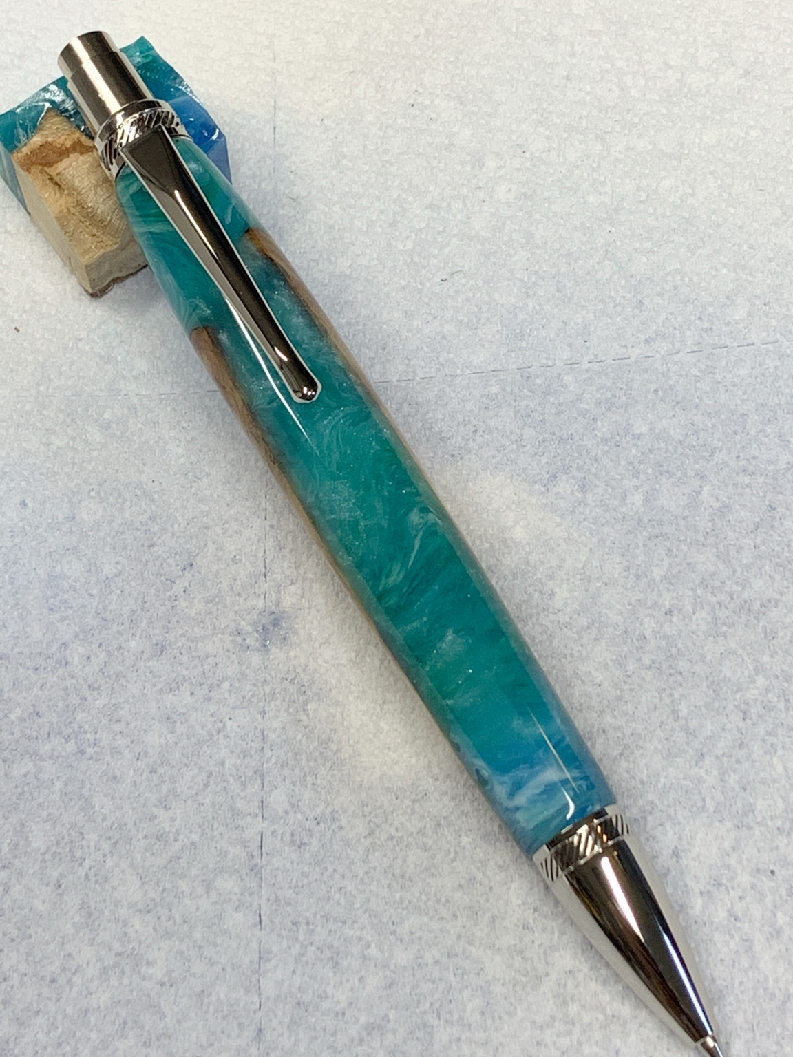

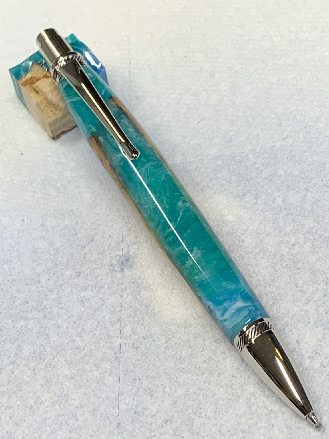

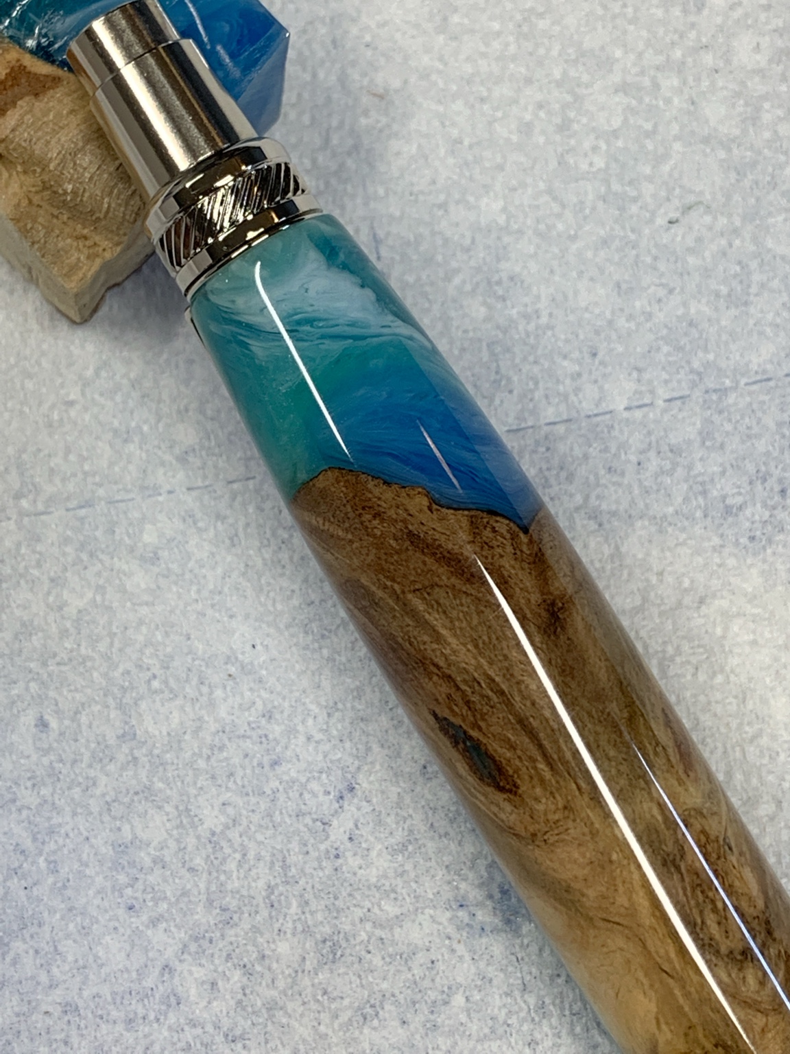

Hybrid blank- buckeye burl and Alumilite. I'll admit this was challenging because it's a really long blank which made CA and finishing plain whackadoodle for me! I'm really amazed at the action on this pen.

Your wackadoodle turned out superb. Lovely finish and an attractive blank. And yes, the mechanism is excellent - a favorite of mine.
Thanks for sharing.
Beauty defined! How was it finished? P
Five coats of thick CA, followed with several coats of medium. Sanding is pretty normal... 400, 800, 1500 grits to micro mesh 3200 to 12k. Last is One-Step plastic polish for that extra shine. I'll add that I know one-step can be applied after 400 grit, but I find it makes a better polish after 12k. I could be crazy?
Not crazy a bit. That extra bit of effort from 400 to 12,000 makes a visible difference.
The click mechanism in that pen and a few others sold by Berea is the Schmidt skm-88 all metal click mechanism. It is a great click mechanism and I will only make click pens using that mechanism from now on. The sierra super click uses that mechanism also.
The click mechanism is available for those who make custom non-kit pens. Several vendors sell it.

That's good to know! It's definitely a good "feel" with smooth action.
