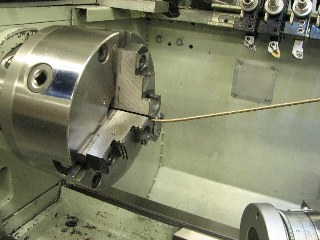

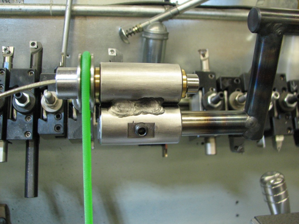

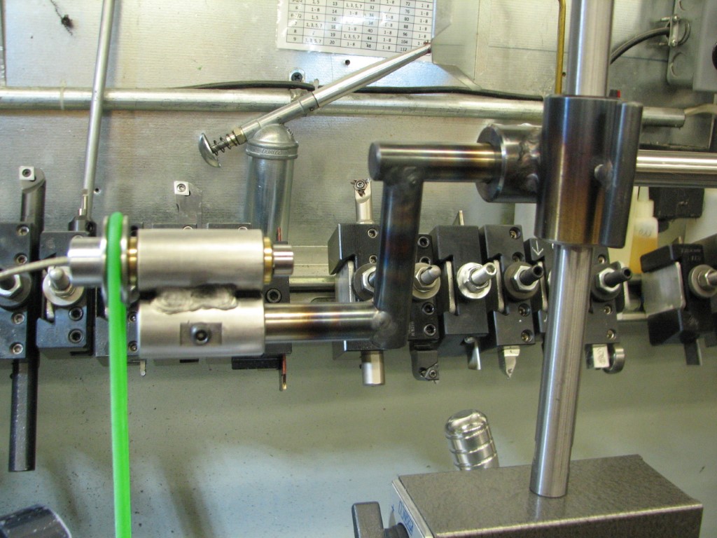

I made a pulley and a spindle and mounted it on a magnetic DI holder on my tailstock. That wire going into the spindle is actually the inside shaft of my Dremel Flexible Shaft tool, which I have never use anyhow. It's connected to my lathe chuck and that's how I spin the spindle.

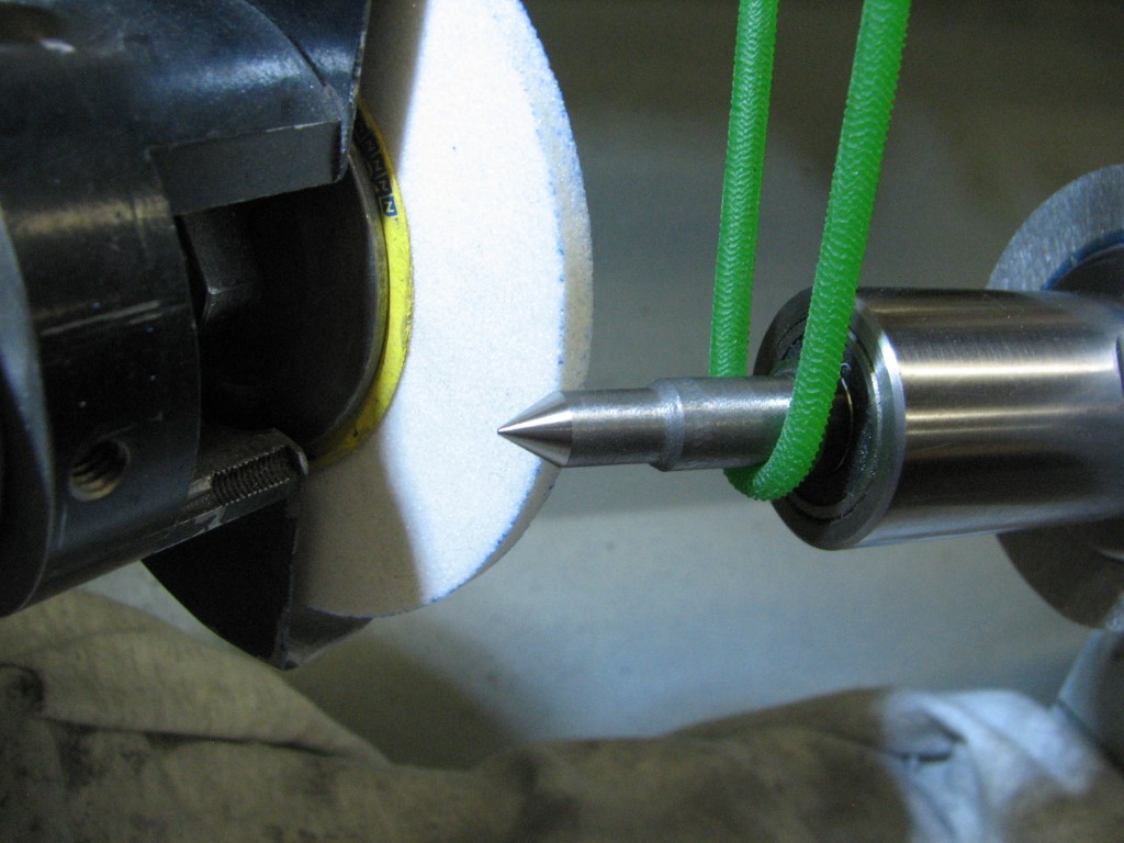

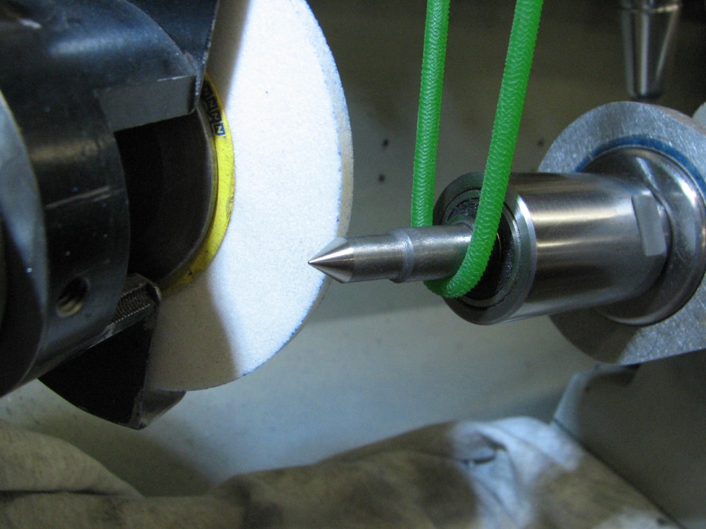

Here are some close up shots...

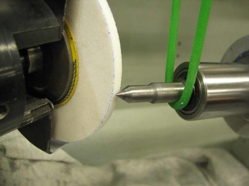

Here's a before and after shot of my first attempt and it works really well!!
So now I guess I'm in the live center grinding business!!!

A further possibility might be to use a rubber wheel on the dremel and let that drive the live centre spindle . This would have the rubber wheel near the grinding wheel but would eliminate all the whirring wires overhead? Just a thought . Obviously your spinning the two in opposite directions to increase surface speed I assume?
Any kind of small drill could drive the rubber wheel eg a die grinder attachment at the tailstock
