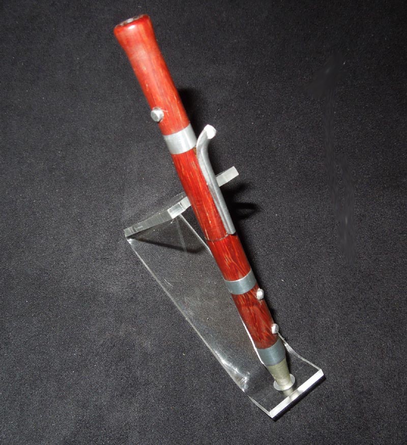

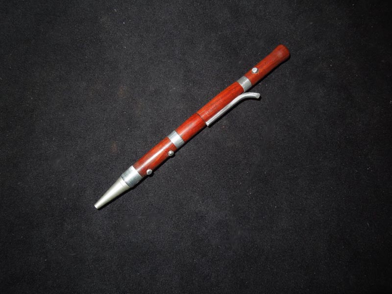

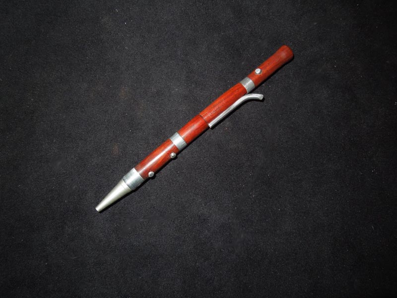

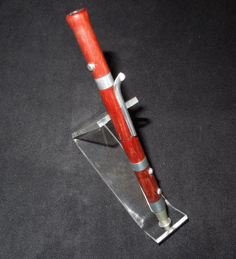

I think I've posted this one before, but my bassoon pen was a big hit. I'm already thinking of a clarinet version and a flute.
Gary

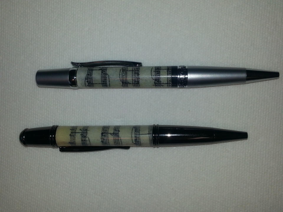

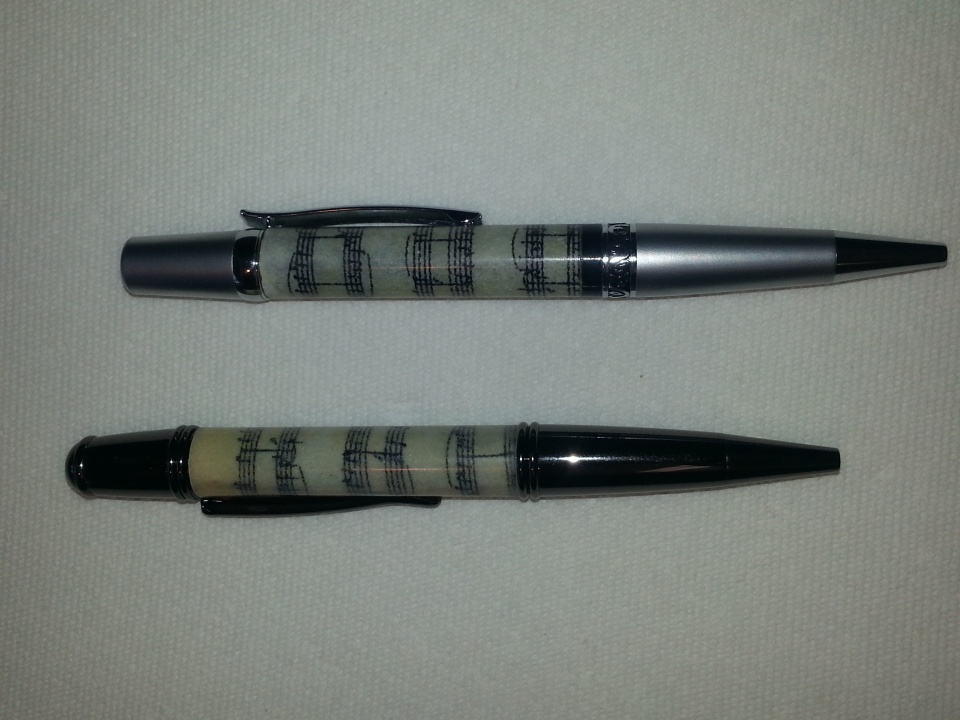

I decided to go buy some decal paper, downloaded picture of piano key board and applied it to a piece of white Holly. So with cost of blank, 4 hours labor, Vertex kit and pen case it will be priced at $85.00.
