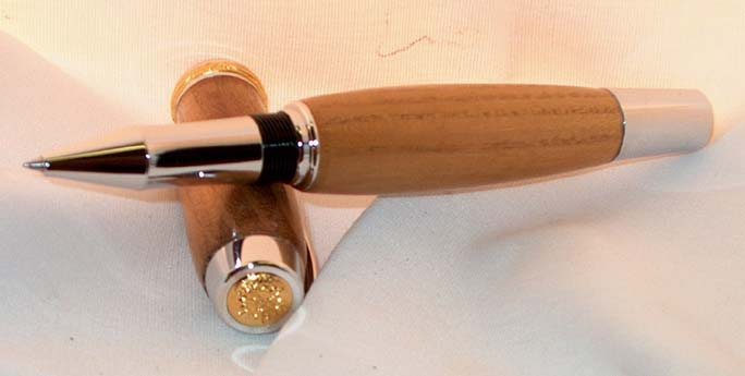

Here is a Statesman I did for a friend that is giving me a LOT of wood for pens and bowls. It is made from a piece of mulberry that he gave me last year. I used my new Photo Studio that I got from someone in the casual conversation forum. It is a white rubbermaid trash can with a white pillow case and 2 clip lights with 100W bulbs. Let me know what you think.

Mark, Another thing that you can do (depending on your camera) is use the timer. One other thing that I notice is the color casting, I think that maybe you need to tweak the white balance. Other than that I would say that you seem to have a good amount of light and of course the pen itself looks really nice.

Wayne,
Should I use more or less white balance? I'm not that camera literate. I think I will use my remote for my camera. I think this will help me a lot.

Mark,
If you have a program like Photoshop, Microsoft's Digital Image Pro, Paint Shop Pro, or most of the other digital picture programs that are out there (one probably came with your camera) you can adjust the white balance in the software. What you'll notice is that the wood should come out looking even closer to its actual color once that's done. If not, there are also color correction tools.

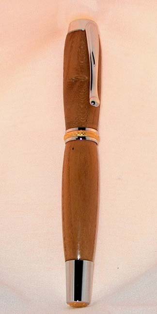

The second photo really works for me. great detail. I don't see shake, I see a sharp shadow under the pen. you might try a piece of paper (White) to reflect a little more light under the pen and lighten that shadow. good job.
