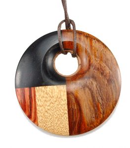

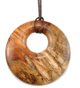

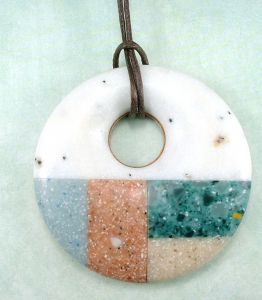

Once I got started on these, I can't stop until I had one for all the women in the family:)
Here's a few from this weekend:
The first is Cocobolo, Blankwood, Yellowheart, and Tulipwood. The second is corian, and the third is Amboyna.
Thanks for looking.
-Barry

Wow Barry, those look great. My daughter seen me looking at the last few you posted and has been pressuring me to make her and her friends some. I like the Amboyna the best, but all are nice.
