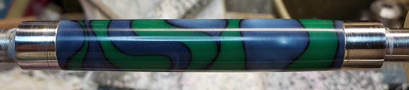

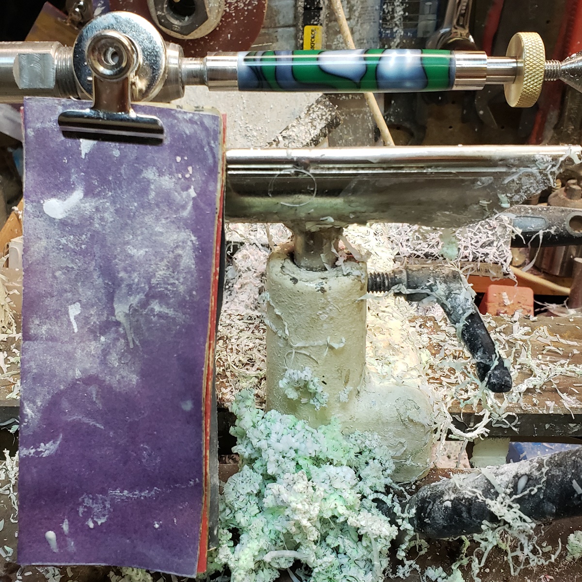

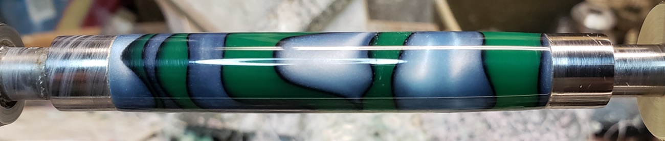

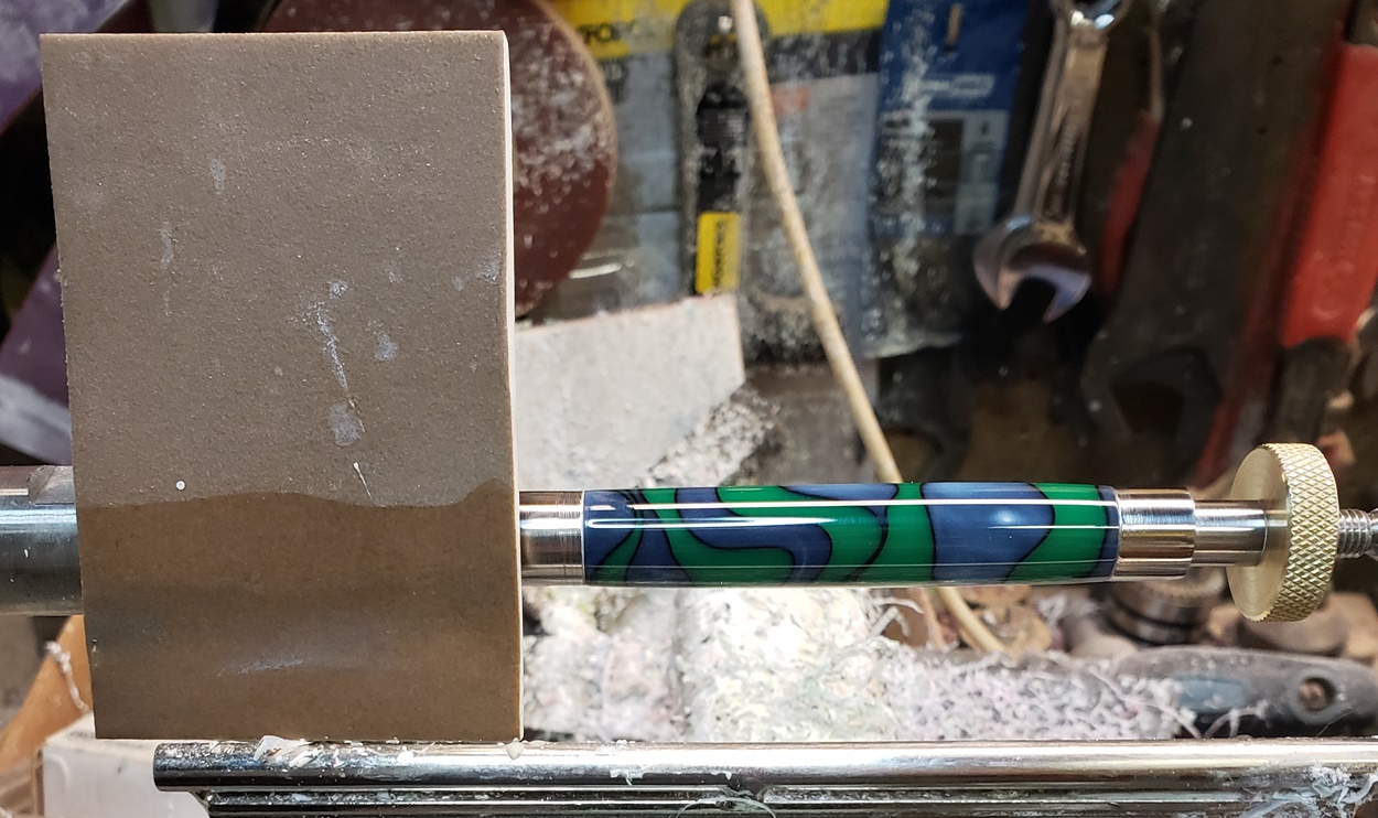

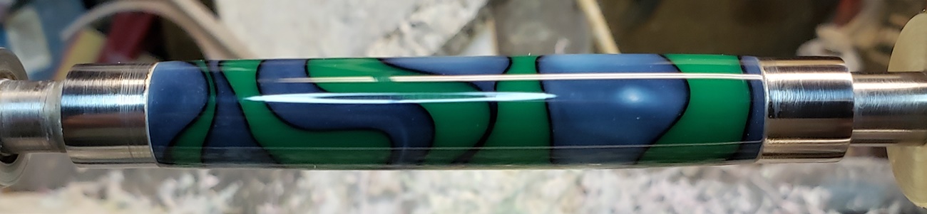

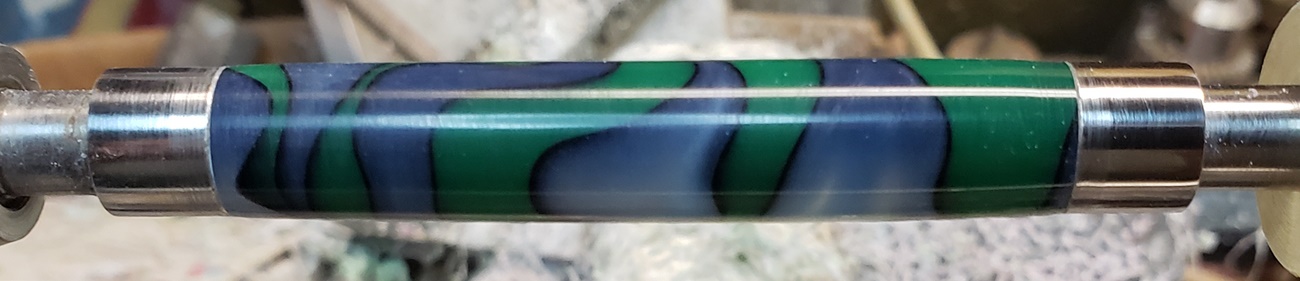

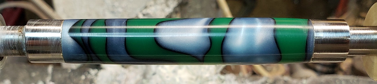

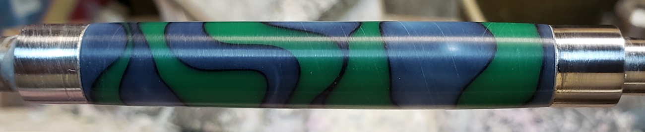

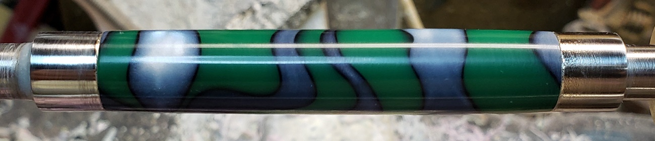

This is an AA blank from Woodcraft called Irish Hill. It's a good looking blank. First I used 220-320-400-600 wet, then polished it with Tri-M-Ite. It polished up nicely. But I'm trying to put a matte finish on it. So I went back and used the first grade of Tri-M-Ite only, but you can't hardly see a difference.

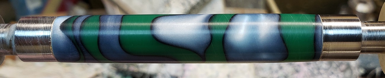

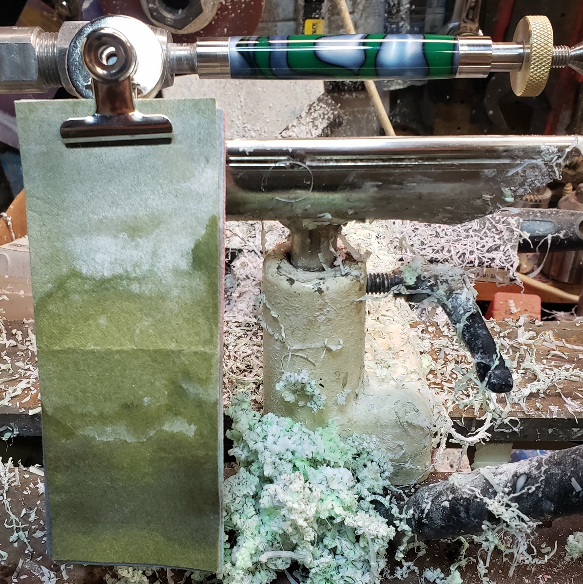

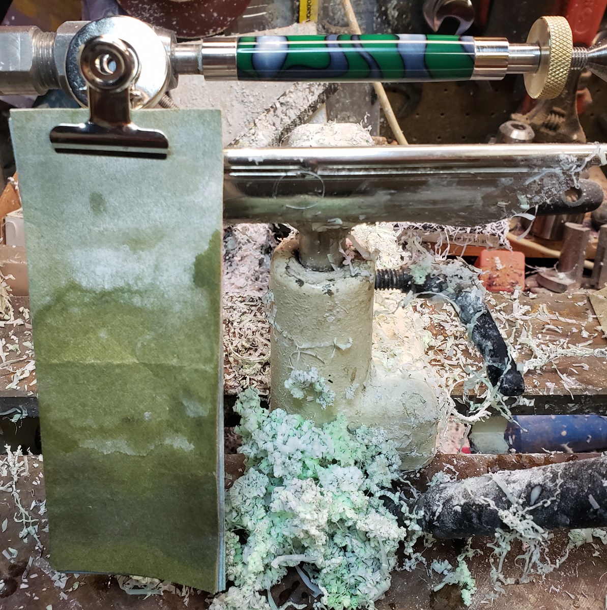

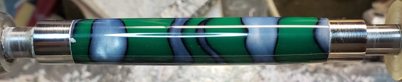

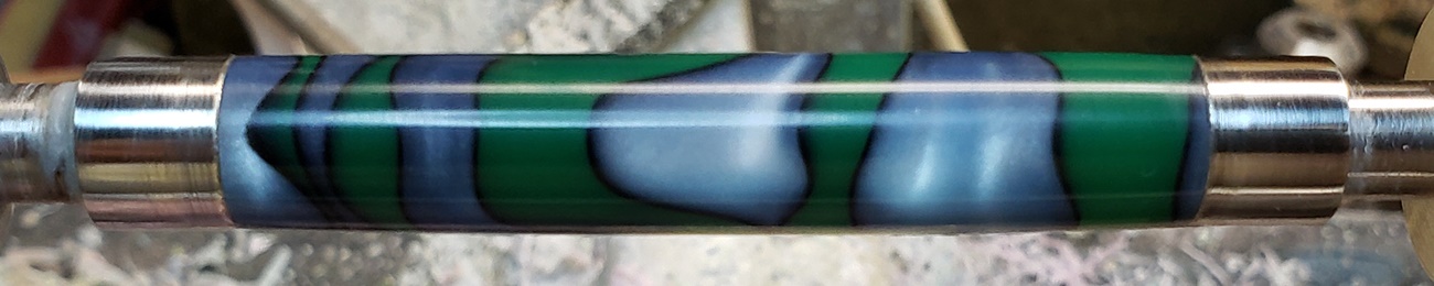

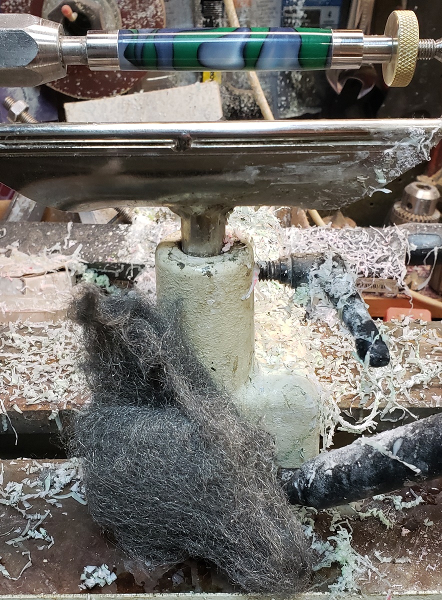

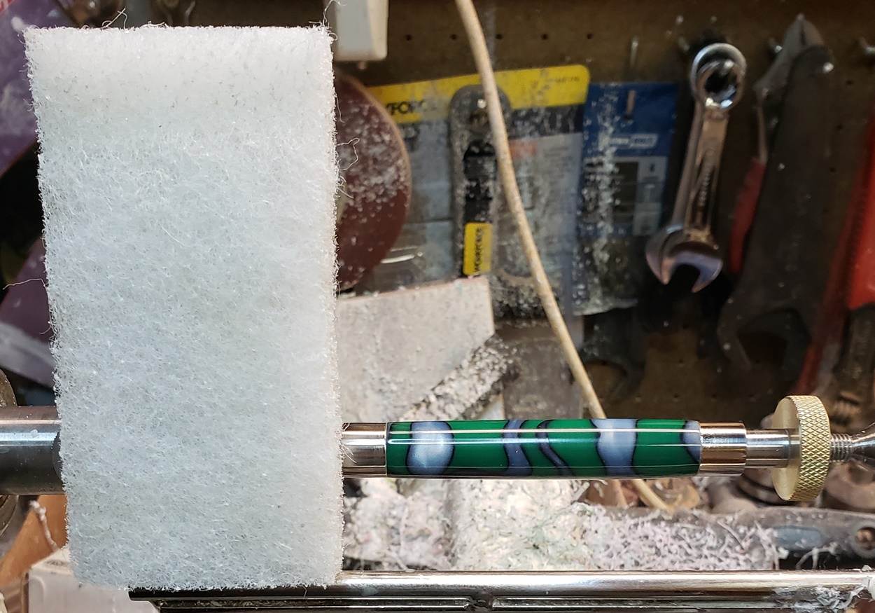

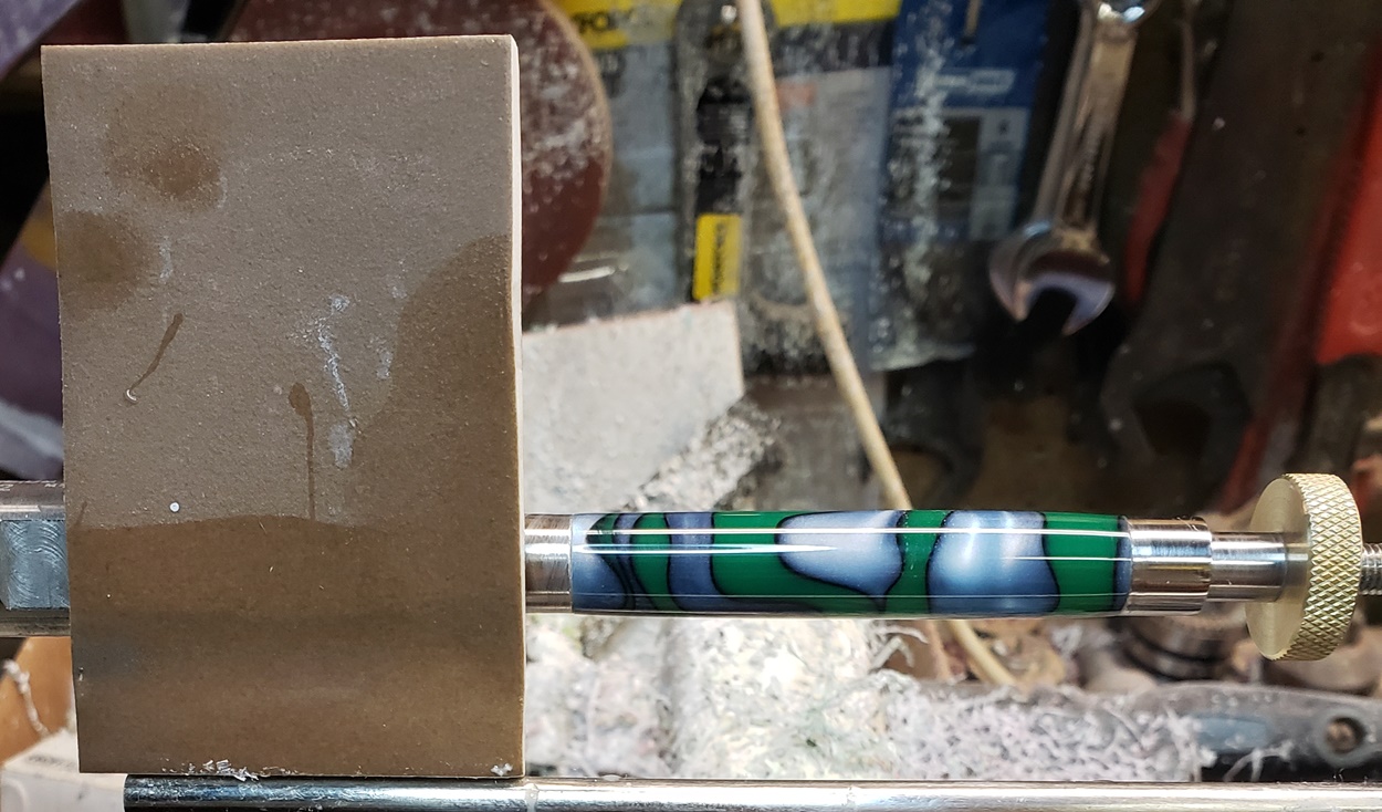

So then I tried MicroMesh 1500 only. That didn't do it. I tried 0000 steel wool, which has worked for me in the past. But it left visible scratches.

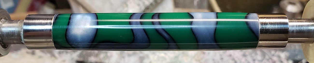

So I hit it with MicroMesh 1500 again, then tried 3M synthetic steel wool, which is supposedly the equivalent of 0000. No scratches, but still not the matte finish I'm looking for. I'm at my wits' end. Does anybody have any ideas? Is there a polishing compound that might work? Maybe a wax?

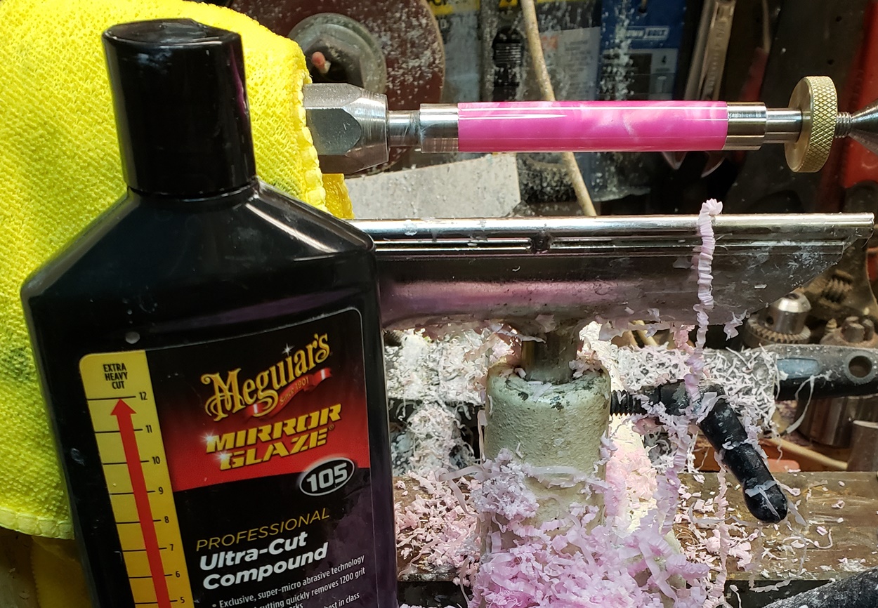

My inclination would have been to use a "coarse" Meguiar's automotive "cut polish".

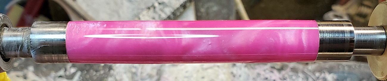

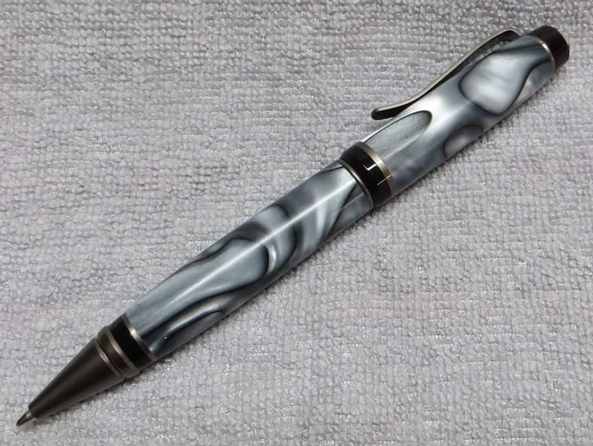

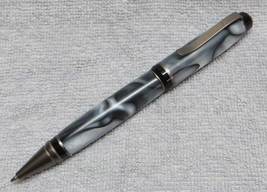

I have Meguiar's 105, which is a "cut" polish. But it's pretty glossy. 600 is a possibility, but still not as matte as I want. I can't figure it out. I've had good results in the past with 0000 steel wool. That's what I used on the Cigar pen below.

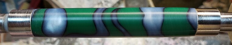

That cigar pen is nicely done ... and nicely matte.

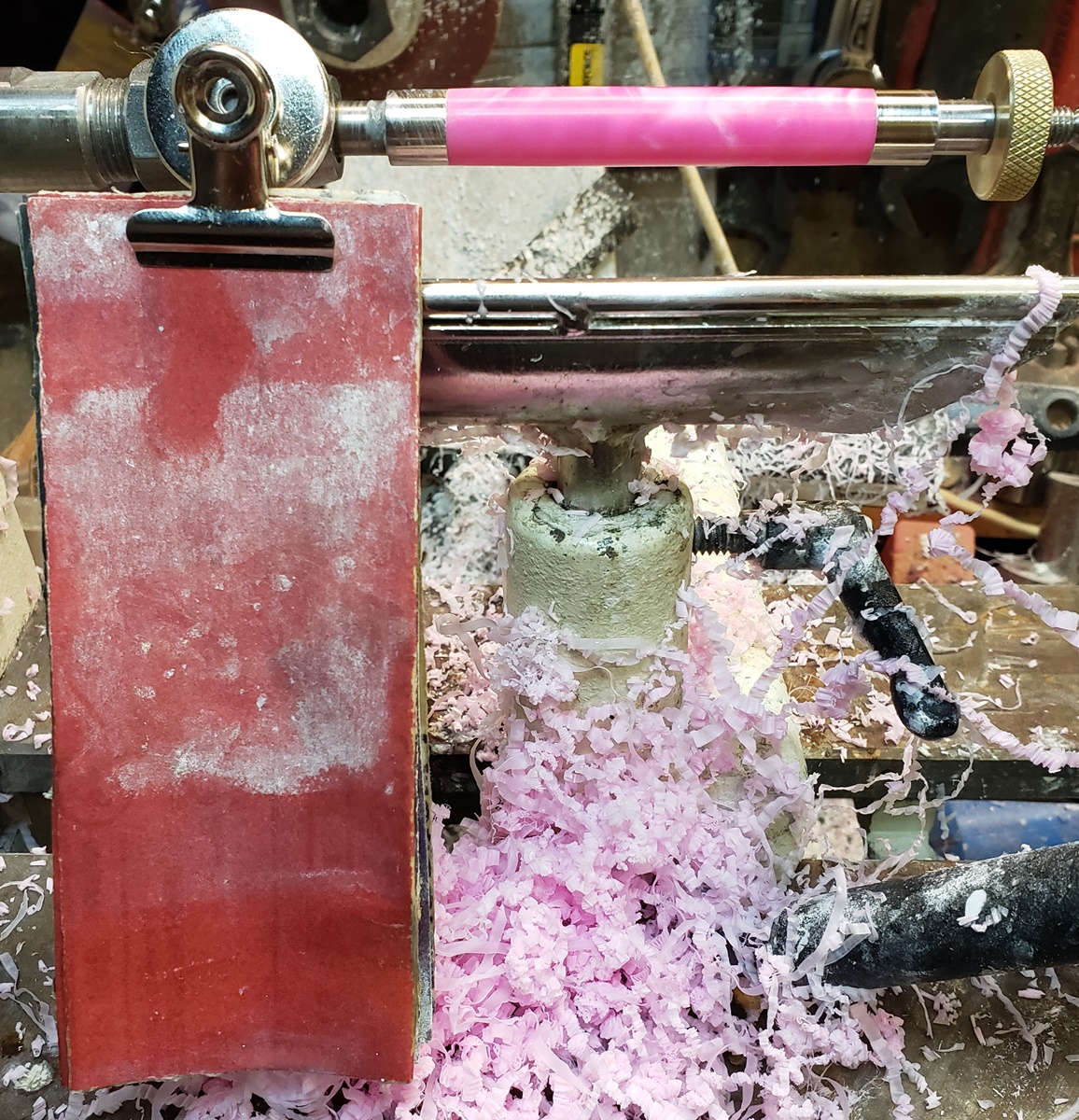

When I do the "finishing" of blanks on my lathe I keep the lathe power off. . I rotate the headstock chuck by hand.
And I use only lengthwise strokes with fairly light pressure.
With acrylics, after turning to a smooth surface with round carbide cutter, I sand with 240, 320, 400, 600, (maybe 800), at which point the surface is looking pretty nice but is still matte.
Then I usually use Meguiar's cut polish (but sometimes omit that), and then use Novus 3 followed by Novus 2 and finally PlastX.
The surface is usually still quite matte after the Novus 3. . I get the same general results on AA acrylic, Rhino, and CA.
I have never noticed any significant variations in these results. . Sorry I cannot offer help specific to your problem of achieving matte.

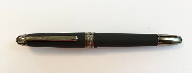

Frankly, and with all due respect, I don't think sandblasting is the way to go for a resin blank.
Well if Mont Blanc sandblast the resin body and cap of their Classique Ultra Black pens to get a matte finish then it should work for these blanks as well.

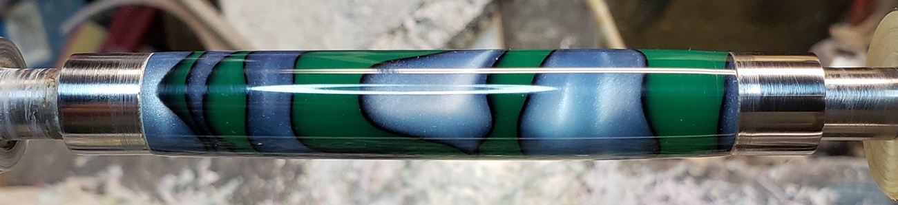

Back about 13 years ago, I posted a thread on "To Shine or Not To Shine".
That was with CA finishes but should work with cast blanks. However, what is an intuitive technique to one person is not intuitive to another.

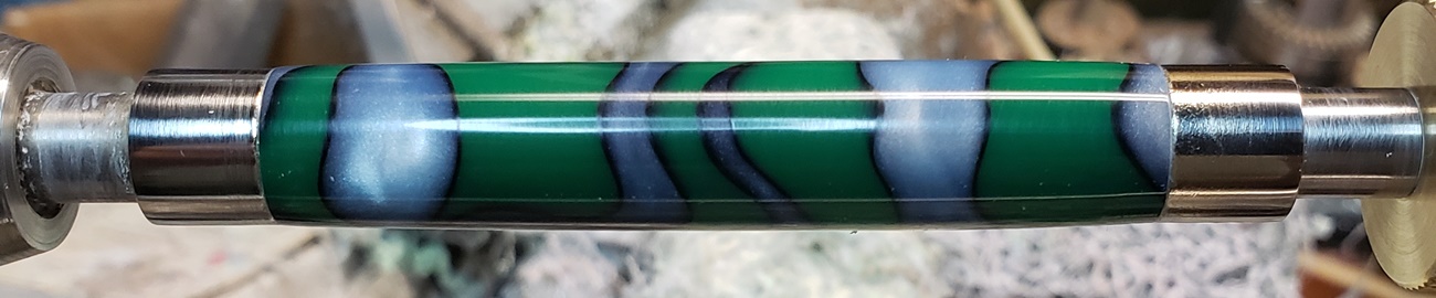

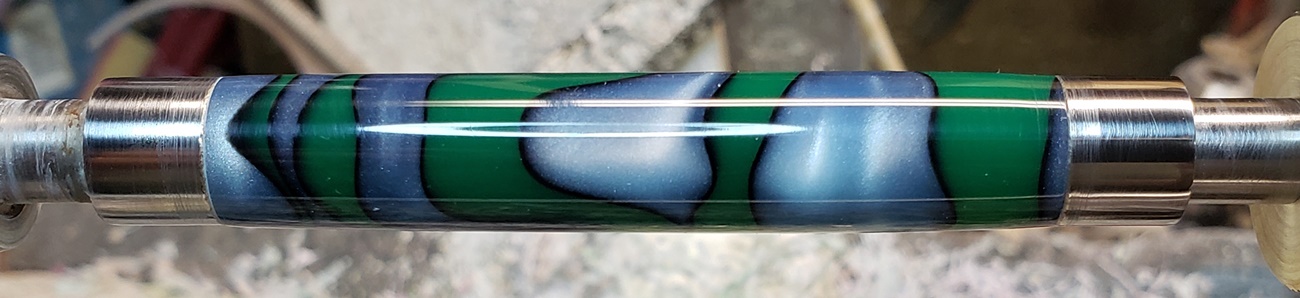

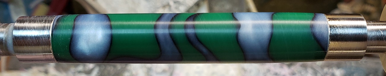

I can definitely see the difference in your two pens in your historical post. I tried 1500 MM, it it didn't make it very dull. In fact, it looks polished. I might try 600 sandpaper again, or maybe even 400 this time. I think 600 gave me the best results of all I've tried.

400 left visible scratches. 600 removed the scratches, but didn't leave it very matte. I'm about ready to give up and just polish the heck out of it. The pen has a satin finish, that will have to be good enough.

Here is the Tri-M-Ite and 600 together. I wanted to really compare them. There is more of a difference than I thought.
