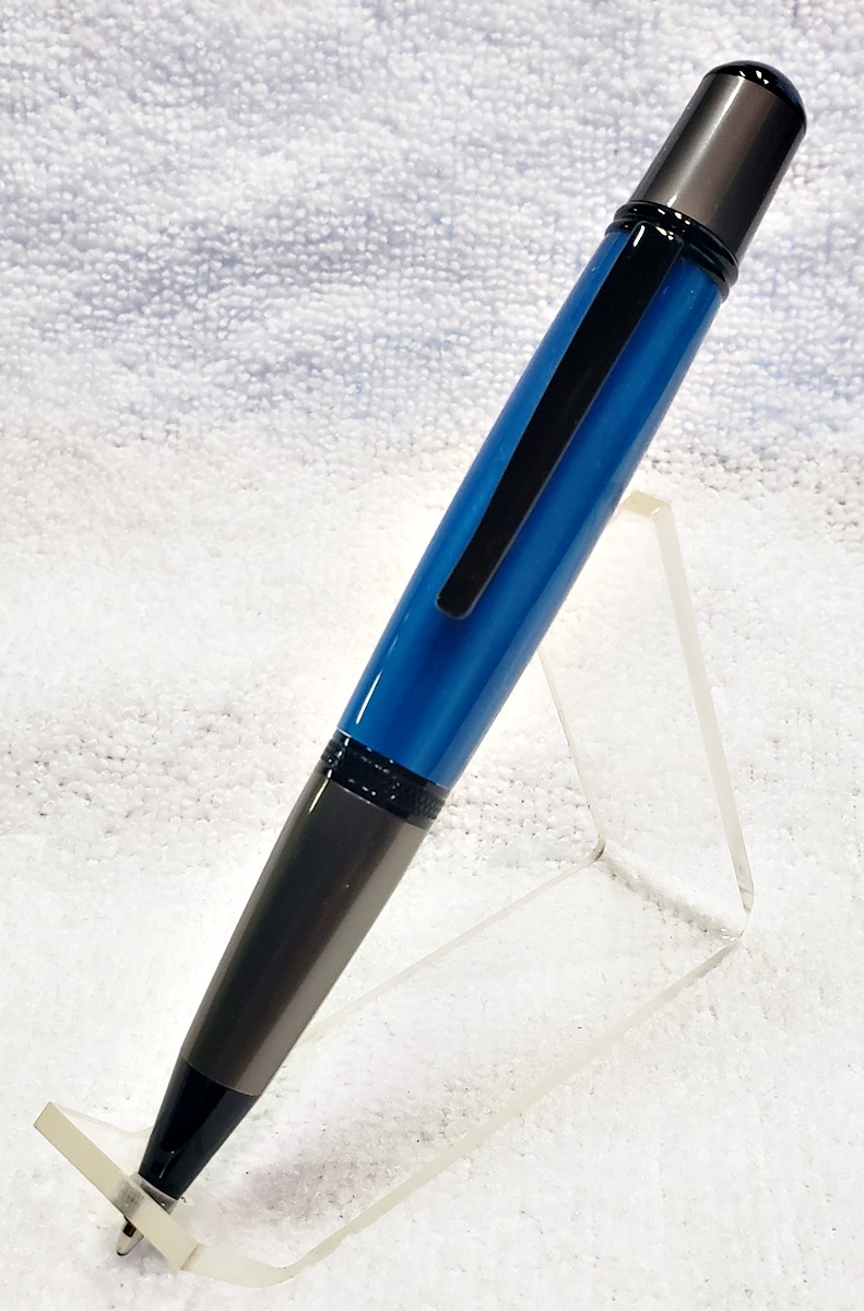

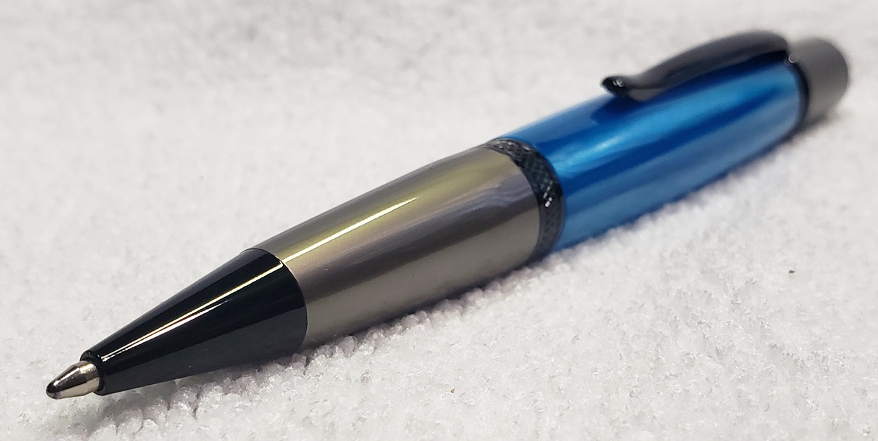

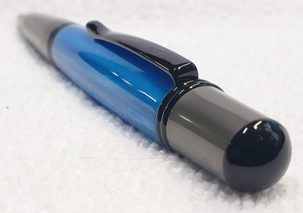

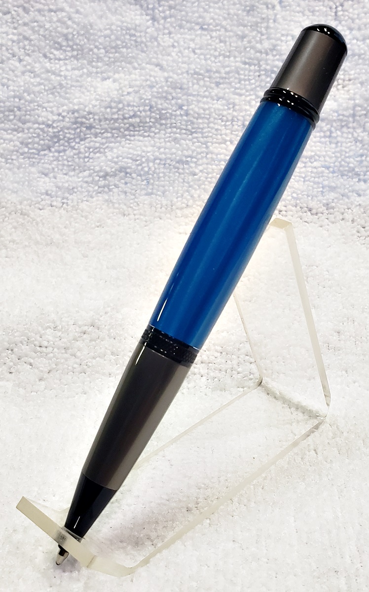

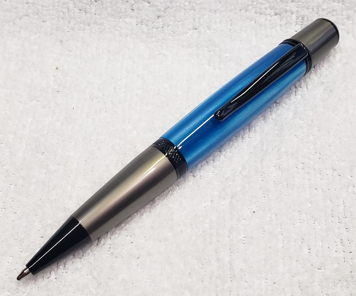

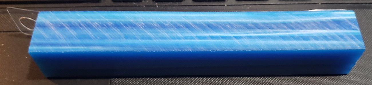

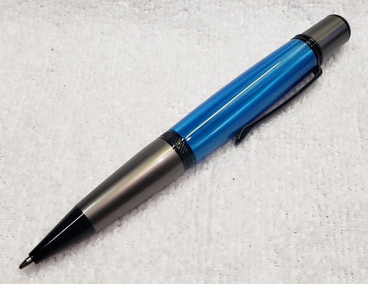

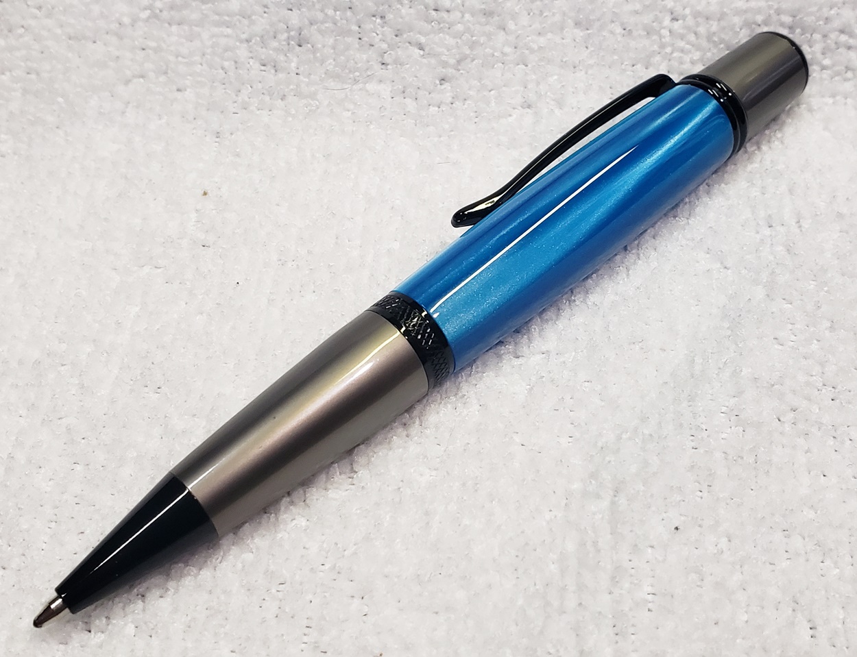

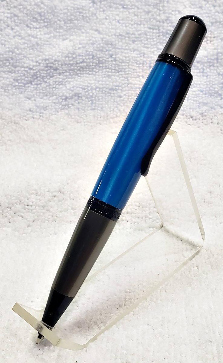

Okay, I REALLY like this one! The blank is called "Moonlit Ocean", and it's appropriately named. I love the colors and patterns. It turned easily and polished nicely. I'm also pleased with the kit I paired it with. It's a Wall Street III in satin black and black chrome. The Wall Street III uses a 27/64" tube like the Wall Street II, but it's a larger diameter. It's probably a Sierra Vista from Berea. The blank and kit are from Woodcraft. I'm very, very happy with how it turned out!

I just took it apart to see where to put the oil, and it doesn't squeak with the body off of it. So it must be the brass tube rubbing on the mechanism somewhere. I'll put some Renaissance Wax on it and see if that helps.

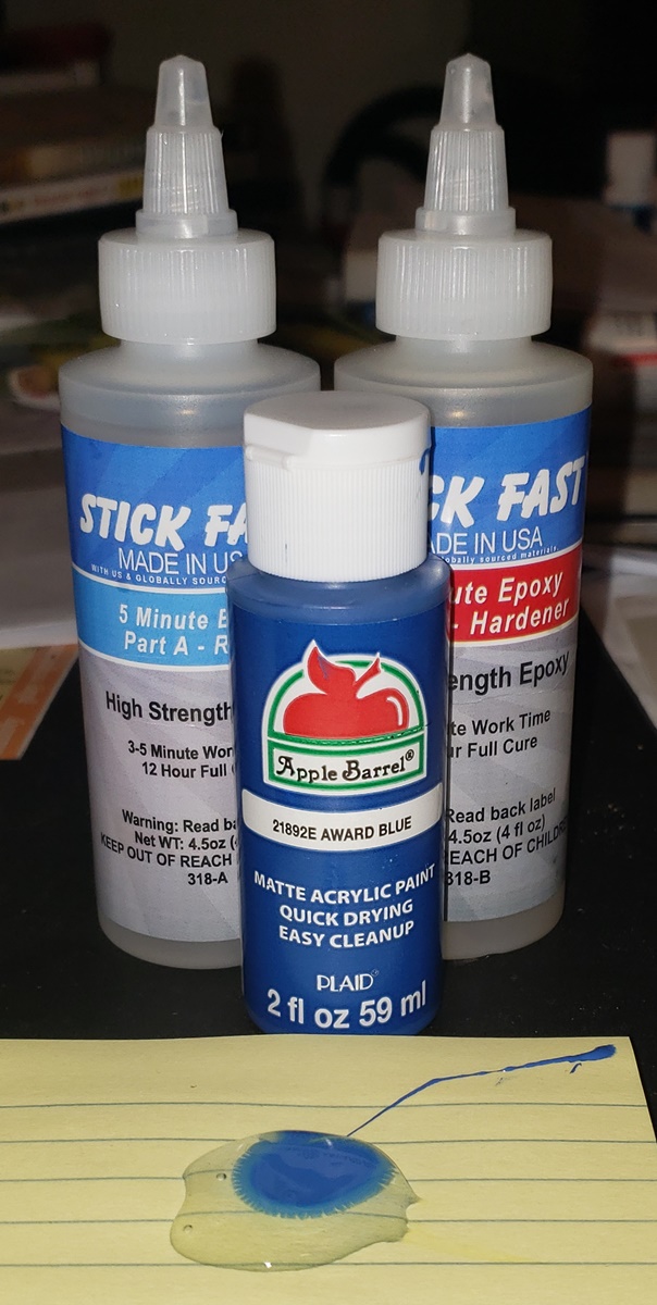

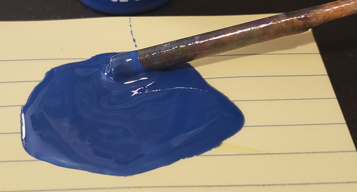

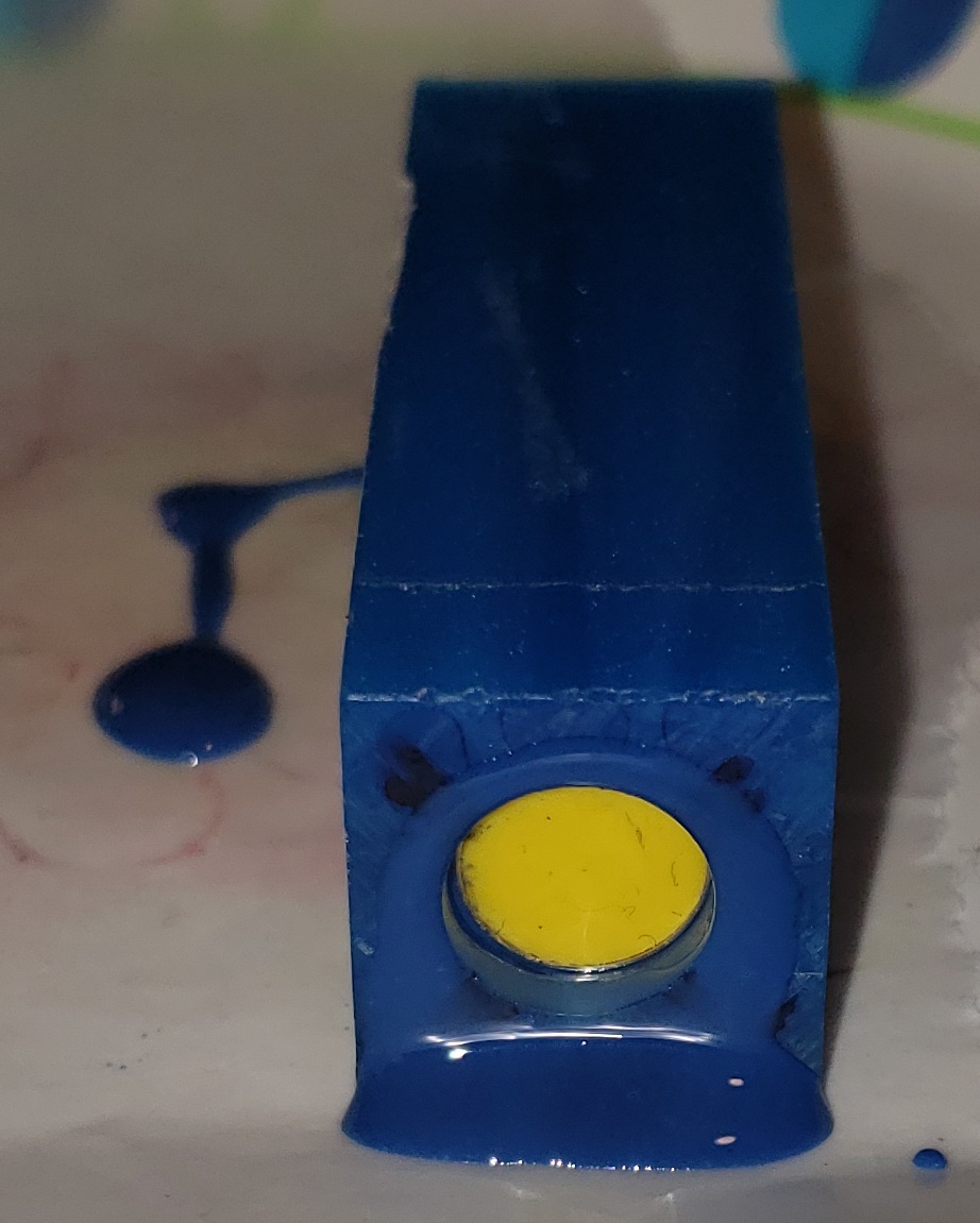

Do you reverse paint the blank or paint the tube?
Neither. All I did was color the epoxy. Since the body is thicker on the Wall Street III, I took a chance that the blank was opaque enough. And it was.
