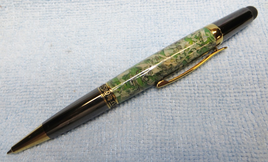

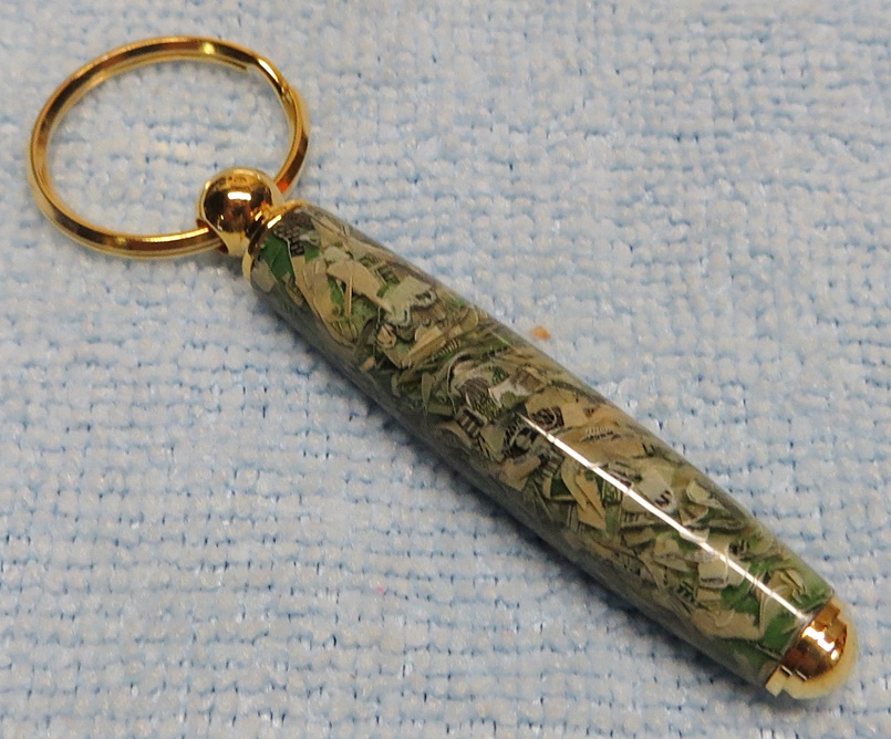

A while back I made a pen for my friend Hanna, with an inlace acrylester "money" blank. It's a cool blank, it has shredded U.S. currency embedded in clear resin. The problem is, acrylester blanks are very brittle, and I've always had problems turning them. But I was able to get the pen turned, and it turned out pretty nice, if I do say so myself.

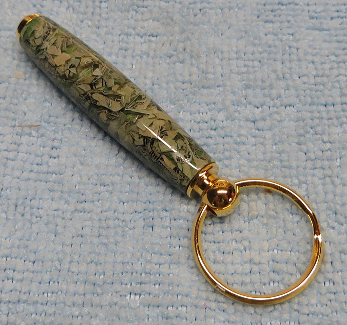

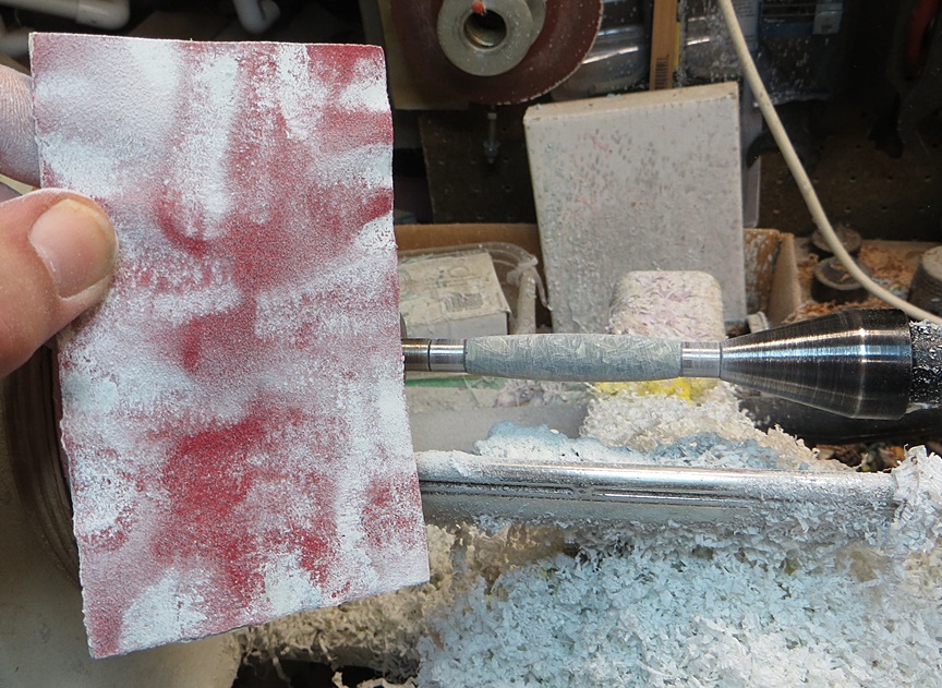

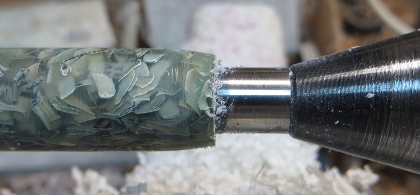

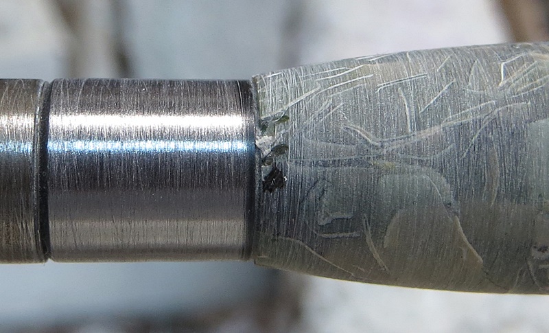

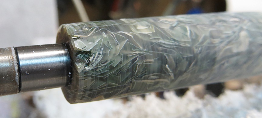

Well, Hanna collects keyrings, and I ran across an old 10+ year old kit I had. I had a big enough piece of the money blank leftover from the pen to use for the keyring. I decided to give it a go, I thought it would be easier since it was so much shorter. Ha! I should have known! As with the pen, I tried several gouges, a carbide cutter, and even a coarse crosscut file. Also as before, I had the greatest success shaping it with dry 120 grit sandpaper.

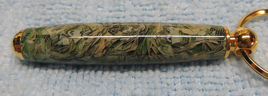

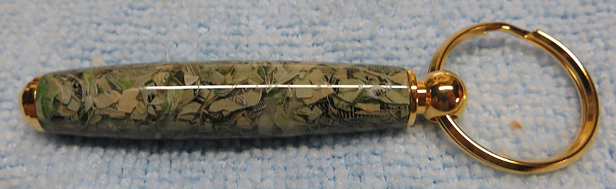

With some patience ad perseverance (I have no idea where the patience came from), I was able to get it done. Even though it turned out pretty nice, it'll be a long time before I try inlace acrylester again. But in the end, Hanna is worth it. She's a great friend.
