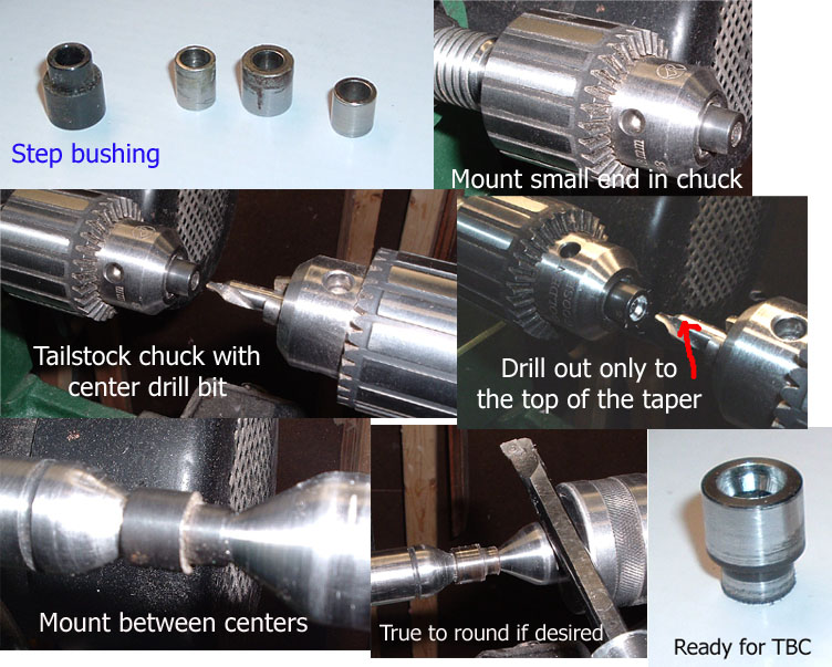

I just did this to show one process of getting this to work.
This is by no means the best way or the only way.
I make my own bushings out of brass so I never use or order the standard bushings anymore. This is one I had around and may have used early on because I started out with a mandrel. The 3-piece set is for a roadster kit and cannot be modified because the tubes are 7mm and the bushings are used for sizing only and do not fit inside the tube. It must be a stepped bushing. Also, this could also be done using pin jaws on a scroll chuck to hold the bushing as I realize not everyone has 2 MT drill chucks.
When you drill out the bushing, the lathe may squeal and complain. Mine did because this is an operation not intended for a wood lathe.
This could also be done on a 'good' drill press, but mine is not!
Finally, I turned the larger section down just enough to take off the black oxide and to determine that the bushing is running true. The small section that fits inside the tube should not be turned down unless it appears to be out of round. I turned this one a little on the end just to check it.
For turning the steel bushing, I use a tool holder and metal cutting carbide bit. I have in the past used HSS tools but it is not recommended and it is dangerous.:eek:
It should be noted that these bushings are made to fit only a short way into the tube and get their support from the mandrel. The ones I make and the ones made out of steel for this purpose are about 3 times as long on the part that slides into the tube.
Got questions, I'll try to answer them.

my first question is, they are TBC, but they must have the support of a mandrel? I think I must have missed something.
My second question, do the brass bushings transfer any discolorations to the end of the blanks when finishing?
Thanks.
This bushing was intended for use on a mandrel. Since the pen kit tube it is used for is larger than the 7mm mandrel, this creates the step between the large tube and the mandrel.
What I am showing is how the same bushing can be drilled out to be used on the 60 degree TBC center.
A bushing modified in this manner must be mounted in a collet to be accurate. I know of no Jacobs style or three jaw chuck that is accurate enough to keep the bushing concentric.
Well, mine are. As I mentioned above, when I put the bushing between centers and took off just a small amount from the OD, it took off the same amount all the way around. That tells me it is drilled dead center.
...It should be noted that these bushings are made to fit only a short way into the tube and get their support from the mandrel. The ones I make and the ones made out of steel for this purpose are about 3 times as long on the part that slides into the tube.

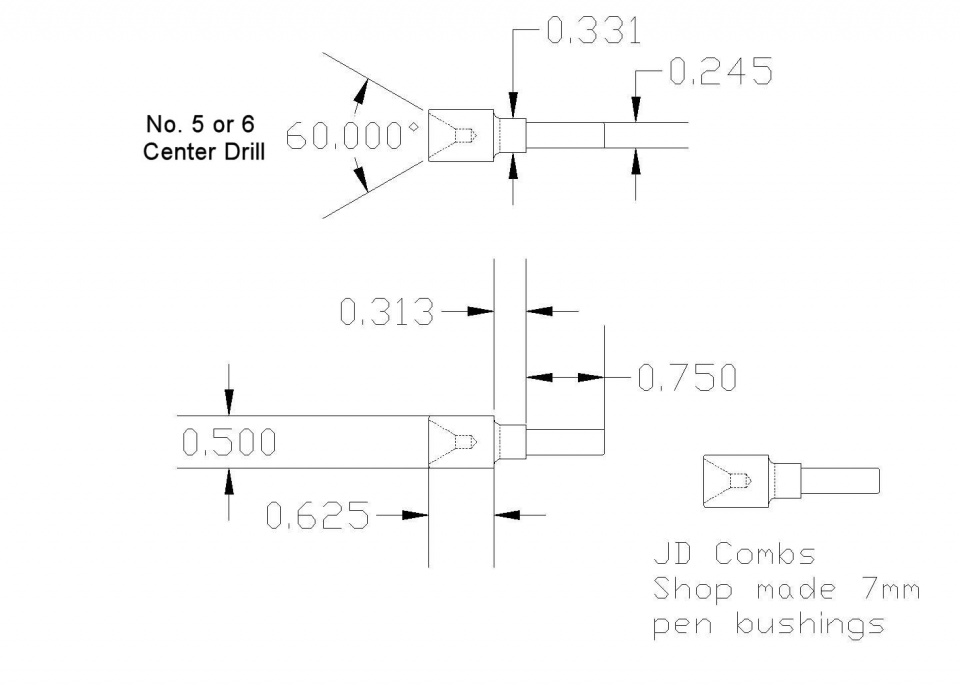

Here is an example of my 7mm TBC bushings in sketch form. Note how long the part is that goes inside the brass tube.
Anyone and everyone is welcome to duplicate them if they like.
Edit: Only the top sketch shows critical dimensions and should kept as close as possible to indicated values. Dimensions on the bottom sketch could vary by a 1/16" and not hurt anything.
ONLY
Interesting JD. Is the center step used for OD reference instead of the larger OD?
I had not thought of that. And there seems to be a chamfer where the end of the tube rests. You probably don't use these for finishing then.
My BAD. You are correct. I did a quick read and you did exactly right
View attachment 127156>
ONLY
Thanks for the drawings. I have to make mine .495 OD. I have lots of .500 material and need to clean it up. The drawings are great. I'm not very good with CAD. I'm an old, slow learner.
Hi Allen, yes the center step is the typical diameter(the 0.331) of SL-7mm bushings. No chamfer, any chamfer you might see at your indicated point is unintended and probably just screen resolution or something. I do chamfer most outside corners though. No, not for finishing. I do not use these nor any of my bushings for finishing. I have a shop made set of cone shaped universal UHMW bushings for finishing. I will put a pic of them in one of these posts sometime if you are interested.

JD, I see my error. There is a chamfer(maybe I'm naming it wrong) between the middle and largest ODs and I confused that with where the tube sets.

Thanks for commenting Dale. It would actually be a "fillet" when in an inside corner like that but yes that is just the transition from the critical 0.331 surface to the non-critical 0.5" original rod diameter surface and it could be most anything from square corner to convex, I chose concave.
