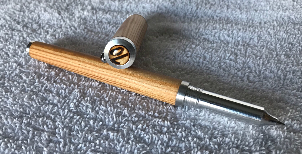

My Wife wanted pens for her advisory board. She always gives them Indiana themed items as they come from other states.
5 modified aluminum RAW kits with southern yellow pine barn wood. The blanks were stabilized and finished with CA, sanded to 400 for a matte finish. Monogrammed finials. Comments, criticism and questions welcome.

How did you put the wood on the cap ? . Did you machine down the aluminum?
Great Pens and I really like the box lid idea and execution. When you say modified you weren't kidding. Did you make the entire cap or heavily modify the existing one? Which clip did you use? What were the thread size for the cap? Very impressive work!

I would love to see pics of the parts, please .
What thickness would the wood be in the cap ?

On the cap - I've only used the threaded portion. I turn it down as thin as possible and cut if off. Then epoxy it into the cap.
The clip is a "J" from Beaufort held in by a screw in finial. There is no tube in the cap.
If anyone wants to see pics of the parts I can take some tomorrow.

I am not a fan of the opened nib end of this kit. This is truly a personal opinion, and in no way reflects on your craftsmanship.
Closed, I love the overall appearance. Clean, neat, elegant. Well done.

Mark - I agree, the nib and connector are a little crude. Someone (?) posted a couple of closed end versions not long ago with contoured nibs, so there is enough meat there for refinement.
Mal, Here are the pics. I don't work from detail drawings but I was concerned about thickness enough to do one on the cap (w/o dims). That's when I added the ring to support the thinnest section of the cap. The sketch was used for drilling reference. The 5/16 aluminum tube was used in place of the stock brass to make the shape better and allow for threading.
