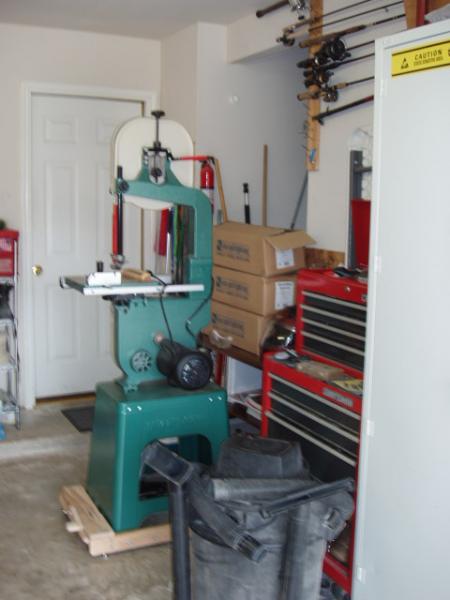

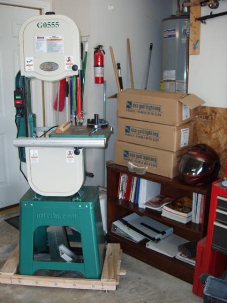

I built my own out of 1"x4" maple and 2" angle iron. It has fixed casters on on end and swivel casters on the other that are mounted on a pivoting board that opperates with a cam lever.
I have 3 of these in my shop right now for various power tools and need to build a couple more.
When not on the swivel casters, it sits on adjustable glide feet. Like in this picture:
A better pic....

byounghusand - nice mobile base. I just bought the same bandsaw and have been scratching my head about a mobile base - the one you built looks good. Do you have plans or is there a site where you got the idea/plans? Thanks

I can scan them and send them to you... I will have to find them in the shop.... :confused:
They are out of an old issue of Wood Magazine (IIRC :rolleyes: )

byounghusband
Oct 27, 2005
834
Celina, Texas, USA.
No reason, I suppose... Maybe one lever as opposed to two.... I dunno :biggrin:
That was the plans I found and it works for me.
I modified the plans I had slightly based on availability and ease of the build. So adaptatins are good.
