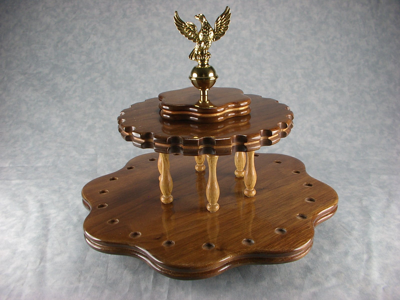

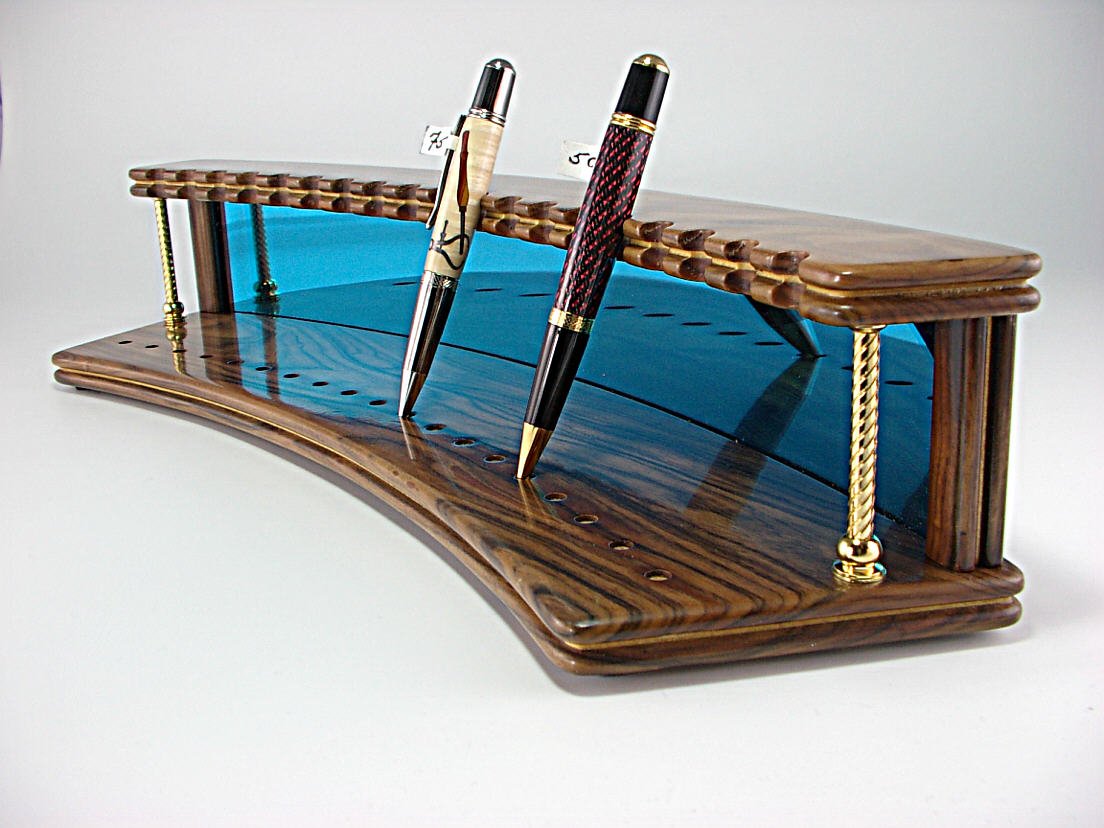

Have not checked lately but when I was buying the sheets instead of the pads I use to buy from https://micro-surface.com/micro-mesh-types/ I still use the sheets when I do a project that I use lemon oil as the finish on top of an exotic. brings to a super sheen but not too glossy. That is what is needed in flat work. Example.
