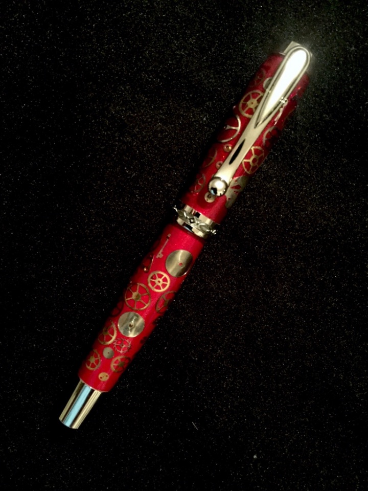

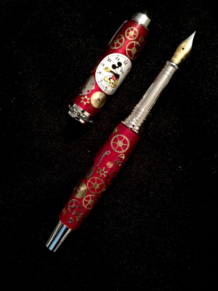

A Christmas gift for a dear friend commissioned by his wife. The blank was made by Blanks by Sweet Cheeks. She does amazing work!
The pen kit is a Jr Statesman in Rhodium and Blank Titanium.
Cheers,
Danny

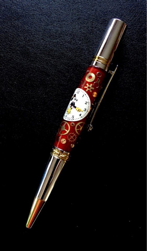

Michelle does great work and was very nice to deal with. Here is the matching blank on a Majestic Squire.

I would buy some inexpensive acrylic blanks to practice with first. It's not difficult but different. The epoxy used to cast these will be a little softer than acrylic, so light cuts as you get close to the final size. You will also need micro mesh pads or equivalent to polish to a clear finish. I also finish on the buffer after wet sanding through 12,000 grit.
