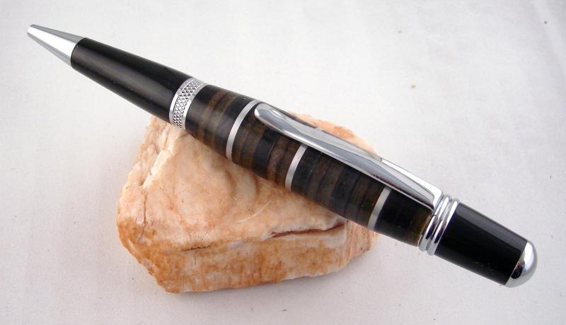

Offering a suggestion: I combined two very different materials together to make this pen a few months ago. The aluminum came from a Lowes metal selection rack, and was from a 1" x 36" strap piece. This aluminum is a pretty soft temper and was fairly easy to cut along with the stabilized leather squares. I have also found that copper pipe compressed flat in a vise will also turn well. The one metal I have tried that was very difficult for me was brass, but I think it was too thick (3/32") and too tempered. The leather used came from an old belt.
