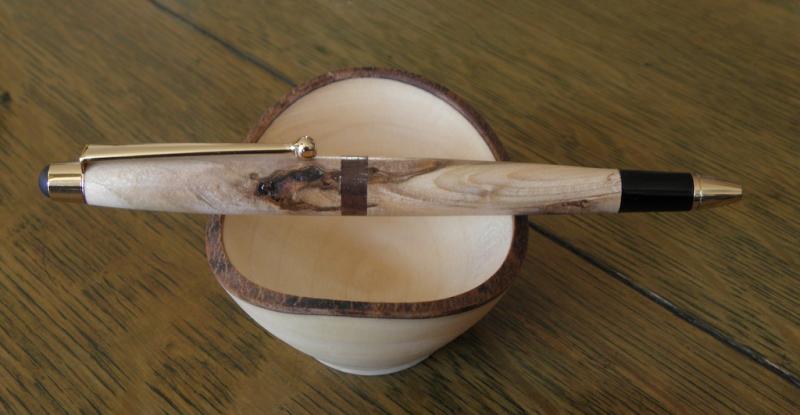

I made a small natural edge bowl a few months ago out of a silver maple branch, and I just happen to have taken a picture of it today with a pen made out of a different part of the same branch:
