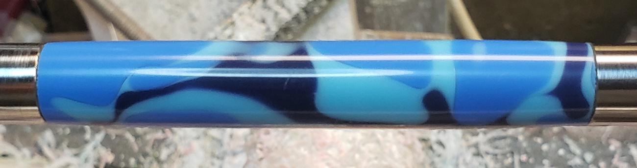

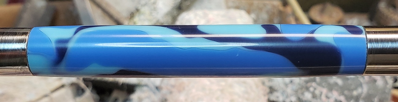

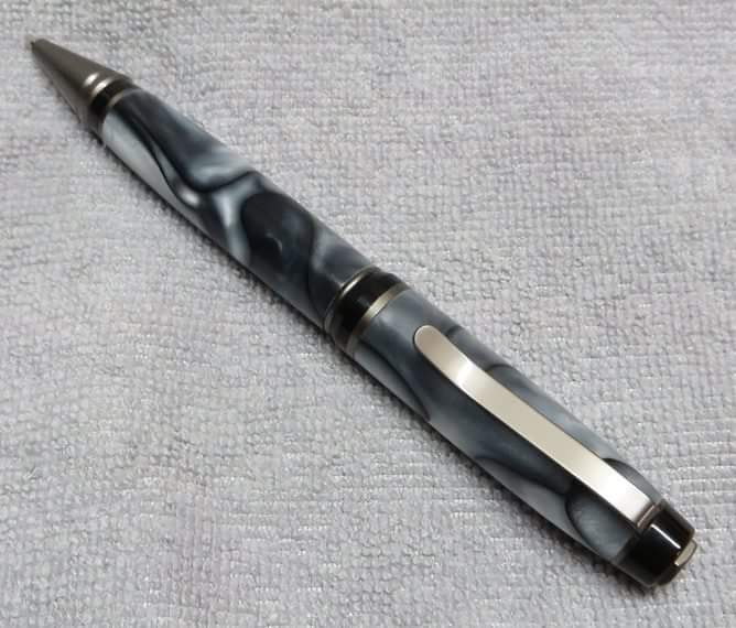

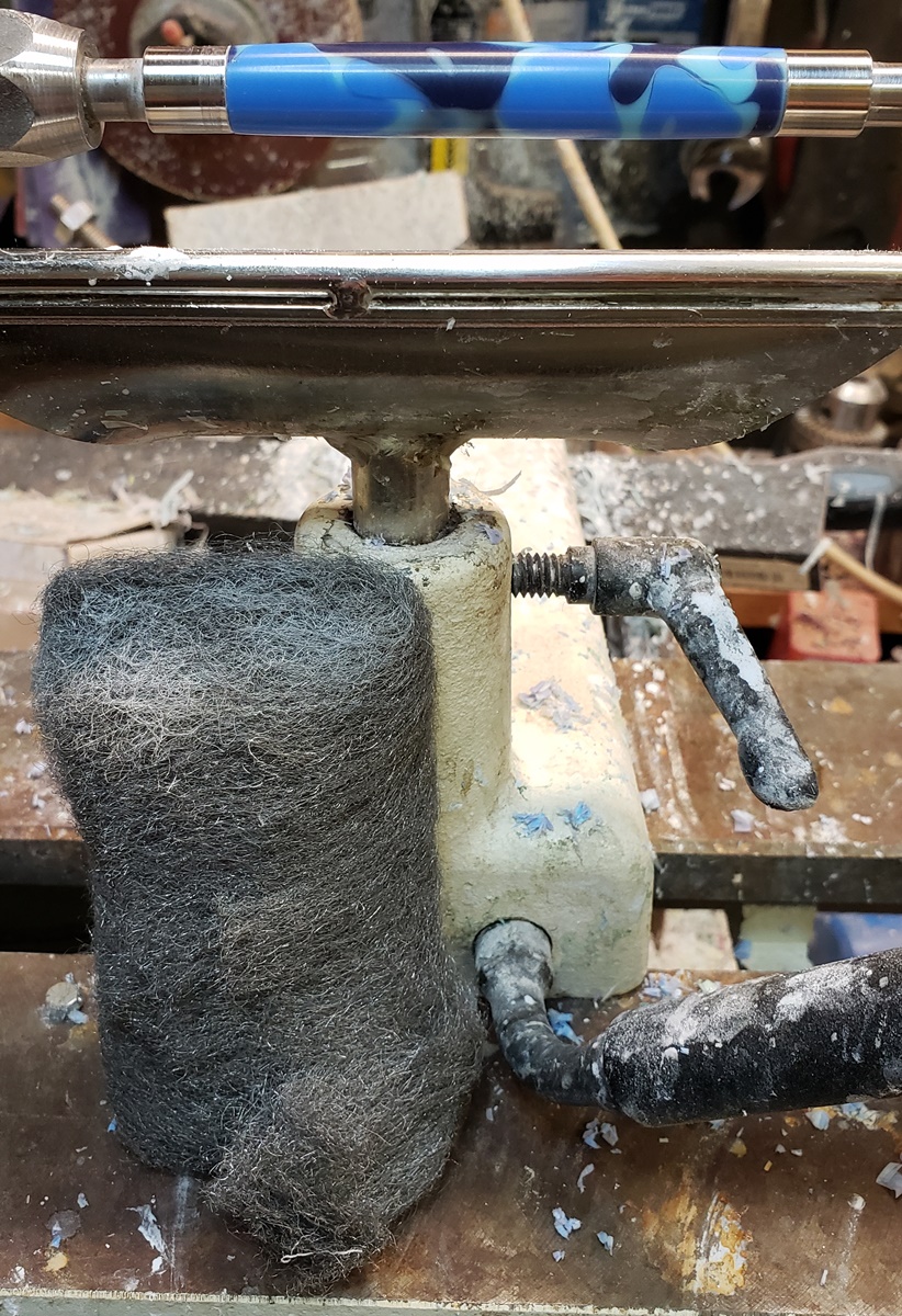

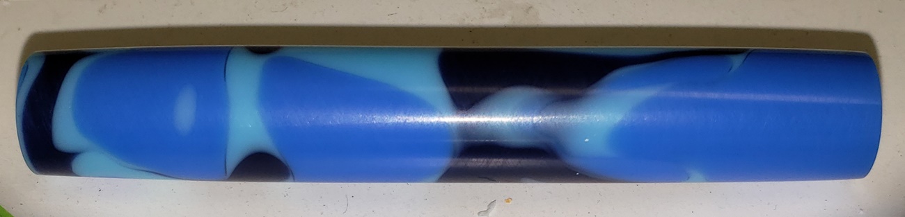

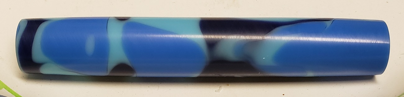

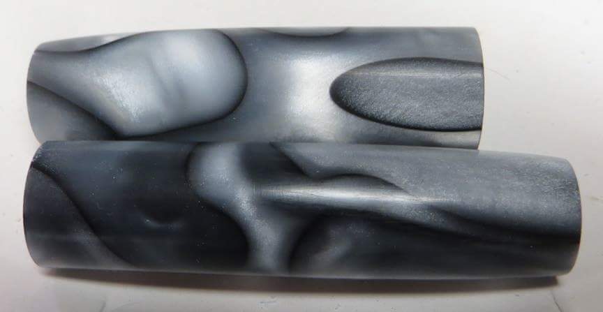

I have a friend who prefers a matte finish on pens. Which is annoying, considering all the time I've put into perfecting my finish! In the past, I've polished the bodies then hit them with 0000 steel wool to dull them. Worked pretty good. But for some reason, with this particular blank, i'm getting a lot of visible scratches. I've used the same technique, with different results. Anybody have any ideas?

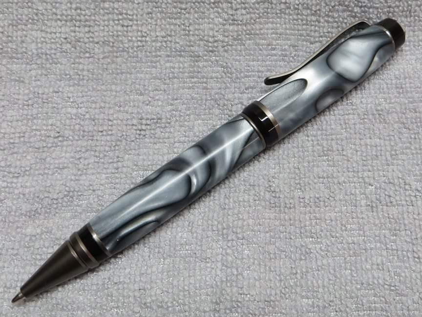

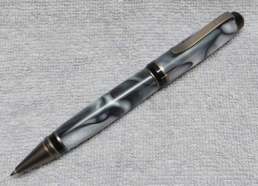

I normally sand with 3m wet/dry sandpaper (I wet sand at pretty high rpm, if you go dry then lower rpm to avoid heat). I find that 800-1000 grit show visible scratches, 1500-2000 are pretty reasonable for matte finish, 3000 is probably close to your silver cigar (a little bit shiny). I never leave a matte finish (yuk! 🤮) but just something that I've noticed while going through the grits. I don't do a lot of acrylics, but from what I recall they tend to be similar. Just be careful if you go with high rpm wet sanding, once you get a slurry going you can remove material pretty fast, leading to the blank being undersized final diameter.

My gut is steel wool scratched the surface.

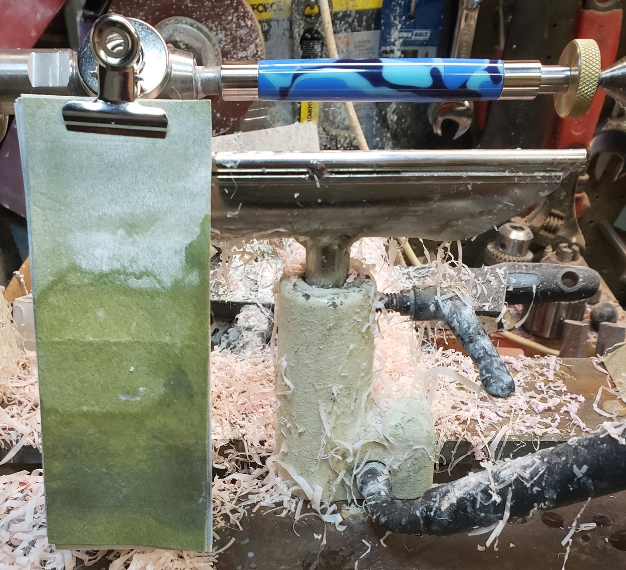

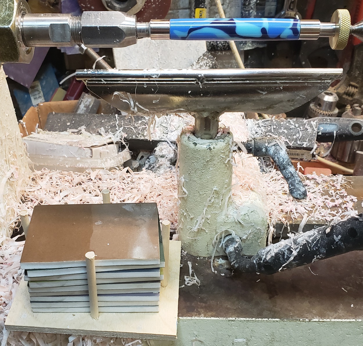

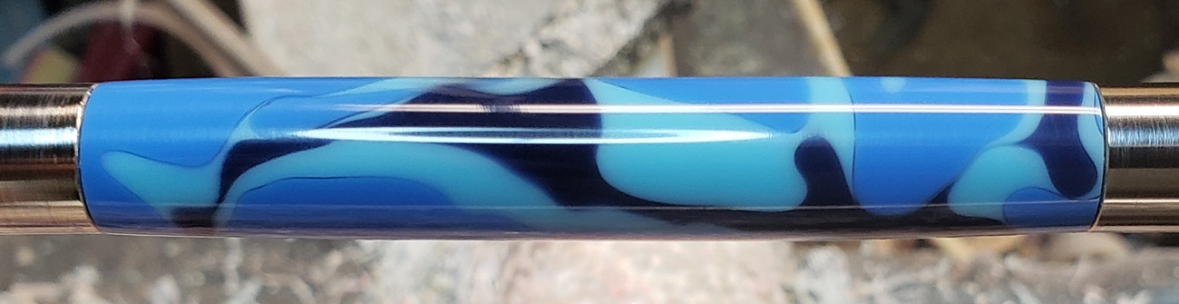

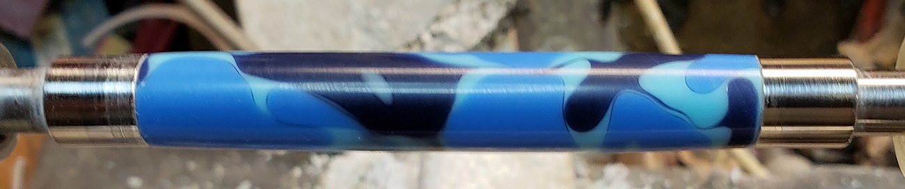

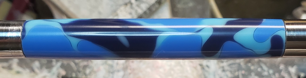

I repolished it with 3M Tri-M-Ite, then used Micro Mesh wet "backwards". It's slightly more dull, but no scratches visible to the naked eye.

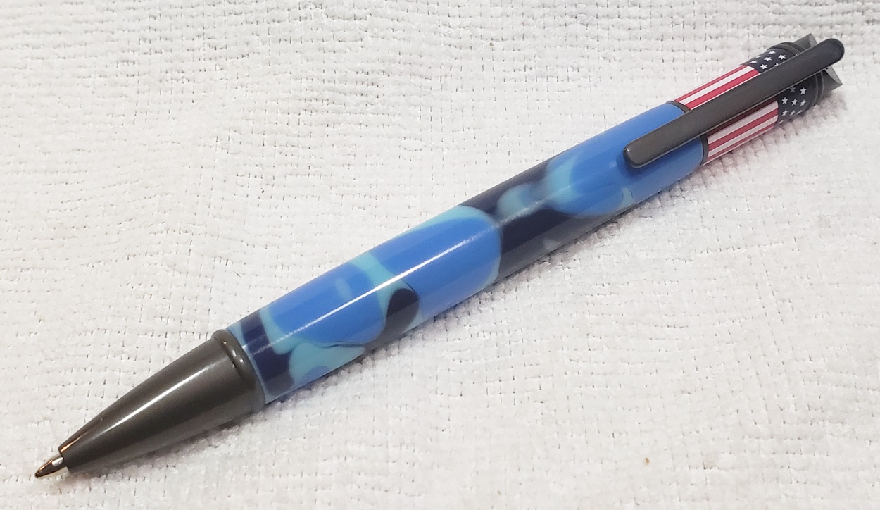

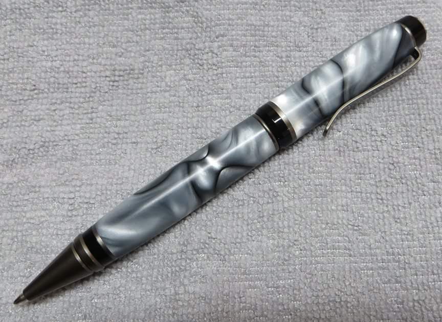

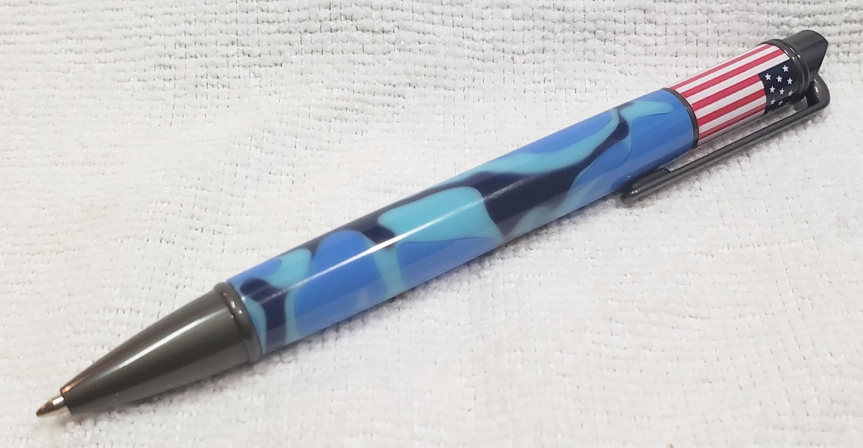

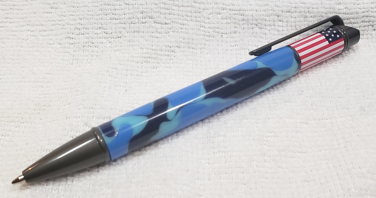

It's not as matte as I've achieved in the past, but I think you're right. This is as matte as this blank is going to get. The pen is an American Beauty in satin gun metal.
