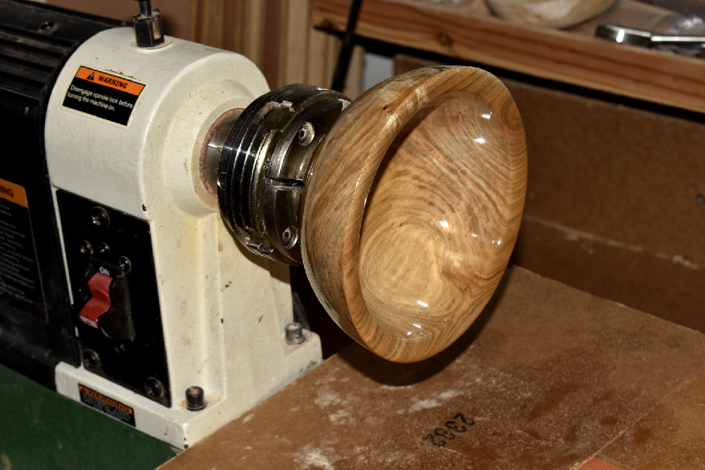

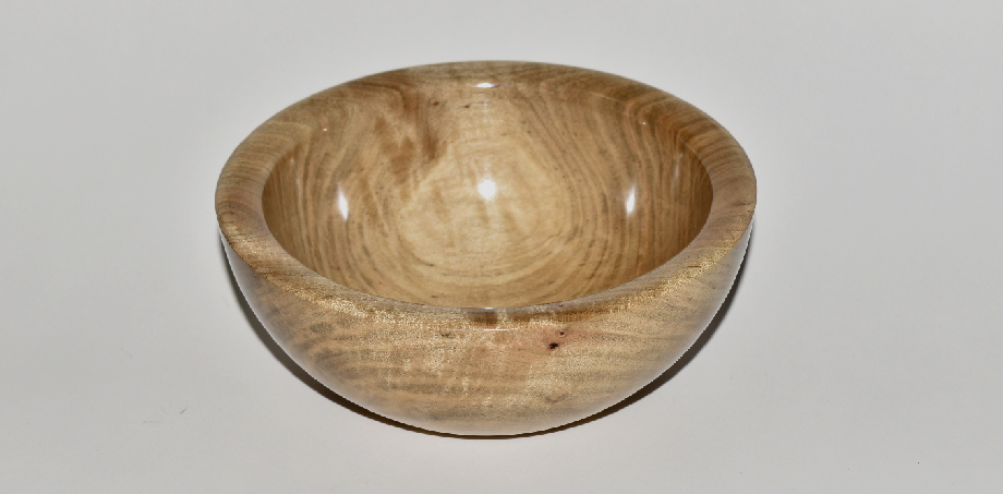

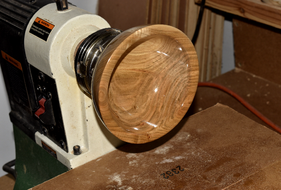

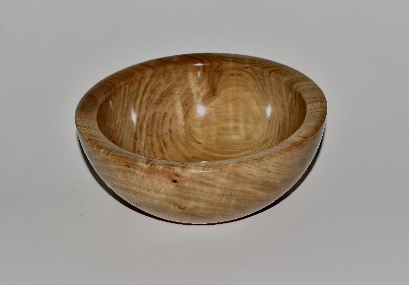

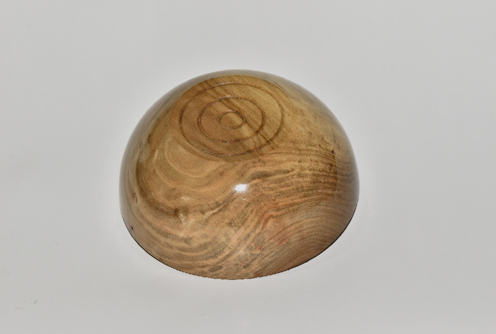

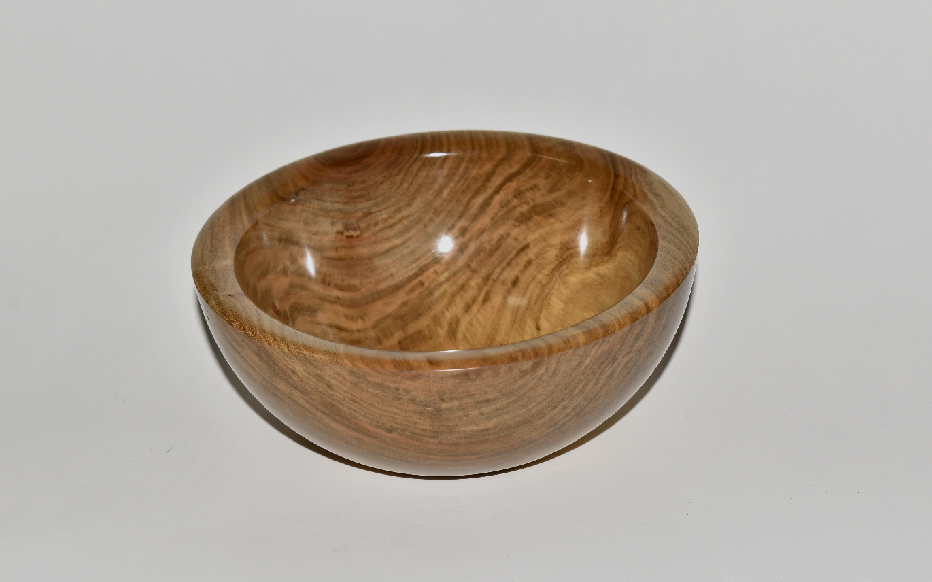

Maple bowl, 5 1/2" x 2" This guy has a lot of chatoyance! Really hard to a good photo. The thing is just glimmering. Just slightly moving the bowl the grain moves and changes color and glimmer... like it is 3D.
Ten coats of Friction Polish. (Boiled Linseed Oil/Shellac/DeNatured Alcohol.)

You can kinda see it in the photos where it is still mounted on the lathe.
