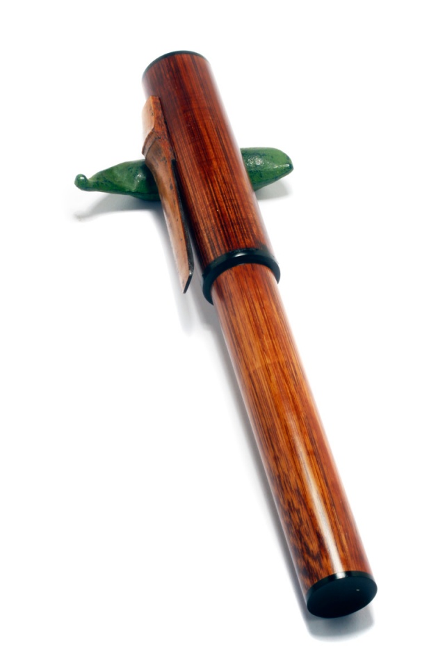

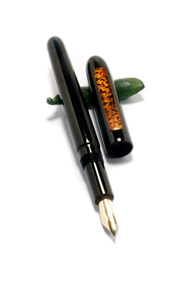

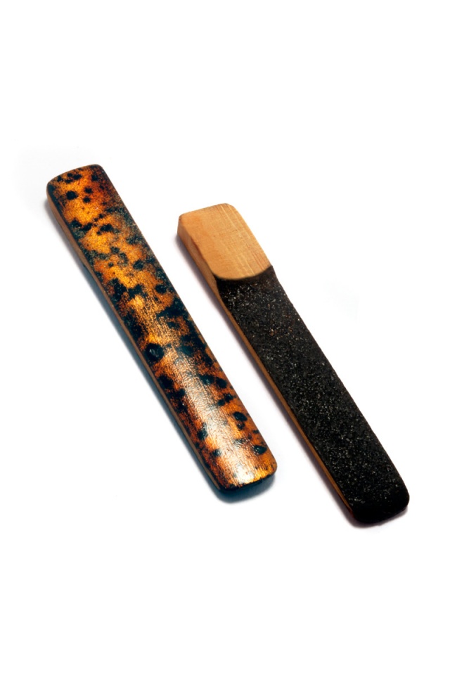

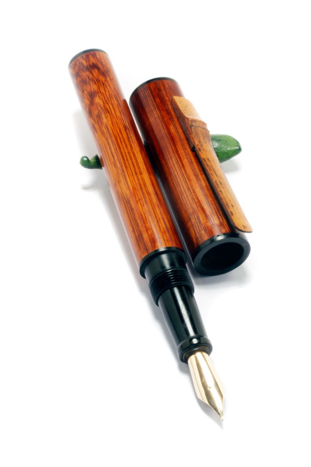

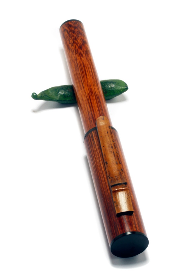

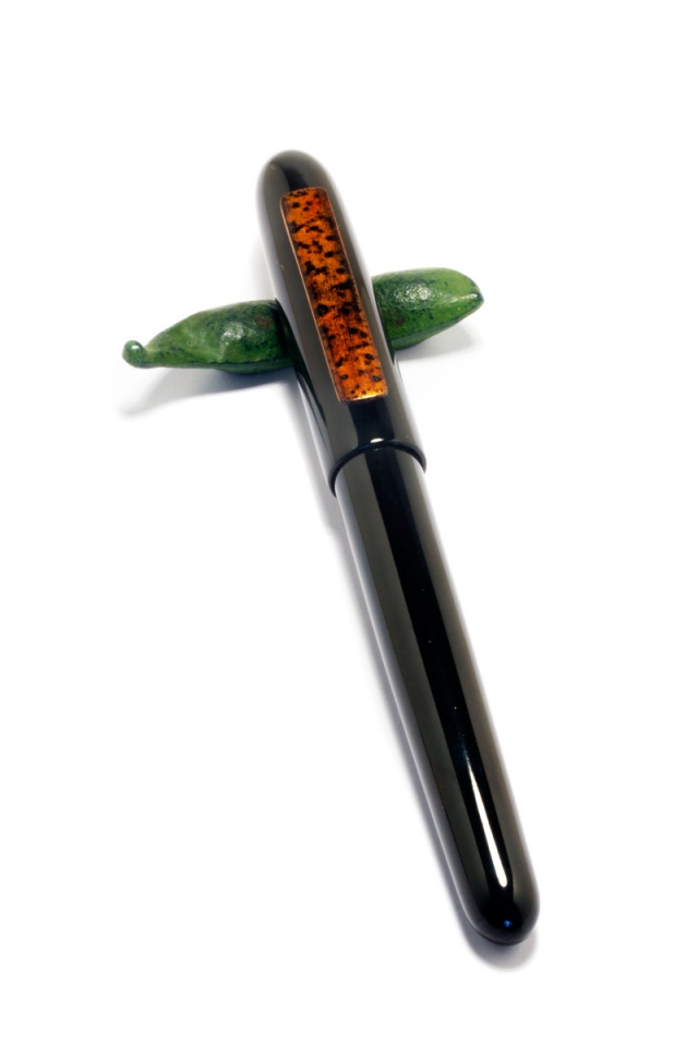

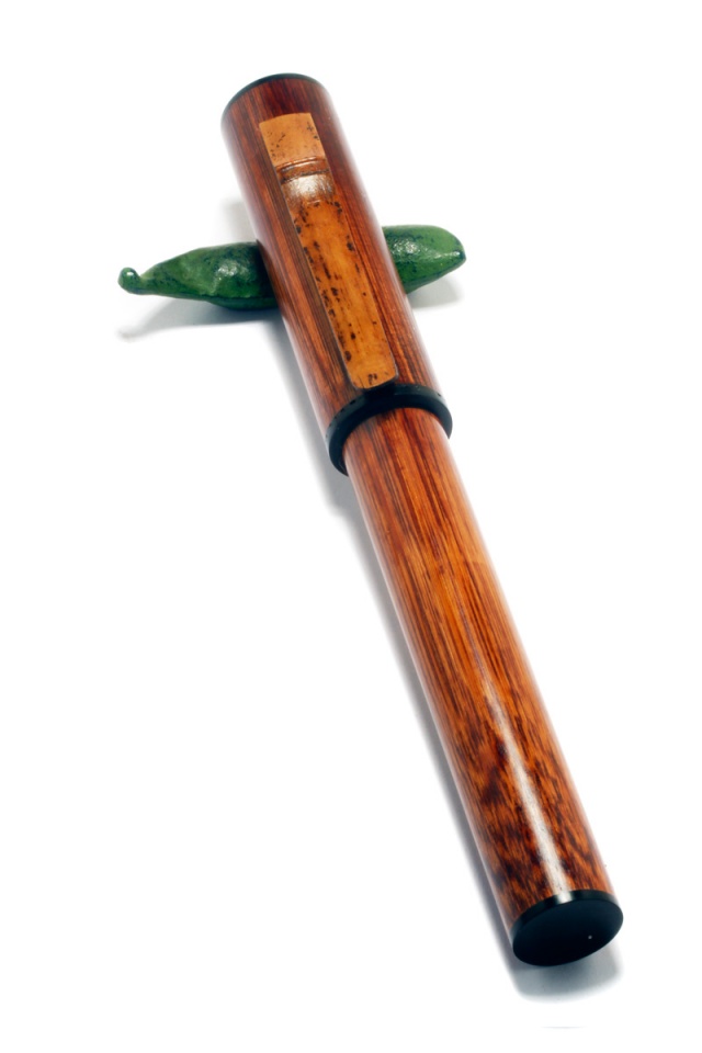

Since I started making pens I was thinking about a clip concept that matches the Urushi Lacquer pens.
Lately I had the idea why not using bamboo. Bamboo is extremely durable, hard and also flexible.
This pen shows the first Bamboo Clip. The concept is not perfect yet and has to be refined also for lacquer pens
Best regards,
Martin

Bamboo clip looks great...provides a nice organic sense to the pen. It seems that mounting a clip like this to the cap is a challenge due to the potential stresses that may be applied. Are you satisfied with the method of mounting the clip? Care to share details? Great work and fantastic result, as is your trademark!
Thank's for the encouraging comments.
I have mounted the clip with urushi lacquer.
Urushi lacquer is a very durable glue, used for mounting spear and arrow heads.
Urushi cannot be destroide by acit, oil or water and copes with temperatures up to 300 degree C. The surface size in contact (glued) with the cap is around 0.75 cm2 and I cannot imagin that it can fall off respectively be pulled off

What challenges do you face using bamboo for the body. Can you turn it? Or do you have to work it length wise?

The bamboo was carefully selected and drilled and filled with a Ebonite rod tat was glued in. To work with Urushi is definitely tricky and not easy but if one keeps the working place tidy there is no fear of rash and if, it is not killing you and the body get used to it with the time. I personally am immune to it.
