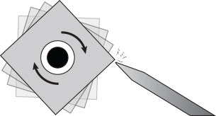

I can not improve on what Hank wrote. He's always clear and to the point.
And yet I'll chime in ;) since I've been thinking about this and have some half-made graphics laying around.
My experience is there's a relationship among the 3 factors Hank laid out: Tool Sharpness, Clamping Pressure, and Feed Rate.
If I'm deficient in one area I can usually get away by overcompensating in the other two categories. For instance:
1. My Tool is Dull
I can make it work if I really wrench down on the clamping pressure (not recommended) and take tiny bites on each pass (slow feed rate).
2. Too Little Clamping Pressure
Works (somewhat) if my tools are razor sharp and I take small bites.
3. Too Big a Bite
If my tools are sharp and I overdo the clamping I can bust through the wood.
Conclusion: Obviously it's a "false remedy" to apply too much pressure to the mandrel nut.
It's better to have sharp tools and make reasonable cuts for the wood density.
Overtightening too much, as you've noticed, bends the mandrel sooner rather than later.
My personal approach is to tighten it as little as needed after making sure my tools are sharp.
Lastly: I enjoyed turning much more after I ditched the nut and began using the mandrel saver folks above have mentioned. I'm a fan.
Best,
Cullen

Cullen,
Do you do illustrations for a living? WOW! Exceptional and Clear! THANKS!
I am going to reference this thread in the future!
Wmcullen
Dec 1, 2020
398
Fairfax, Virginia
Cullen,
Thanks Hank. I had these graphics mostly done already. It was going to be part of my April Fool's Mandrelorian post but it was rough and the post was already running long... so I cut it. Your post gave me the last bits I needed to tie it all together (Thanks!). I'm fortunate to have some good graphics software, like Adobe Illustrator and Photoshop.
