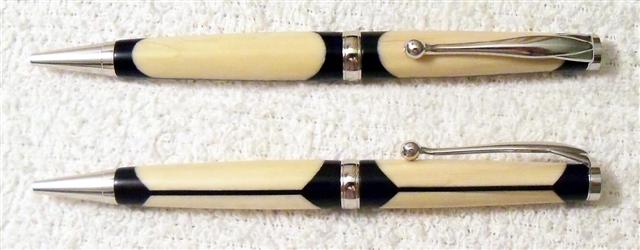

---- on a Rhodium Comfort Pen

Really nice composition and classy looking use of materials (and, of course, quality job on the fit and finish). Great looking pen.

---Thanks for the great comments,
gvansweerd --
Mammoth ivory turns pretty well (sharp tools) needs a good pre machining inspection for cracks, it also finishes well.
dgscott ---
mammoth ivory does have a lvely aroma when turning (burnt hair smell??)
larry ---

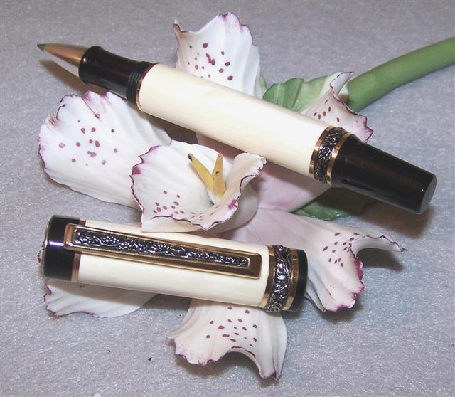

used the "comfort" so that I could utilize the available mammoth ivory
---attached is a picture of mammoth ivory on a "cambridge"

Great job of using the leftovers up-----helps keep the bottom line higher.
Plus it's truely one of a kind and would command a good price.

Now that's what I was thinking about. As a matter of fact, it was that exact kit. Your laminated design would hide that black stripe at the bottom of the cap barrel.

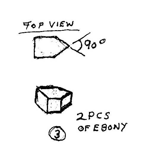

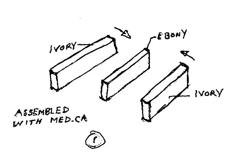

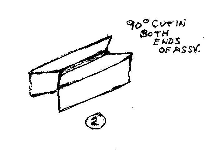

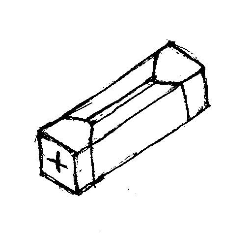

That is great looking-I really like it. I am curious what did the blank look before cutting?
Thanks,
Nick
Gulfcoast
Apr 24, 2004
264
Florida, USA.
nickff--
-- here are my crude (very) sketches of the blank and parts/assy's
Joe
