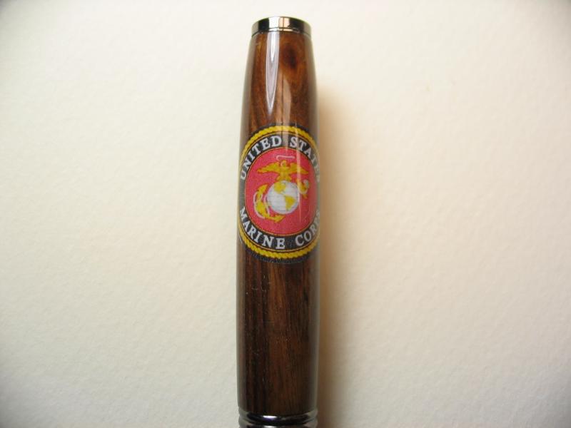

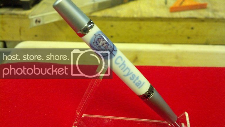

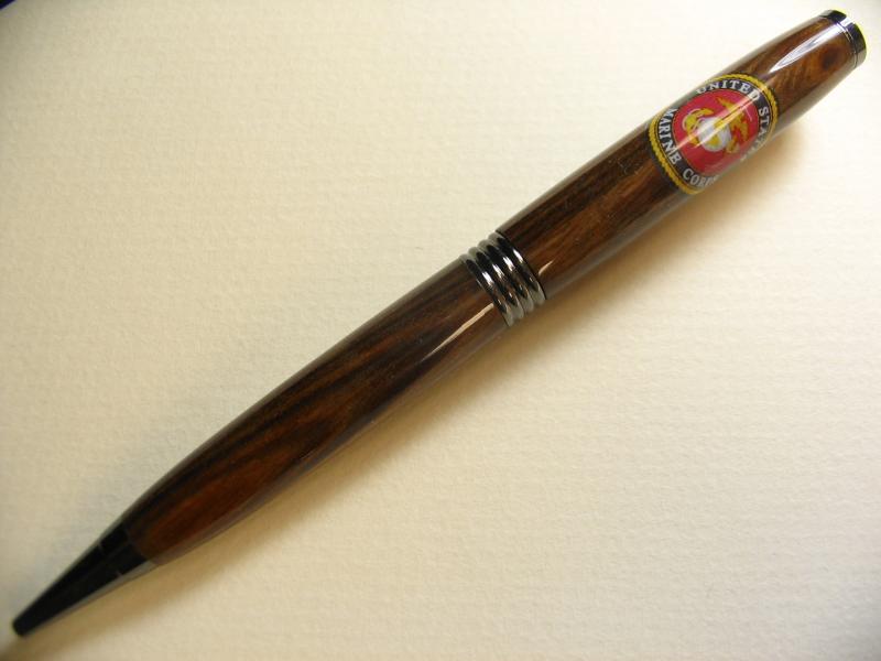

Decal Pen
Recent decal pen I made using inkjet printer, decal paper from the hobby shop, and Krylon Gloss spray. After decal was applied to the pen I top coated it with about 10 thin coats of CA and Micromesh. This decal was on a white backed paper versus clear so the white would show on the dark wood.
When using the paper I print the decals at the top of the paper and trim it off after printing. I apply the spray after trimming thereby saving the remainder of the sheet for printing more decals.
After punching out the circle decals from the sheet they require another shot of Krylon to seal the edges otherwise the water will affect the ink when removing it from the paper. You could also punch the decals and then apply the Krylon.
Hope the pics appear, I have only done this 2 times.
