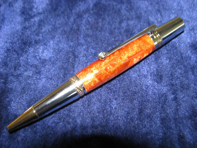

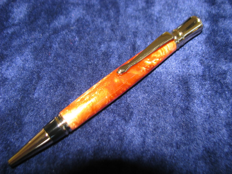

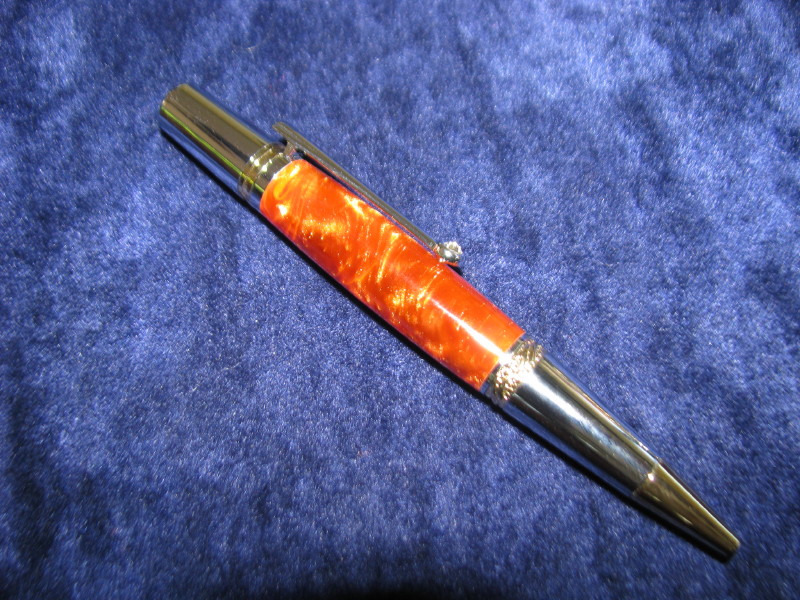

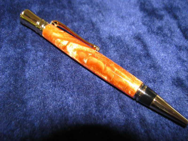

Here are a couple of my latest pens. The Majestic Squire and the PSI Executive. Both were made from Bronze & Gold Inlace Acrylester. No paint on the tubes.
