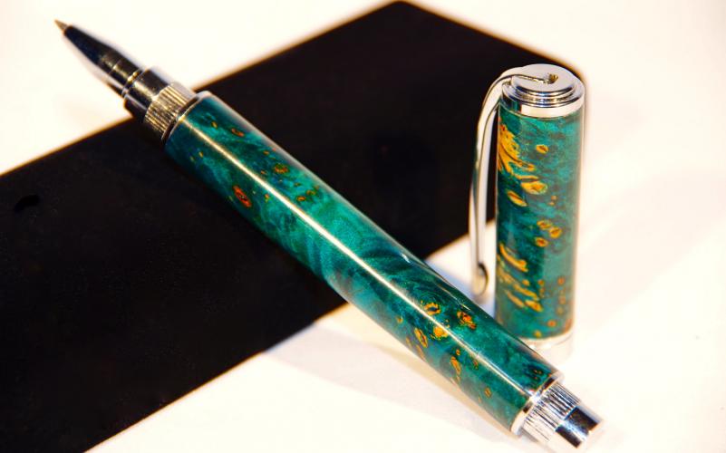

Edit: The photo link no longer works. I have uploaded a picture of the chrome rollerball version of this pen in blue maple burl. Thanks!
