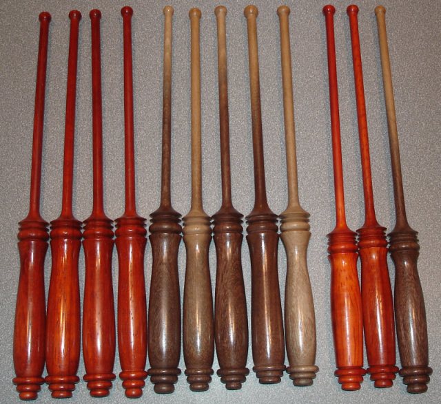

Just kidding. But these are what have kept me busy turning these last few days. This a replacement batch for a set that the post office helped to truly become magical - as in they disappeared.
These are on their way to Ken Nelson (Kallenshaan Woods) to be engraved with the phrase "Automagic".
The wands are Padauk and Walnut. They are approx 9"long, 1/2" diam (handle), and less than 1/4" diam (blade). They are intended to be corporate gifts from a former manager where I work. Her director was constantly dropping projects in her lap till it became a joke that she was expected to wave her magic wand. When she left the company, she wanted to give all of her co-workers a wand of their own :).
Fun to make the first few times, but after 32 of these, I hope I'm DONE.

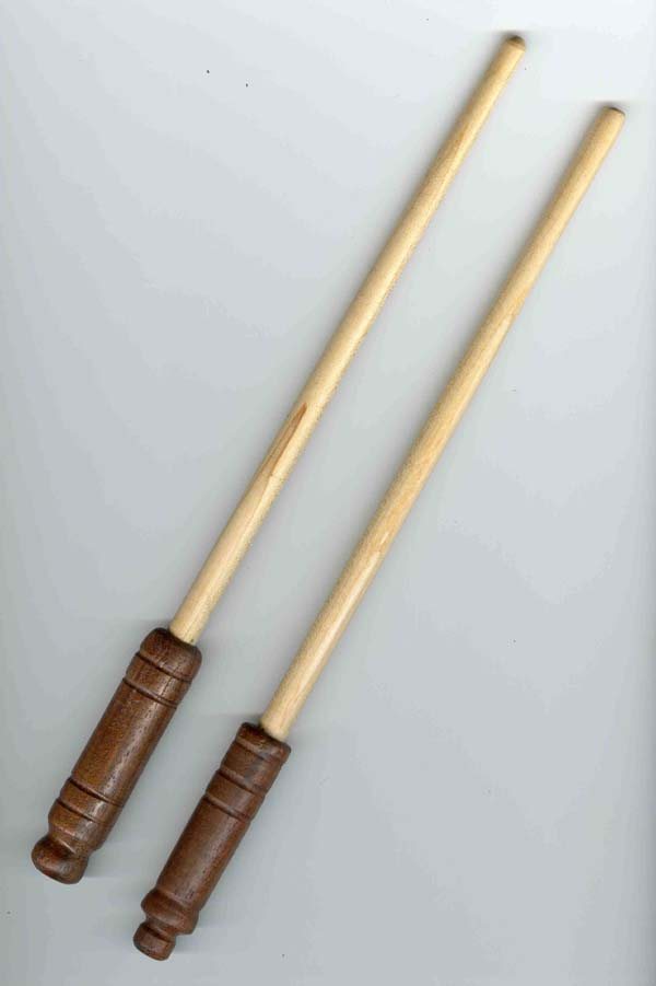

how does one get the long, thin wand end? If I tried something that thin on my lathe, I'd have toothpicks flying around my head[:(]

Thanks all,
Mikey, I cut the blanks at 3/4" square by 10" long. I put the headstock end in the #1 jaws of my chuck and bring the live center up to support the tailstock end.
I start cutting at the tailstock end so there is wood to support it at the headstock end. I get about an inch turned and rough sand it, then work on the next inch. As you move farther down, just take light cuts with a sharp tool. Trust me, I broke a few.
I do not part the tailstock end off until the whole wand is turned, sanded, and finished. I then finish turning the ball at the tip and part the last little bit off. There is still enough support at this point to part the headstock end.
Hope that helps.
