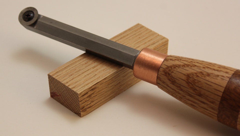

The Magical Skew presents the cutter at a 30 degree angle to the work.
It cuts it does not scrape.
The shape of the bar allows for repeatable angle placement.
On hard, soft or punky woods and plastics it does not tear the chips away it cuts, and it leaves a smooth skew like finish.
The magic comes in the 2 minute learning curve as opposed to a regular skew.

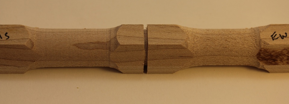

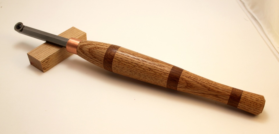

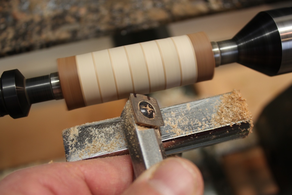

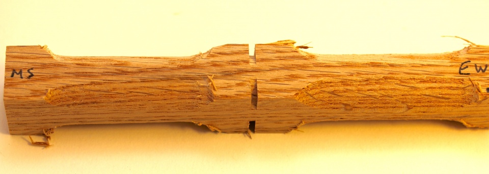

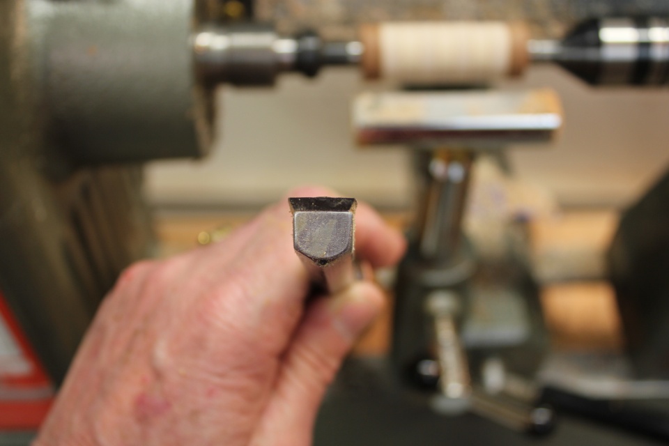

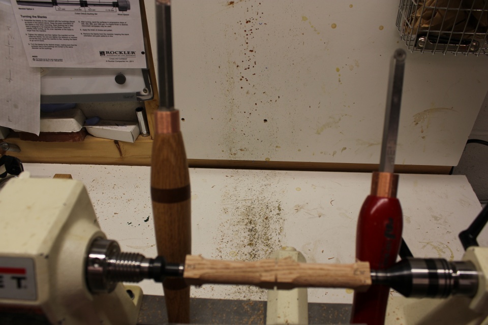

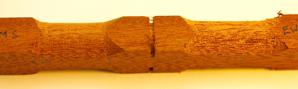

However - I did a "pre-production" test-drive on the Magical Skew earlier this year. I was very impressed with the MS.
Hank: The tool shaft is not square riding on it's point - it rides on a flat, with the shaft on an angle.
Some pics will help:
Some of the tool; some with comparisons between the Easy Wood Round; and of my tool. Note: Magicbob did not have handles at this time, and as Bruce has indicated, you may want to go with a longer handle; I believe mine is about 14".
The three blanks are: #1 - Cherry, # 2 - Walnut, # 3 Oak
The tight grained Cherry had a noticeable advantage for the Magical Skew; the Walnut and Oak, less so, but still a cleaner cut.
These are my opinions only. :smile:
