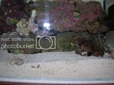

Here is a full-tank shot of the completed project, with fish and live corals all happy in wonderland.
Here's some pics of construction, how it turned out, and stuff I have in it.
Another full-tank shot. The light that is OFF is used to light some chaetomorphic algae (to remove waste) in the sump, it was turned off for the pic.

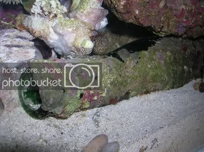

YES THAT IS A BEER BOTTLE in the bottom right corner!!!! It was sent to a local reefer by a buddy diving out on a reef, and the reefer traded it into a local reef aquarium shop. So, being a good Baptist, I had to buy it. It has nearly 1/4" of corraline encrustation on it. Who knows how long it's been sitting down in the ocean?
