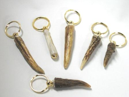

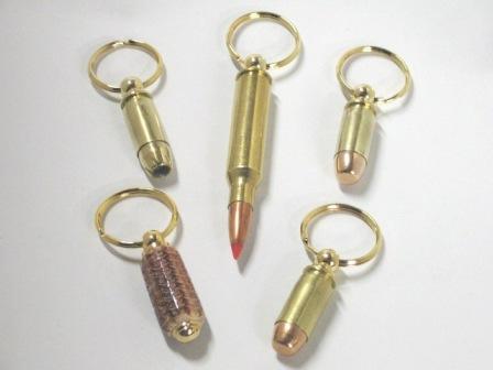

Great looking bunch of key rings..........Just sold 24 the other day. Here`s a couple of versions that sells very good for me. First group are of course bullets and the second bunch are deer antler.

W.Y.
Aug 10, 2008
1,656
BC, Canada
Real nice Perry.
Are you using a special kit for the ones with the antler tips or modifying the regular kit.
If modifying regular ones would you like to explain how ? .
I hate to think of all the antler tips I discarded because they were too thin for pens but could have been used like that.
W.Y.
papaturner
Apr 5, 2007
3,397
Buchanan,Georgia USA
William, I do indeed modify the regular kit. Very simple to do. I shorten the brass tube to the length needed for the hole drilled in the tip,glue in the tube then sand flush with the antler. Then I shape the antler to match the key ring part with a sander and press the part in the tube, then insert ring.
I find the toughest part is to press the key ring part in the tubed antler because the tip is not always straight, making it difficult to line up the part and the antler tip so that the plunger on the press pushes every thing straight in.
Hope this helps,but if you have questions please ask......I`ll certainly answer if I can.
